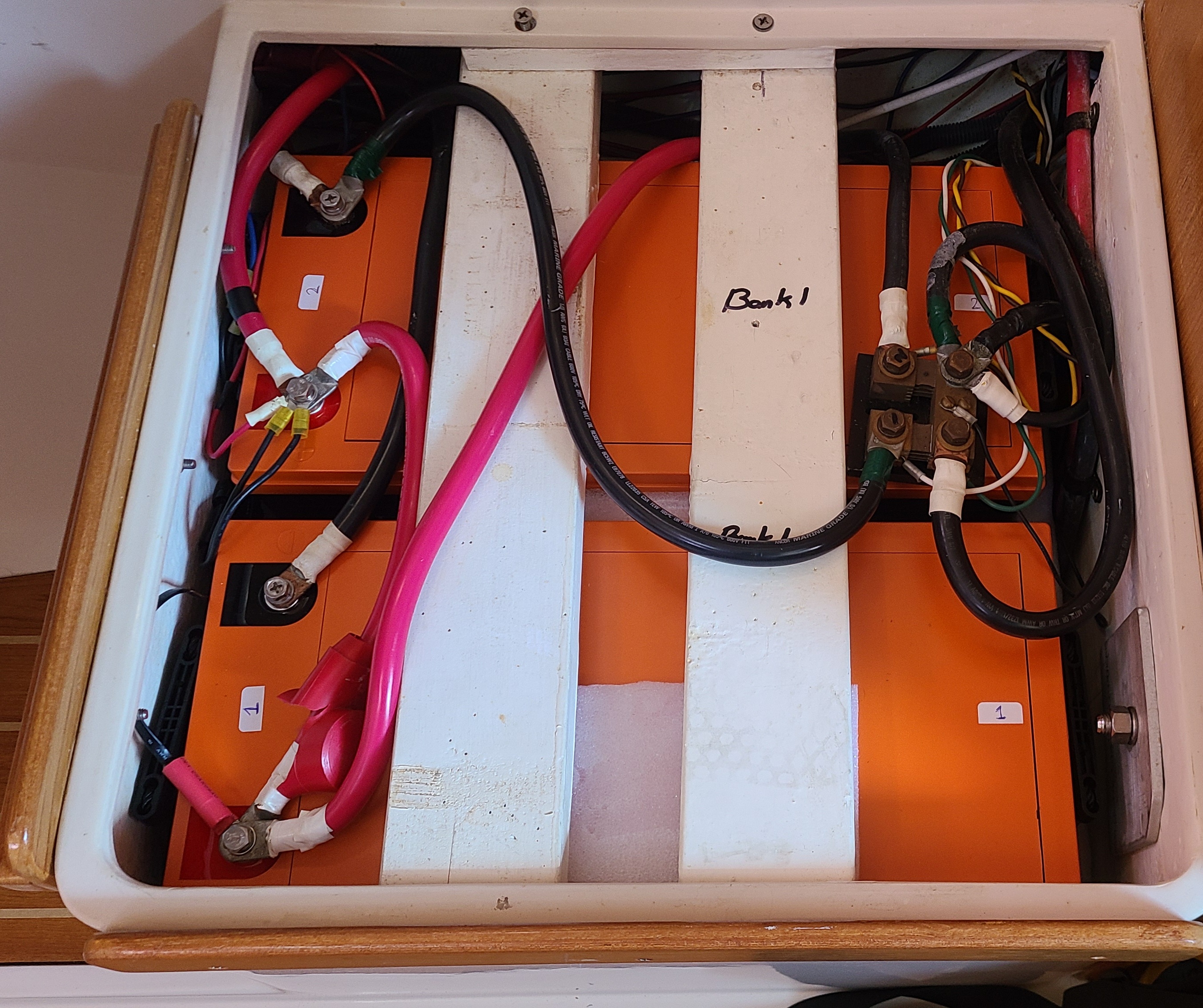

   I'm planning to replace the existing Inverter/Charger (control panel seems to lock up ever so often) with Victron 3000W Inverter/Charger with Cerbo GX and Display.  Any caution, tips, or suggestions?
  BTW, I already replace the 2 8D AGM house batteries and the starter batteries with LiFePO4 batteries.  The 2 house batteries was an easy replacement since the CHINS 200 Ah batteries (Amazon) fitted in like a glove (with old battery trays removed). The starter battery is also 200 Ah LiFePO4 but DIY Calb battery.  So far the charge profile for the old AGM batteries seem OK with the new LiFePO4. Although the LiFePO4 are not fully charged with the AGM settings but LiFePO4 are happy not fully topped off.
