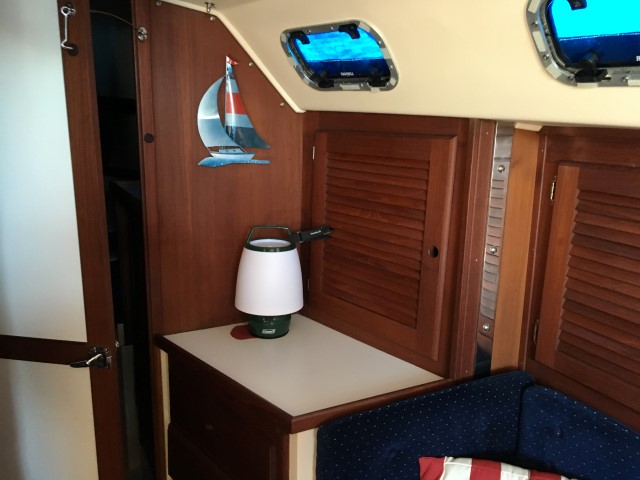

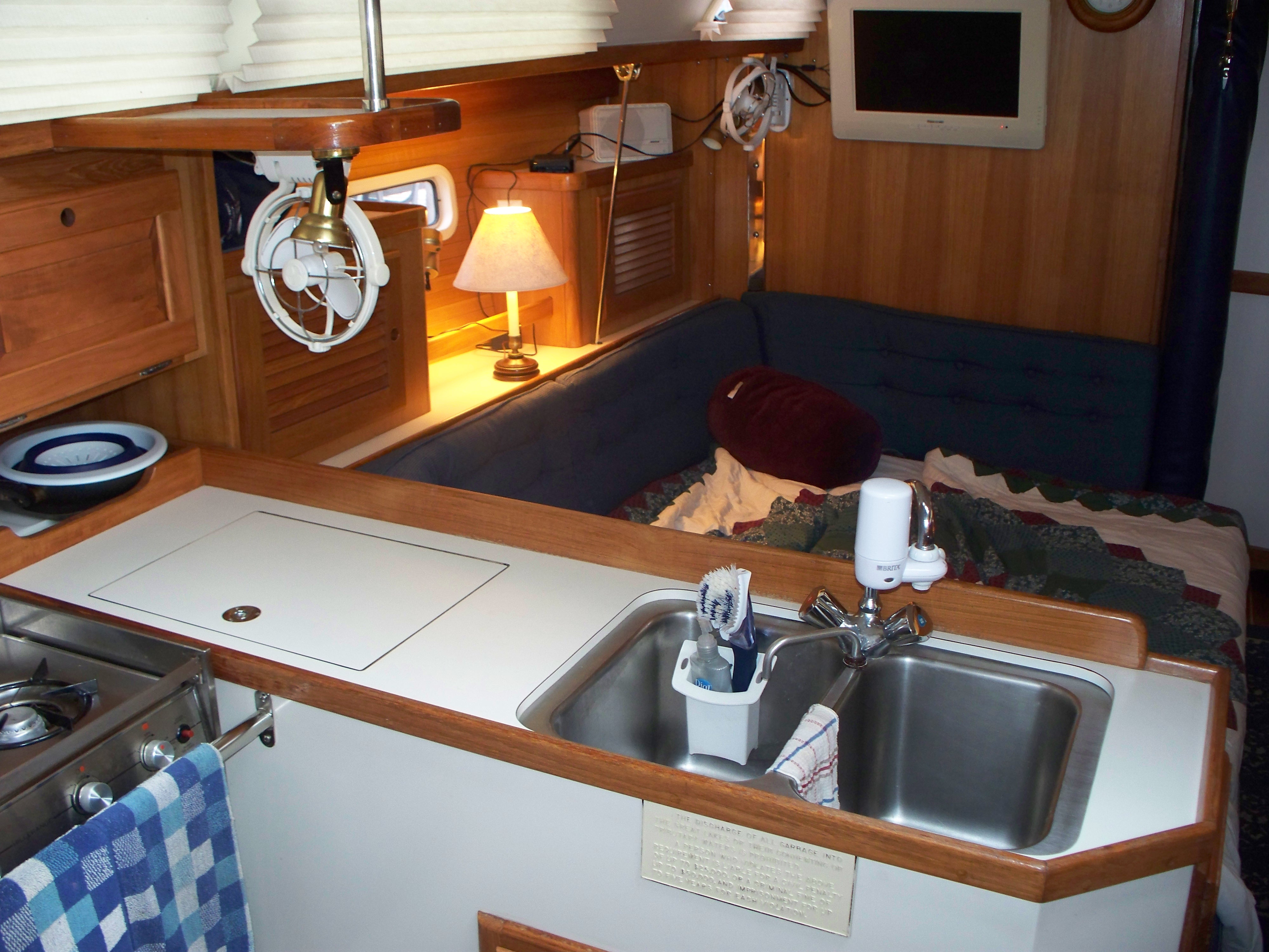

I use 120 volt (old bed stand) light fixtures with LED bulbs run by my AC inverter.
This provides a warm evening light that makes the boat feel like home. I have 2 lights  in the main salon and I use metal plates and rare earth magnets in the lamp base to hold the lights in place.

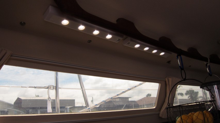

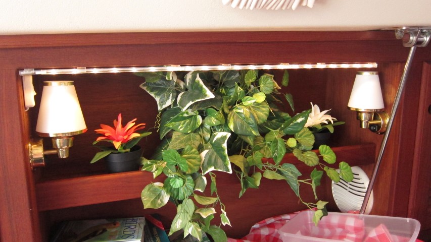

We took an entirely different approach for our lighting needs. Our boat is seldom in a marina and most of it's cruising life is spent on the hook away from battery charging facilities. Cruising in Florida is great but for some of our cruising season, the sun sets early leaving us to prepare dinner in the dark. Our lighting set up uses all LED in the existing Catalina fixtures with new fixtures used in the salon. In the salon, an LED strip light about 36"inches long runs the length of the book case on the top shelf on both the port and starboard side. These are 12 volt and operate at 2400K thus providing a nice warm light throughout the cabin. A 10 volt desk lamp from IKEA provides more than adaquate light for these old eyes while at the nav. desk.

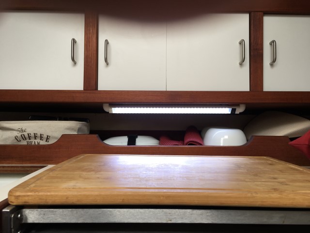

Over the sink and stove area where food is prepared was the area of genuine concern. Here sharp implements (knifes and other blades) are being used and to prepare food and, where in my mind, the greatest danger exists . ( Imagine having an deep cut  incident while you are on the hook ) Our remedy was to replace the Catalina florescent lamps with LED's but that was still not enough light in the needed areas. At Home Depot we found a temporary solution to hard wiring lighting in those areas above the sink and stove.
General Electric makes battery operated  LED 'closet' lights that supply an amazing amount of light.  They come in 2, 4, 8, LED units. We use  two light strips over the stove and two lights over the sink.True they are powered by AA cells and usually get two seasons from a set of batteries.
These little battery operated closet lights come in handy in other places too like the fridge and the food storage locker.
