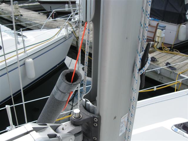

Bob,
Attached are some photos I found on another website. This is the same process I used which Tom describes.
I did it for several years, works great.
Stone
