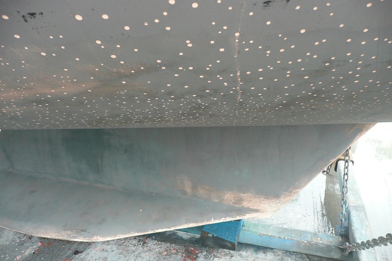

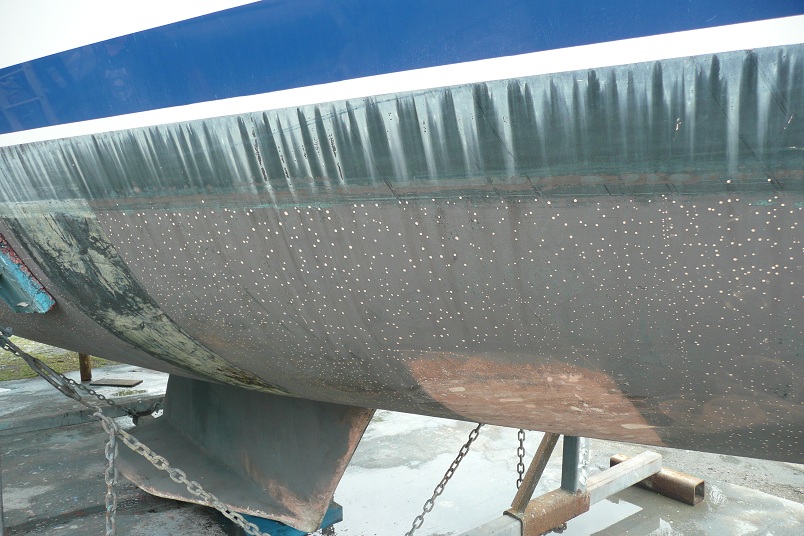

Just got news about an issue with the hull on the 375. This boat was antifouled by the Catalina dealer, as part of the delivery 12 months ago.
It was slipped recently and we were surprised at what we was revealed when the vessel was water blasted . I discussed the problem with Greg from Marine Painting and Mark from MP Marine who is a shipwright and they both agreed that the likely cause is
· Primer was not dry when the anti –foul was applied
· Possibly primer was not mixedproperly
· Maybe was rain affected
The solution is to sandblast the bottom and reapply primer and antifoul.
Anybody have anything they can add?

To me it looks like they just put a very thin layer of antifoul on that boat, maybe 1 coat thinned out to make a gallon cover everything. It wears off first on the leading edges like the bow and front of the keel. 12 months is half of the life I get from my bottom paint, but I do two full coats plus a third coat on the leading edges.
The little dots are a bit of a concern though. Are they raised blisters or are they just holes in the paint?
Jason V

The little holes are not blisters, they are holes in the antifoul.
Sandblasting using something soft would be the way to go.
Its just another stuff up by the Australian Catalina dealer.
Catalina make great boats, but I am still struggling to find somebody that can say a good word about the local dealer, or his technical people.....
But don't get me started on this topic :)
