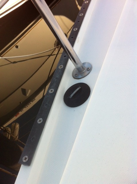

Someday soon, I have to repair the fiberglass under this jib/spinnaker track. I'm trying to imagine how to remove the track. (See pic). It is thru-bolted, but I can't think of a way to get a socket wrench on the nuts beneath. No way to access them.
Thoughts?

Have you've tried this on these particular bolts? Reason I ask is because I can't even see how to get way up in there to even get a pair of vise grips on them. I don't see any way to access many of them. Do you have a way?

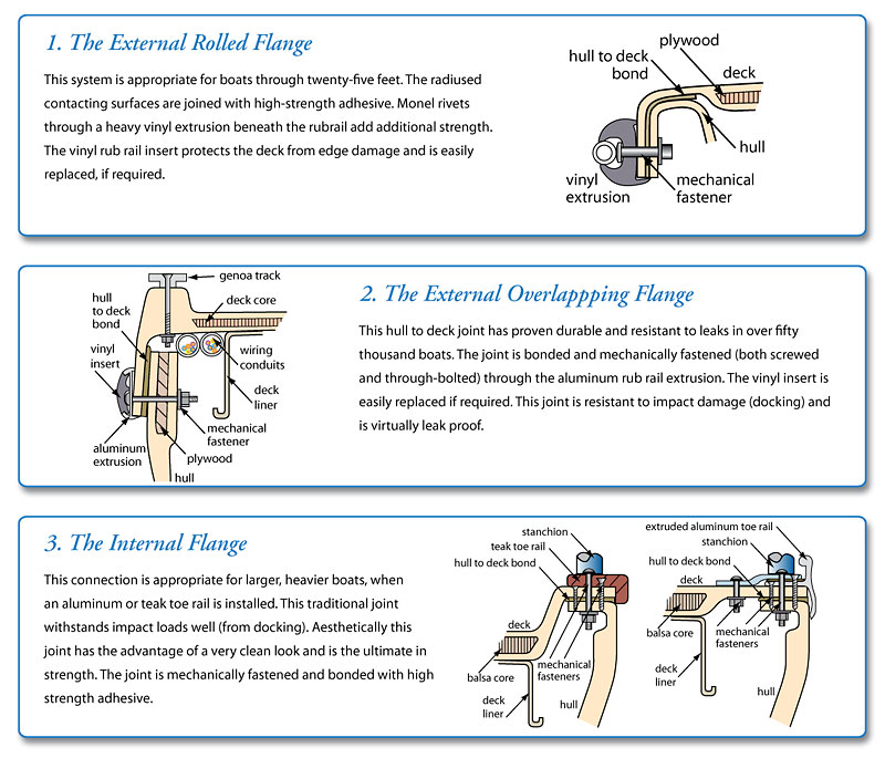

Take a look at this - maybe it will help. It's from a Catalina brochure I found online. The C36 would have the middle construction.

On my boat I can get access to 95% of them with vice grips - they are up behind a little flange of fiberglass with a teak trim strip screwed to the front of it.

Or maybe this, from a 1994 brochure, I think.
[url]http://bradcrabtree.com/Site/brochures/catalina_past/36-2.pdf[/url]
