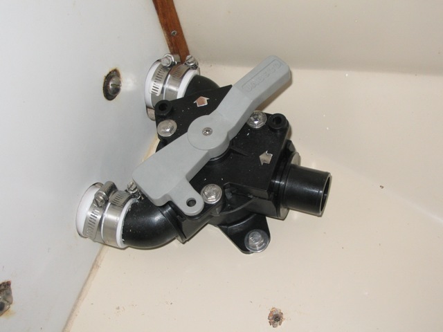

PS - If you are replacing the diverter valve, feel free to check out the one I installed. It is a thing of beauty and located behind the head so you don't have to dig under the cushions to get to it or check it for leaks. Feel free to message me if you'd like more info. Or at [email]Homewest@socal.rr.com[/email] .
