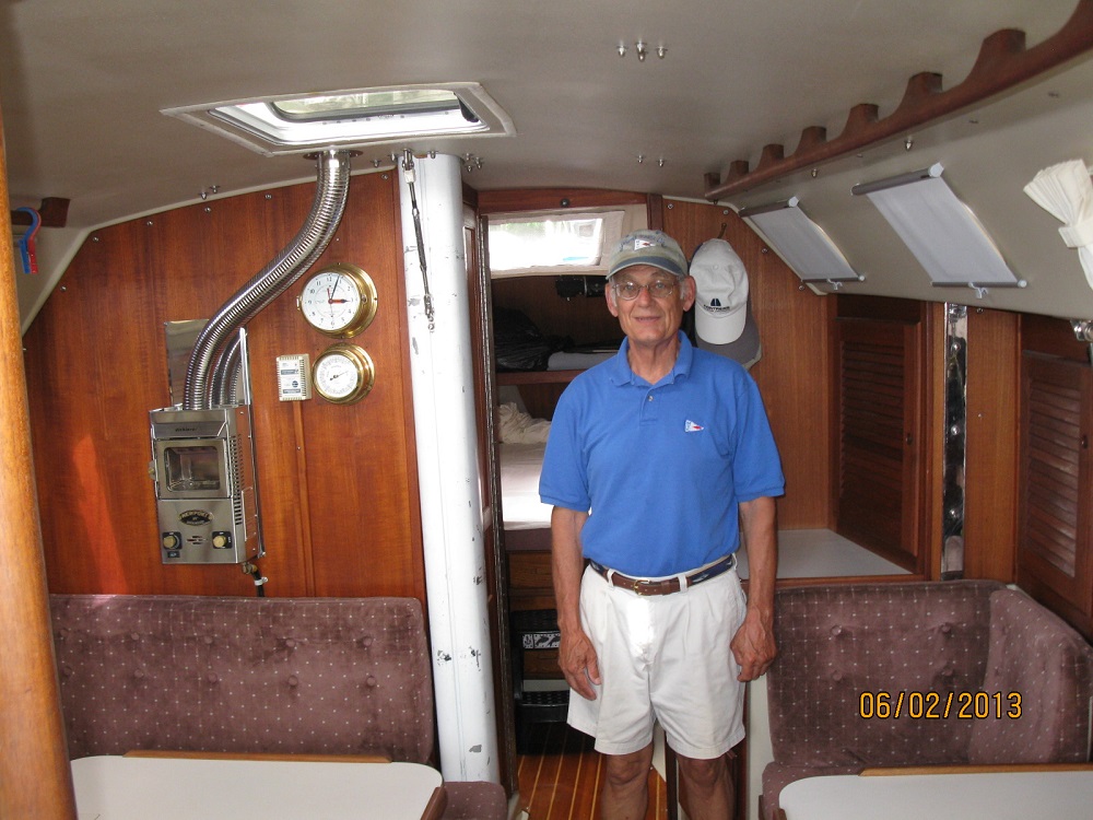

With propane already in use for the galley, we installed a Dickinson "Newport" propane cabin heater on the forward main cabin bulkhead, right next to the CO detector. It draws in outside air for combustion and vents exhaust gas through a two-way SS flex vent to the cabin roof, so no water vapor issues. It has a built-in fan to circulate heated air. The flame is visible for a pleasant fireplace effect. It seems to be quite efficient in both amp draw for the fan and propane use, and installation is simple. We find our 7500btu version can keep up with spring and fall weather provided we close off the aft cabin or the V-berth. There is a 9700btu size as well as a diesel version and a solid fuel heater. Among others, Hamilton Marine (hamiltonmarine.com) in Maine carries Dickinson.
Undine, what dinette layout do you have? Can you post a picture?
Undine's picture
Undine
Joined: 3/12/11
Posts: 12
Here is a photo of the Dickinson heater in the main cabin, with a visitor included for scale because I am not sure how to crop the photo. The duct requires a 3" hole. The deck vent/air intake is SS, about 6" high. Our rigging is all run to the cockpit, so it is not an obstacle underfoot near the mast.
I have an "Ardic" force-air diesel heater; as well as a "Heatercraft" forced-air heater which runs off the engine hot water system. That way I can have a warm cabin before we shut-off the engine at anchorage and then fire up the diesel heater to maintain the temp.
