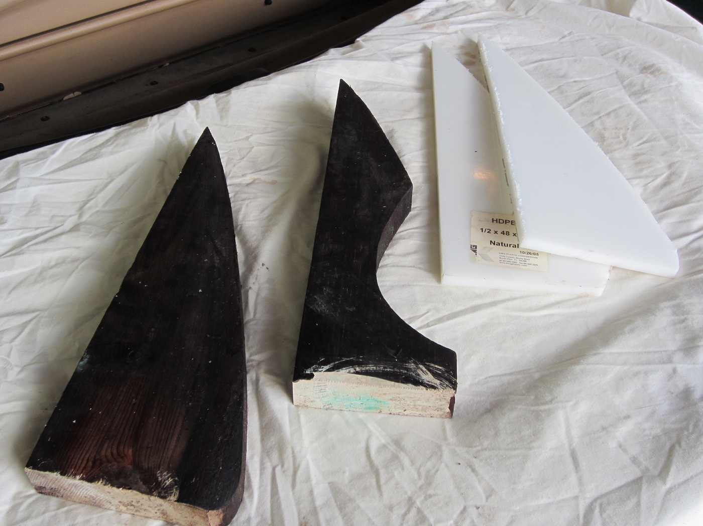

I have already taken photos of the project so far and will make a brief article.
I decided to replace the rotted (acid fume weakened?) wood with UHMW polyethylene that I had left over. I screwed 2 pieces together to get a 1 inch thick structure and rough cut it with a jigsaw, then used a belt sander to match the profile of the rotted wood. I had just enough 1/2 inch poly left to form the base.
I don't have too many available work hours between now and Sun night, so I will have to jury-rig one bank of batteries in place until I complete the work next weekend. We have a sunset sail planned for a good group of folks so I need to make it workable temporarily.

Here are some prelim photos:
Old damaged wood with polethylene replacements.
new supports in place with 3M 5200 and screws from inboard surface of settee.
Poly base on supports before securing.

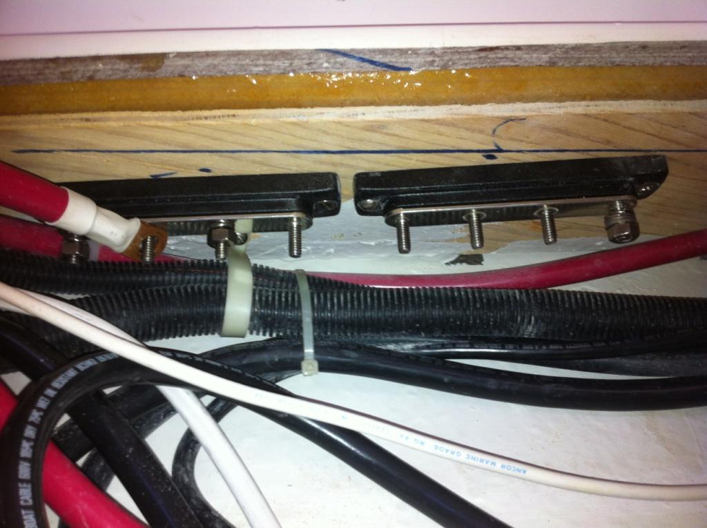

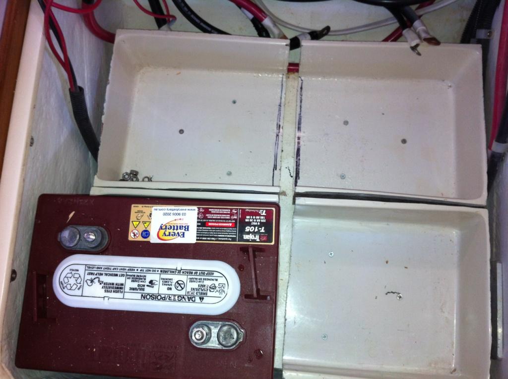

I know there has been a lot written about replacing the 4D's with Trojan T105's so to add to the last few posts here's my installation with a couple of photos for those unsure of the details.
As noted, the 2xT105s are about an inch longer than a single 4D. As has been stated, you need to cut the battery box in half and fibreglass another inch in the middle.
On my Mk11 the boxes were quite substantial and I cut them on a table saw with a tungsten blade. As shown in the picture I also trimmed the end edges of the boxes to make an easy fit in the battery compartment.
I actually joined the two halves with some thick plastic sheet and sealed it with silastic. Not very professional but quick and more than adequate. The T105s are about 1.5 inches narrower than the 4D so you can either cut the boxes a second time lenghtways to make them narrower or simply pack the batteries in the wider boxes with some trimmed down timber - which I have done - they are very secure.
I agree with Tom - using the original boxes is easy but fiddly but I think Buds approach is probably the best way to go and make new boxes from scratch.
Not shown is the tie-down arrangement. I used two lengths of half-inch reinforce steel rod sheethed in plastic tube which lays on top of the batteries and is bolted at each end to the bottom of the seat rail with 3/16 inch stainless screws. These essentially replace the two large 4x2 wood restraints.
I also added a Victron Battery Monitor so I installed two bus bars and the shunt directly under the small storage compartment above the game table seat. The second pic shows the busbars bolted to the underside of the compartment.
The last pic shows the final install with new cables. I followed to the letter the excellent advise given by Rod Collins - MaineSail regarding connections, balancing and setting up the Victron. I turned one of the batteries around to minimise cable length.
I got about 8 years out of the original Exides with very careful battery management - expect to get about the same with the Trojans. I weep when I hear the price you guys pay for batteries in the US - Downunder the T105s are $195 each!!
After all that it was a fiddly job but very satisfied with the end result.

[QUOTE=deising;17070]Here are some prelim photos:
Poly base on supports before securing.[/QUOTE]
Duane,
I saw your article on the site and it pretty much is how I handled things around 6 years ago. I did not finish trying to hold the batteries down so I looked carefully at your solution. It looks like you have aluminum pieces running very closely along side the terminals. Since aluminum is a very good conductor, that would give me the willies. Am I looking at things wrong or are you tempting a huge meltdown if the batteries shift a little?

How difficult is it to remove the original boxes on the
MKII?
What is the best procedure?
Is height a problem under the seat with the golf cart batteries?
Wally
"Onanne"
​Lake Champlain
Mine were "held" in with 2 screws each, but since the screw heads had corroded and the wood shelf below was rotted, they were not held in at all, really. Procedure? Take out the batteries and it will be obvious how the boxes come out.
The Trojan T-105 batteries are a lot closer to the top of the enclosure than the previous 4Ds, but there is still adequate clearance. you won't have room to mount anything above the batteries, though.
Wally-1840
Joined: 11/9/09
[QUOTE=deising;17996]Mine were "held" in with 2 screws each, but since the screw heads had corroded and the wood shelf below was rotted, they were not held in at all, really. Procedure? Take out the batteries and it will be obvious how the boxes come out.
The Trojan T-105 batteries are a lot closer to the top of the enclosure than the previous 4Ds, but there is still adequate clearance. you won't have room to mount anything above the batteries, though.[/QUOTE]
Not even room for the cables? I have jumpers and my new 2/0 cables for my power winches coming up and across the top of the batteries to the terminals.
I thought the boxes were installed with some kind of adhesive, (maybe 5200?), and were a real bear to get out.
Wally
"Onanne"
​Lake Champlain
Sorry, Wally, for that confusing statement.
Since the cables are generally not much higher than the terminal posts, YES, the cables will fit. You won't have a lot of room above the cables, however.
In my case, I mounted my battery monitor shunt outboard of the batteries in the only space available. With my previous 4Ds, there was room to mount the shunt above them.
Wally-1840
Joined: 11/9/09
Thanks Duane! My shunt is off to the outside already.
Wally
Wally
"Onanne"
​Lake Champlain
What Duane said about the boxes, 2 screws, lift them out. There are several different heights for 6V batteries, higher capacity batteries are taller and I don't believe they will clear the seat base. But due to manufacturing tolerances you should check your clearance on your boat. 6Vs in the low to mid 200 amp range should fit though.

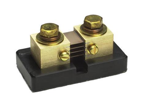

What's a battery SHUNT?
Mike, in order to measure the current flowing in/out of the battery bank, it is common to use a precision resistor in the form of copper plates tied together in parallel and called a shunt. They are calibrated so that if the battery monitor measures a certain voltage drop across the shunt, it can display the current in amps pretty accurately. The voltage drop is miniscule and does not affect performance.
caprice 1050
Joined: 7/1/07
Posts: 345
Duane, is that the same thing as a voltage meter?
Mike, a voltage meter is part of the package, but it is designed to accurately measure very small voltage drops across the shunt, like 0.001V (1 millivolt).
If you take a handheld voltmeter to your battery bank, you can measure the voltage at the battery, but you can't measure current flow unless you have a shunt.
tgrover's picture
tgrover
Joined: 1/5/08
Posts: 131
An ammeter is basically a voltmeter calibrated to display amps. In order to do this, it requires a shunt which is a precisely calibrated resister. From OHM's Law, E=IR where E is the potential difference (voltage), I is the current and R is the resistance. By putting the shunt in series with the battery and making it the last connection to the battery (negative shunt), you can measure the voltage drop across the shunt to calculate or display current flow.
Shunts are generally rated by maximum current and voltage drop at that maximum current. For instance the most common shunt has a 500 amp, 50 millivolt (0.050 volts) rating. You can calculate the resistance of the shunt from this information. From OHM's Law E=IR you get R=E/I, 0.050/500 = 0.0001 ohms resistance for the shunt. This resistance is extremely accurate at roughly 0.01% accuracy.
So... if your electrical load draws 50 amps through the 0.0001 ohm shunt, you get a 0.005 volt or a 5 millivolt drop across the shunt. When a meter is connected across the shunt (to either side of the shunt) and that meter displays full scale deflection with 50 millivolts applied, the reading is 10% of the total. If the meter is calibrated to 500 amps at full scale deflection, the current draw displayed will be 50 amps.
Hope this helps explain the difference between a voltmeter and an ammeter and the function of a shunt.
