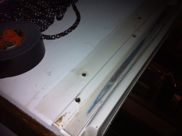

However, just putting it on the guides did not solve my problem. In my case the back edge of the hatch (perpendicular to the guides) was scraping across the cabin roof. See attached picture for my eventual solution. I had to remove the cover under which that hatch slides. About a 30 minute project once I actually figured out the problem. Hope this helps.

Jeff, Thank you, I think that is what I'm looking at. Must be an issue with the 87's!

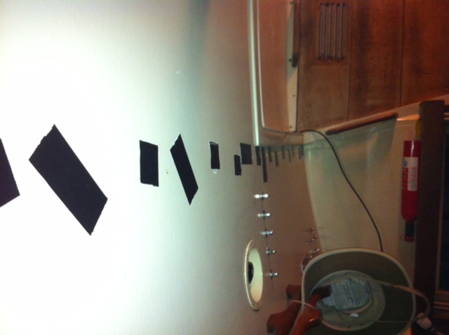

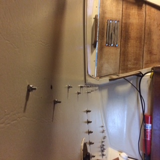

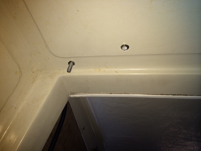

Reading my forum post over again, I think some of my pics were too large to attach to the forum but after a year or so, this is still working great for me.  No squeaks, no more fiberglass being ground away by dirt, teflon is replaceable when it finally wears out and my hatch is so much stronger in a knockdown/rollover:
https://www.catalina36.org/forum/general-discussion/companionway-hatch-squeeking-horribly
I added some pics below.  You can see the plastic buffer strip.  It is coated with the sticky teflon tape.  Way forward in the cabin hatch cover, I glued in a starboard (plastic) block so that if I ever have to slide out the plastic strip to replace the teflon, I can slide it back in without having to unscrew the whole cabin hatch cover again (which would be a huge PITA).
The other pics show the new thru-bolt holes in the cabin hatch cover and the deck. The last pic shows the (pretty much) finished thru-bolts.  Just need to grind off the extra threading for cabin safety. (Easier said than done.)
Be sure to rout/epoxy them per MaineSail's article on that subject, so you don't get water leaks into your deck core!
I think that now even a rollover and/or negative wave pressure would not lift off the sliding hatch cover.  Seems much safer and seaworthy to me.
