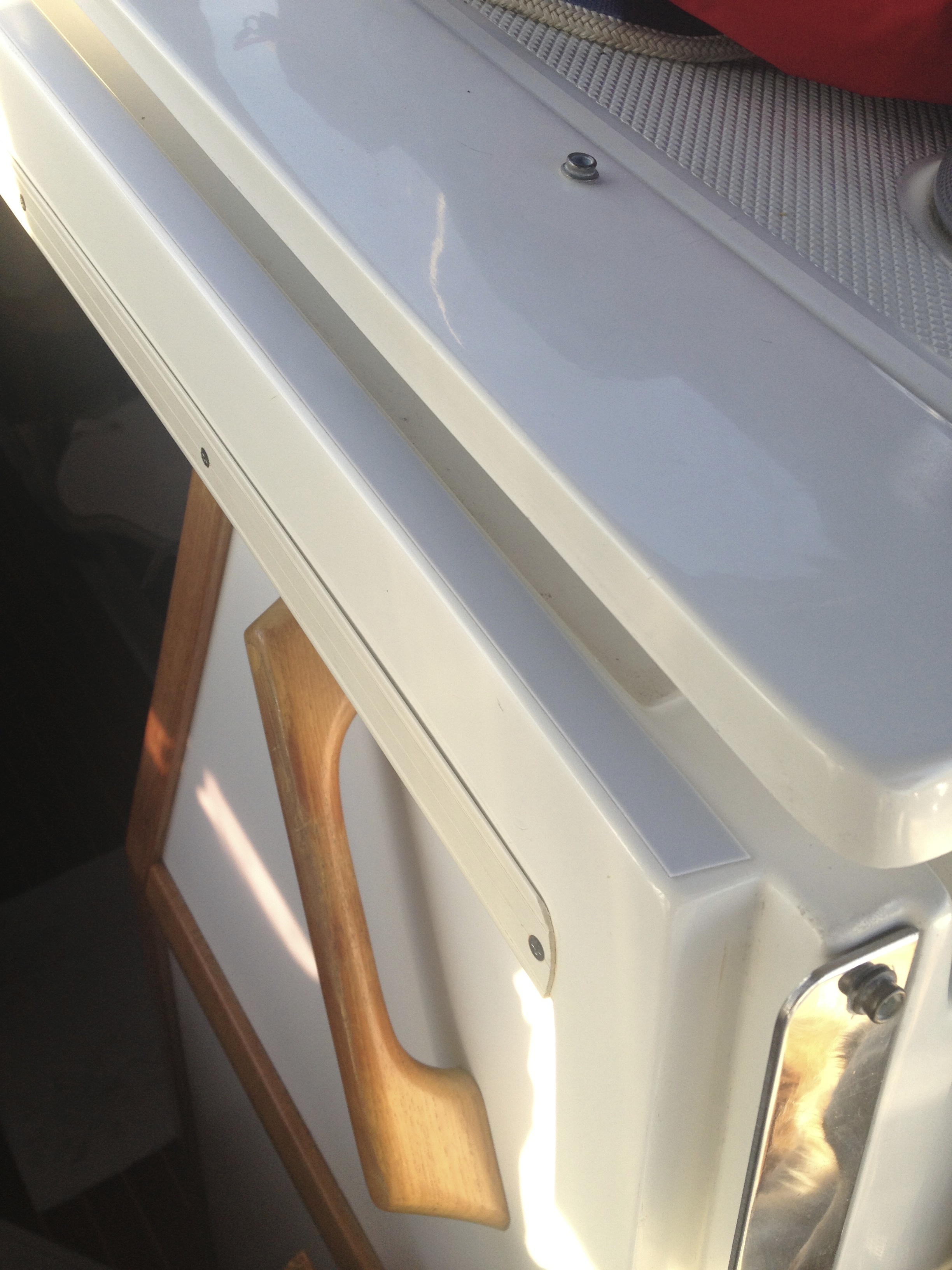

When we bought Tehani last year, we also had the squeak. The original thin, apparently Teflon®, tape was peeling off.
I cleaned off all the old tape and adhesive and applied Fat PTFE tape. Specifically, I used 3/4-inch wide by 30 mil thick tape from CS Hyde. It's listed as Item # 15-30A-.75-5. A 5-yard roll is currently $36.12 (plus shipping) online at http://catalog.cshyde.com/item/tapes-with-psa/fat-ptfe-tape/fat-ptfe-15-...(link is external)?. Other widths and thicknesses are available, but this worked great. It's self-adhesive and very easy to apply. Photo of finished job attached.
I recommend this to all. It's been on for 1 1/2 seasons now and looks like the day it was applied. And no squeak!
