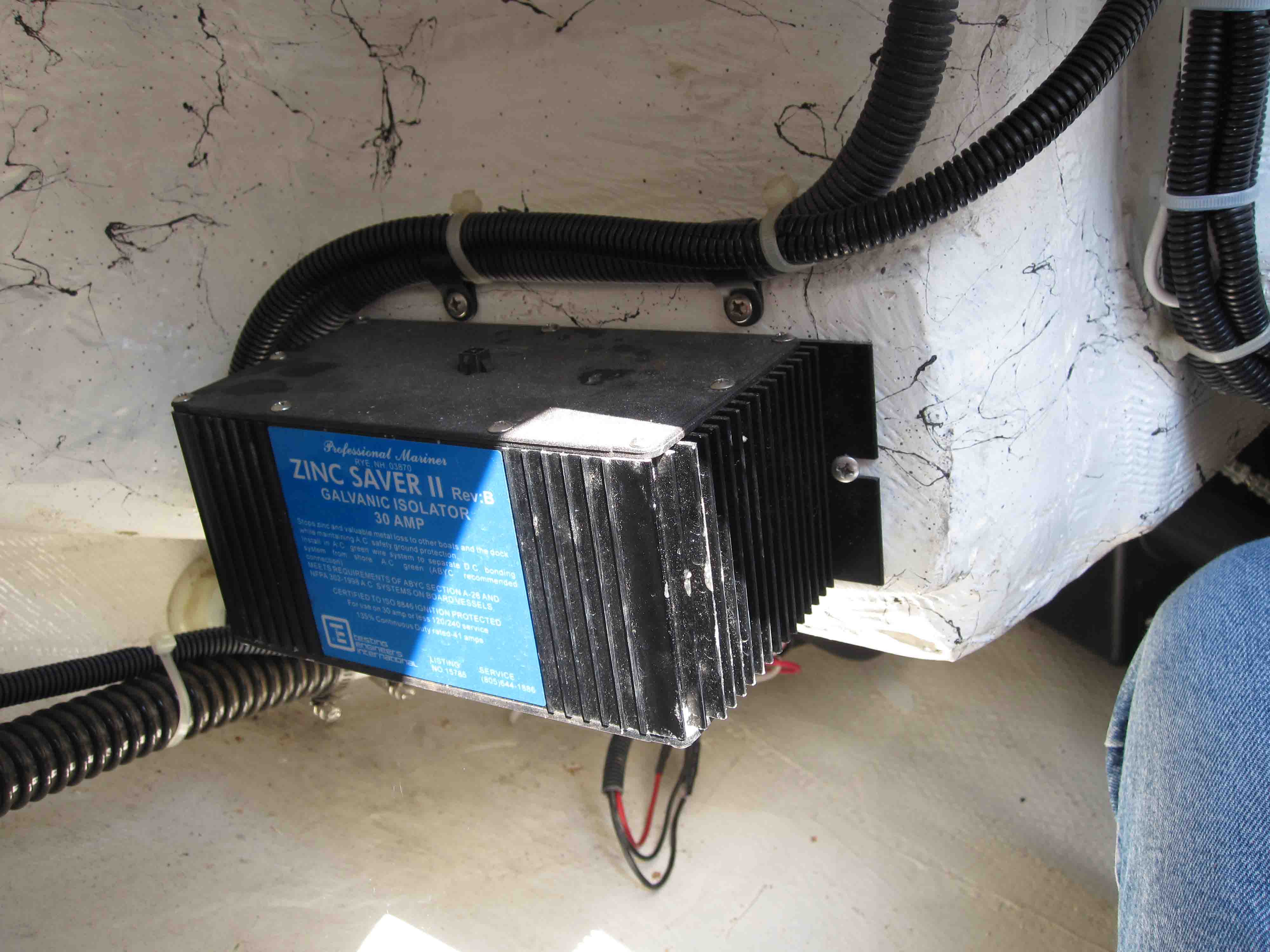

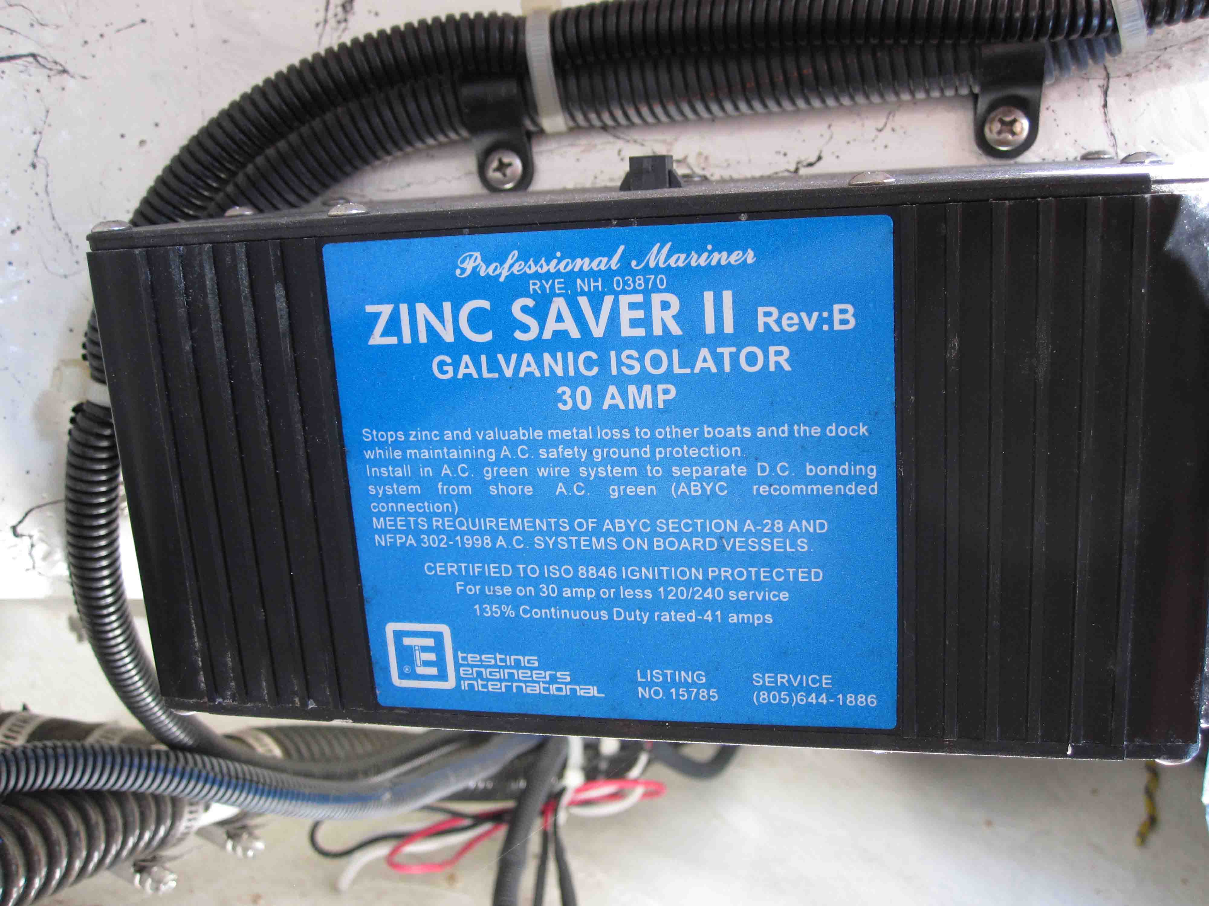

Starboard lazarette. Here is what it looks like.
