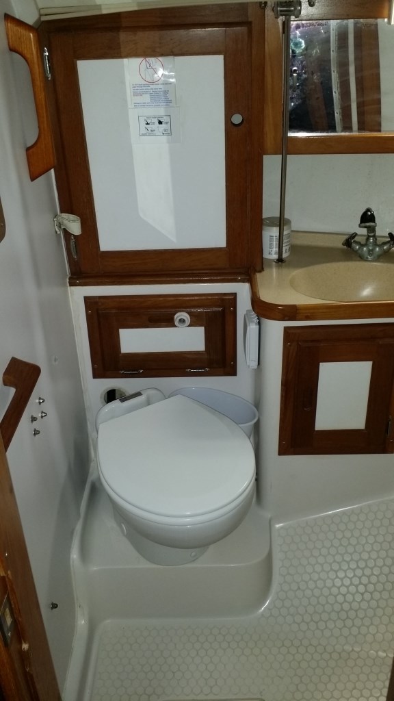

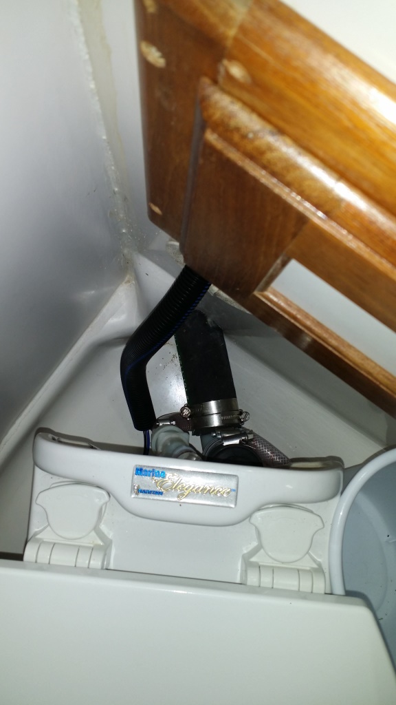

We installed the Marine Elegance a few months ago and like it a lot!  We installed the Household bowl size, angled back, standard height, fresh water, with the Smart Control up on the cabinet door.  We put it in at an angle as we felt that our right leg was a little crowed by the bulkhead wall.  It would have easily went in straight as normal and worked.
