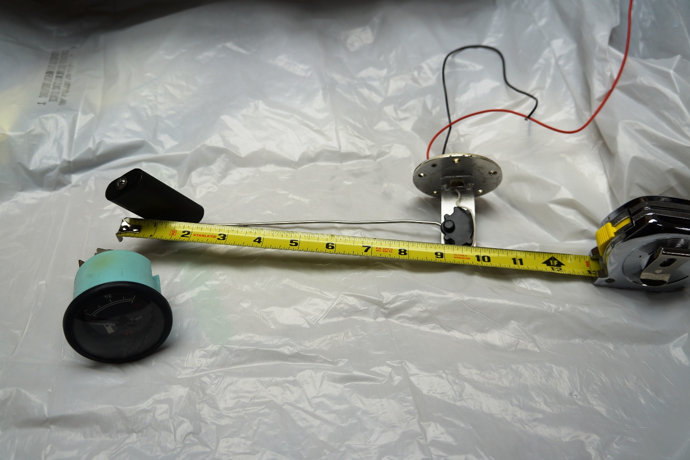

Hello all.  Looking to validate something on my 1995 c36 mk ii, hull 1433. I've read some articles on the sending unit. I have a aluminum tank. I have noticed the access port for the fuel shut off valve, but never noticed one for the sending unit. If I have to cut a hole and install an access port, what would be a good size to get?  Also, where would the sending unit be. mounted?
Also, want to validate the tank size if I need a new sending unit.  The sending units on catalina direct shows one for a 25 gal and another for a 19 gal tank. Everything I have read says it's a 22 gal tank.
My gauge has been having problems. First, the gauge went far left when the tank is full. Once it dropped to about 3/4, it would read correctly. Now it's not reading any fuel level. When I turn the key on, the gauge moves far left. When I turn the key off, the gauge relaxes back to its resting position, a few mm to the right of "e". So I can actually see the gauge ping hard left when I turn the key on.

My fuel gauge has stopped working, too.  I went through the troubleshooting procedures and determined that the sending unit is bad.  Like your boat (ours are only a few hull numbers apart) mine only has the one access port for the fuel shutoff.  It's a standard 4" Beckson screw out deck plate.
I bought a second one and plan to install it over the sending unit.  Requires a 4.5" cut-out which I plan on doing with a hole saw - very carefully!

I recently located that problem. It is the sending unit. On mine you can remove the sending unit by removing 5 screws from the top of the fuel tank. It had loose connections inside. You can replace this unit for about $ 30.00. Defender has it  see link below.
http://search.defender.com/?expression=fuel%20sending%20unit&s=1
There are several lengths - on my tank it was 12" arm.
