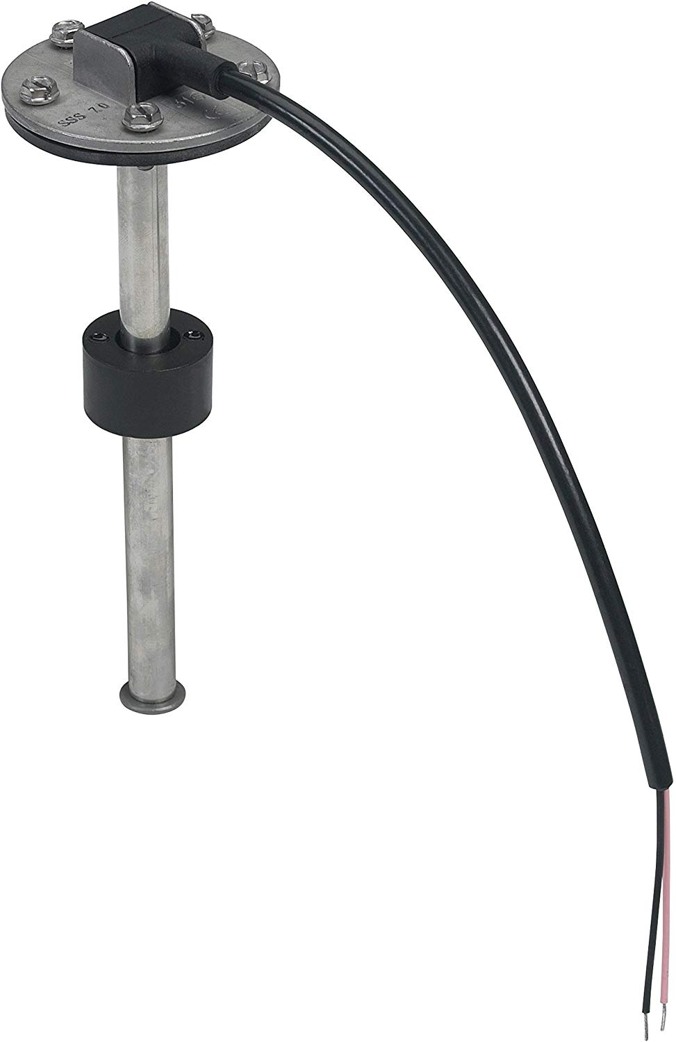

I had similar problem - but mine was the sending unit. I replaced with the type that has a sliding donut.
The screw pattern matches and the impedence is correct 240 ohms. It includes the gasket.
