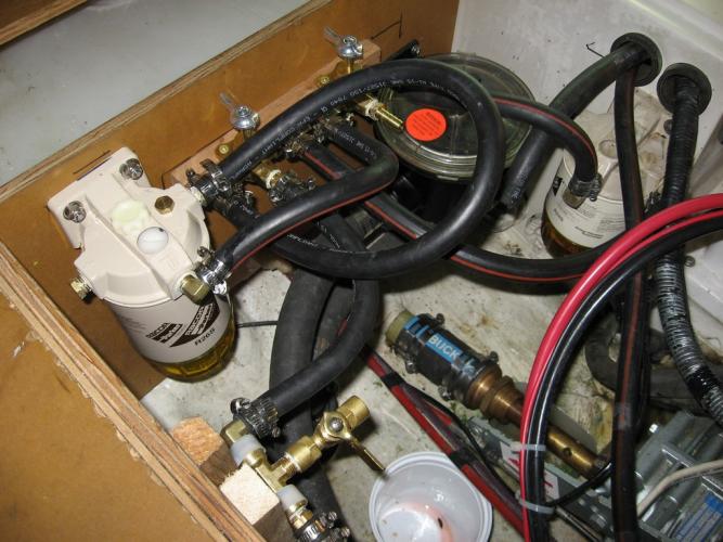

I added a 2nd Racor with two valves to switch back and forth. Fair bit of fuel hose needed and it does cut down access to the stuffing box but it's doable. The secondary filter won't be 2 micron, they are usually 10 micron. At least the specs that are published for any of them that bother to publish specs say 10 micron. Which is why, despite all the knowledge to the contrary, I continue to use 2 micron Racors. Here's a photo of the almost finished product, not quite totally plumbed. The shutoff valve sticking out from the wall was a placeholder for a vacuum gauge, which lives there now and is very handy for monitoring your fuel filters.
