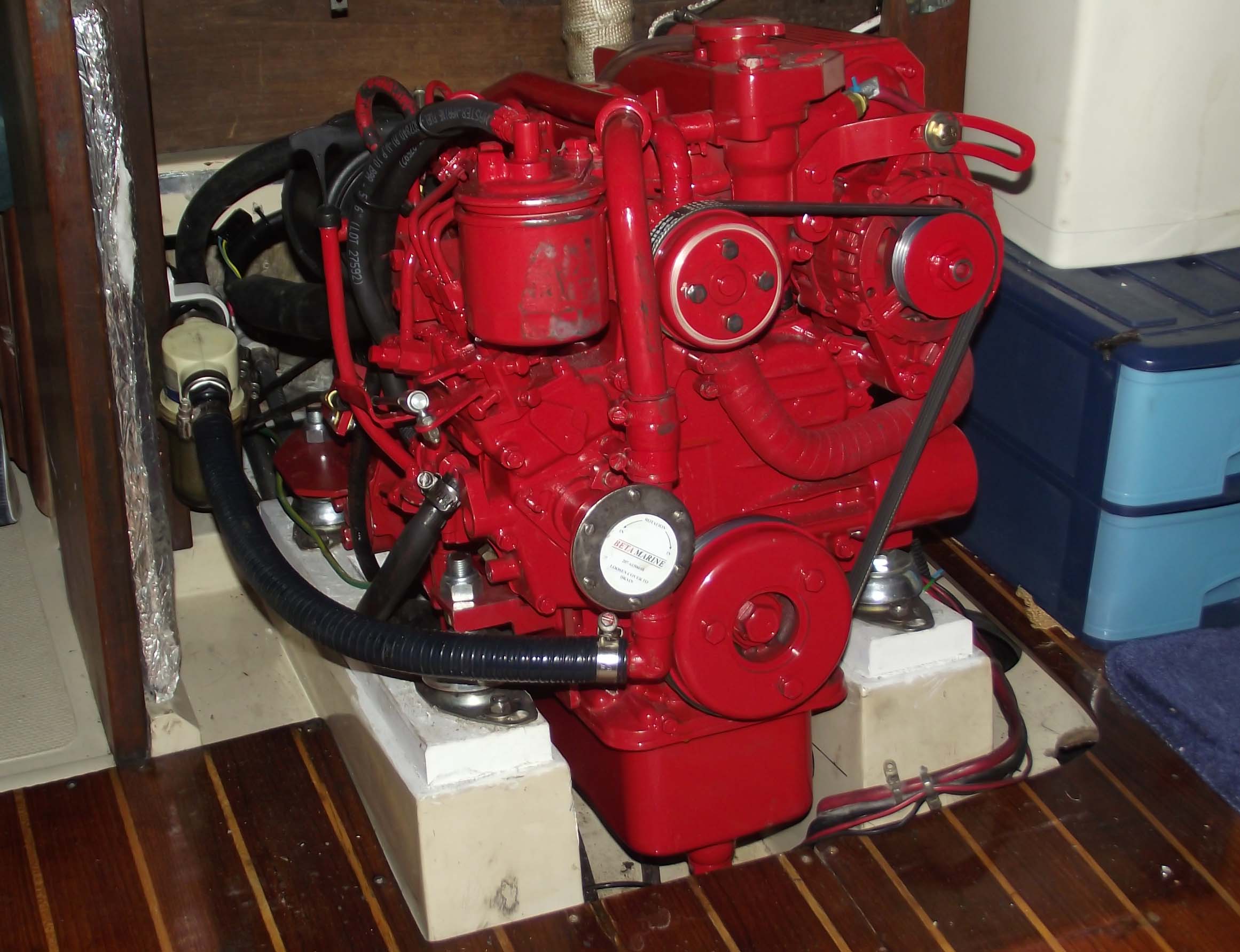

We had a Universal 23HP that had done 5000 hard sea miles. Things were corroding through, and we overheated often sio ran the engine gently, as I mentioned. I considered getting a 30 HP, but decided on the 25 HO Beta...
[url]http://www.betamarine.co.uk/seagoing/beta25/beta25he.html[/url]
1) The price was pretty good
2) It has it's own oil pump and all the filters are accessible
3) Very tidy, not many external pipes
4) Kept the existing engine bed, just cleaned it and packed the new engine mounts
5) Only 25 HP, but we had been managing with about 15 HP anyway
6) No mods to the engine cover
7) Waterproof panel option, neew harness (Our oldie had never had a new harness...)
We got the 75 Amp alternator, but if doing it again would stick with the factory 45 (?) amp as it rarely puts more than this in for more than a minute or two anyway.
She's a beauty, and now the 'marine engineers' have got it properly aligned things will be sweet :-)

Beta seems to have well engineered their products and I like that they use Kubotas as a foundation, I've had good luck with Kubotas for a lot of years in several different applications and I think they are a very good base to build on.
But it seems to me that, like all marine engine makers they missed the most fundamental problem. Move the bloody oil drain plug to the back of the sump, not the front!! That is so obvious. Nothing like leaving a bunch of dirty oil in the engine. I change oil, start it up and the new oil is black instantly. Just stupid. If I ever have to pull my engine I'll have that done while it's out, it's not that hard to do. Jeez.
Posts: 587
I'm with you on that one Bud, doesn't make sense that you can't pull out that last bit of ail because the lowest spot is in the back. Not sure it is the engine manufacturers fault but Catalina's and the exit of the prop shaft.
Rob, good choice. Two of our skippers are repowering with Beta.
Gary, I can't blame that one on Catalina. Every conventional inboard (ie straight shaft, not V-drive or saildrive) I've ever seen has a fairly steep angle to the entire drivetrain. It the nature of the beast, so why not do something about it when you're marinizing the engine? But that would be counter-productive to selling massively overpriced replacement parts now wouldn't it? Thankfully we have Kubota tractor dealers to help manage that problem to some extent.

Yep, the slope aft is a problem, but I've figured a couple of fixes. One is to upgrade our 20kg anchor to a heavier model so that the boat tilts forward and levels the sump. This would be a bit expensive, however. The second is that the Beta manual seems to recommend oil changes at a much greater interval (250 hours? - not sure from memory) and if I change the oil at a more frequent interval then it should dilute the sludge and counteract the fact it's not all sucked out by the pump! ;-)

I've been looking at the Beta as a possible powerplant and from what I can tell, if you get the shallow sump oil pan option, the drain is at the back where it would make sense.
