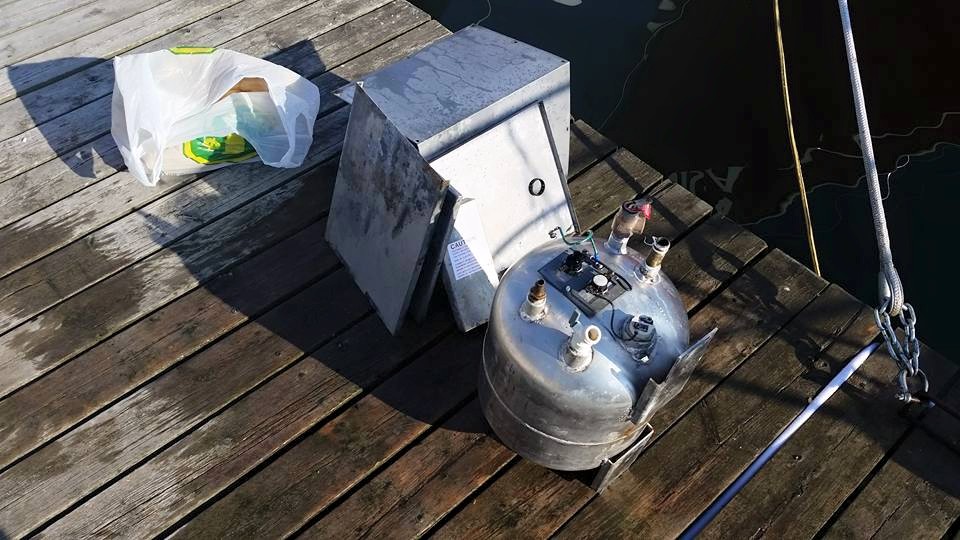

Thank you Howard, Gary and Robert!  I will perform all those checks as the 25 amp breaker burned out which shut down the pump, sump and (I'm sure) the battery meter.  As the 30 amp hot water heater breaker was also burned out (i.e. it was not resettable -- the button lost it's ability to be reset) I suspect there's something shorted out in there.  Also there's a leak of fresh water in the bilge in that area, so I'm suspecting the hot water tank could be leaking or open?  (Might not be if the system was holding pressure though?)
I bought a bypass fuse holder with the removable auto fuses and will try jumping the terminals at the fuse panel to see if a 30 amp fuse burns out or not when connected (I can try using the meter, but I'm a dunce at electrical technical readouts...).  This will save buying $25 breakers (ordering them) and burning them out.

Thanks again for the comments/suggestions.  Our boat sat on the hard for two years prior to our buying it, and the previous owner had clearly 'let things go' before putting her up for sale, so many little things are broken/worn.  I replaced the fresh water pump and it work fine.  There was a leak at the top water inlet fitting on the water heater that I tightened, which led to the underside of the aluminum tank leaking badly (I suspect that calcium in the water doesn't work ideally with aluminum -- after 24 years it was like Swiss cheese upon inspection).  The heater is now on back order, but all the fresh water leaks are solved!
