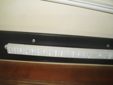

Here is the link to the strip lights I bought. I picked them up last year at the Strictly Sail in Chicago for $20 each but I see they have went up in price.
[url]http://mastlight.com/Products/HL-40LEDDCW.html[/url]
What I did was took everything out that was used for the florescent and used the power in leads to splice into for the LED strip. Looking at it you can not tell it was altered unless you take the white lens cover off.

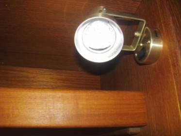

As for the rest of the light. The only one I have that is a regular bulb is the deck light, Everything else is now LED on our boat. There is a old post I think back someplace that I wrote about changing over the inside lights and where I got them from. I had pictures of the whole process I did but it was on my laptop which got stolen. I will be going back to the boat this week and will take a few pictures of the finished lights for all to view. The Lights I used for the inside came from Menard's and has I think 18 lights in the puck. You have to do some rework but if your handy it is a cheap and great way to go.

Here are a couple of pictures of the lamps I converted over to LED. The strip light has white white lens taken off and the flash from the camera made viewing the other hard. Sorry about them not being the best but it was 12 degrees in the boat and my fingers were dam cold.
