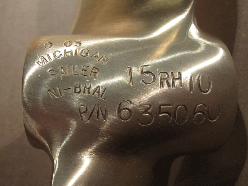

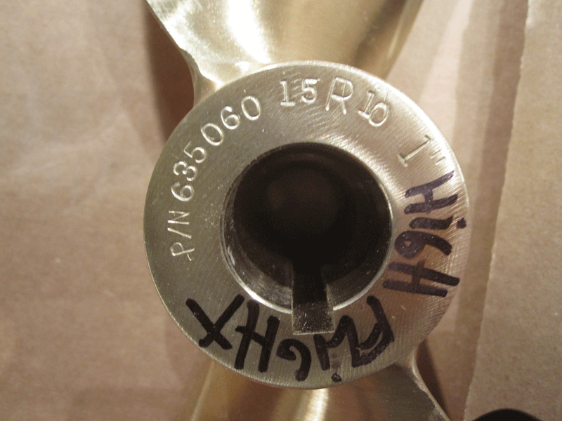

Bud, I just went through that decision myself and selected the two-blade. But first, let me say that the prop is a 15x10, not a 15x11 as you state. I called Ken in the parts dept at Catalina in Largo, FL, and he confirmed that the prop should be a 5x10, and I purchased the new one from him. Could it be that you have the wrong prop? If so, perhaps your excessive prop walk is a result of that. I frankly love the prop walk on my boat...I would call it a 'moderate' amount of prop walk, but it is absolutely predictable and reliable. It is a great tool for close quarter handling, and I use it that way and count on it. BTW, I would think a 15x10 would have less vibration than a 15x11.

Thanks for the input guys. Larry, we don't have a vibration problem, we actually don't have any problems with the 2 blade prop, except the prop walk. Other than that we find it totally satisfactory and never feel like we don't have enough grunt under power. I'll recheck the stampings on the prop next time I'm at the boat, I could be mistaken on the 11.
