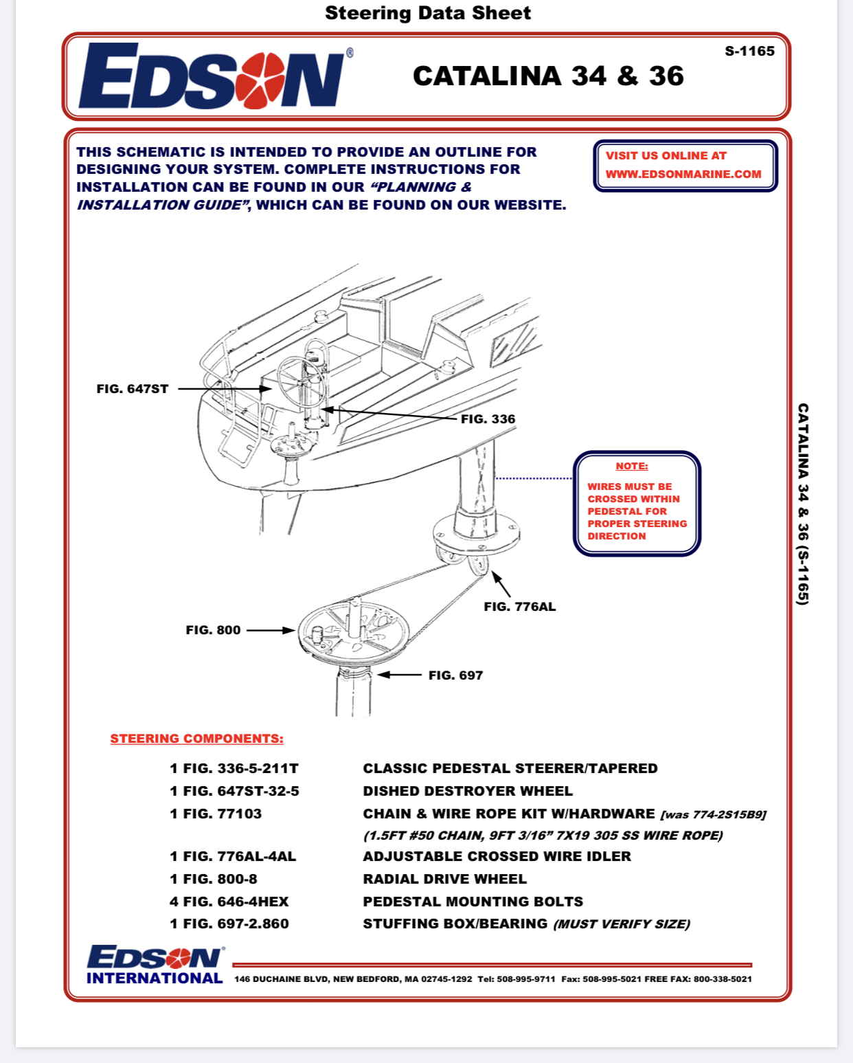

Does anyone have the diagram?

Have you checked the Edson web site?  It is an excellent source of information with diagrams and articles. The system is quite simple from the steering chain/cable back to the quadrant.  Also, good YouTube on various projects. I just completed a refurbishing of our steering system.
This is from Edson... but my boat has push push tubes rather than the pulley system shown here.
