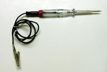

and a 12V test lamp, available at any auto-parts store for a couple of $$.

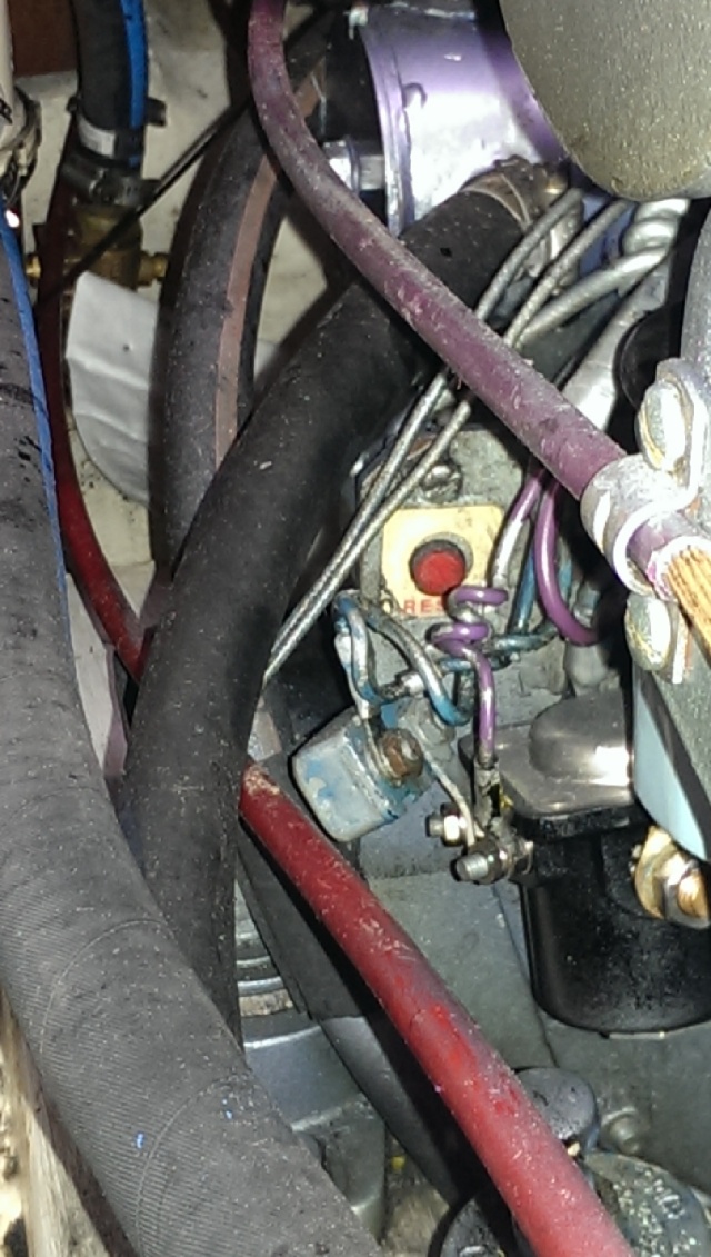

I'm so happy right now I can hardly contain myself! Get-A-Grip is running again :D
I cleaned every wire I could get my hands on, and clipped off a couple bad terminals and replaced them with new ones, but to no avail. I kept looking for circuit breakers and fuses that might be out, but no dice in that department either. But a guy who lives on my dock who used to work on M-35 tractor engines (that was news to me!) gave me a hand, and he found the "[B]RESET[/B]" button I needed to press almost immediately. I couldn't believe I missed it. It is the most obvious button in the world! If you have an M-35AC engine, it is right next to the glow plugs on the starboard side of the motor, pretty much on the opposite side of the motor as the starter. We pushed it once, and my engine alarm immediately started buzzing.
Here is what the button looks like on my engine: (first picture didn't work, see new picture attachment below)
I guess what threw me off is I assumed that the button/circuit breaker/fuse I was looking for would be on the alternator/starter/preheat solenoid/port side of the engine. Boy was I wrong!
But I learned a heck of a lot searching down there for a way to get my engine started. I gained a basic understanding of how to read a wiring diagram. I loosened and cleaned virtually every wire in that engine compartment. I learned from the former M-35 mechanic where the "[B]RESET[/B]" button is, and he taught me how important properly tightened wires are to an electrical system, especially ground wires (which I had already taken off and cleaned, but I did not tighten back up enough, as my mechanic friend kindly demonstrated to me using a multimeter). And finally, I also learned that my temp sending unit is indeed not working properly and I am ordering a new one (via eBay, instead of paying through the nose, thanks to yet another timely tip from my mechanic friend).
Hopefully, the picture above will help future novices like myself locate the big red "[B]RESET[/B]" button faster than I did!
And finally, thanks for all your excellent suggestions my fellow C36IA members. I had next to zero mechanical/electrical experience when I bought this awesome sailboat, and I know I would have been extremely reluctant to mess with the electrical system had I not received so many excellent tips from you all. And while my mechanic friend found the button I needed to push right away, I am confident that I would have found it eventually as I worked through all your suggestions one by one. And besides, look at all the stuff I learned along the way!
All the best--Joel S.

Wow, Joel, that is great news. As you correctly admitted, the knowledge and familiarity you gained is worth a lot.
BTW, that photo link only works for you, I suspect, and not us because we aren't logged in to your dropbox account.

Great news Joel! What you found was the 20amp engine circuit breaker that tripped either because it got wet or a component it protects got wet. As long as it does not trip again, it means that the fault was temporary and you should be good to go.

[QUOTE=JAS;21241]Thanks gents. I attached the picture a different way. Can you see it now???[/QUOTE]
Yes. Thank you.
BTW, David Power had given you the location of the 20A circuit breaker (reset) button is his earlier post in this thread.

That's a gawdaful place for a circuit breaker because just a little bit of spray from almost anything back there could be a problem. Even if it's waterproof, vibration and heat are enemies. I think later years have this in a different place. On our boat, the breaker is under the game table. Don't know if this is factory or not.....

Thanks for this information. I have always wondered what this red button was for; on my boat it is not labeled. I have always been afraid to test it. A stupid question-if you are checking the engine while it is running, can you use this button to stop it?

I had thought to jump my glasspack car jumper to the starter directly to test it, before removal. Stopped at brother in laws auto shop to get my jeep back from pothole repair, he gave this same advice to jump it, then said he could rebuild the Kabuta starter.
OK, now I have a plan...
Starter jump worked fine. Cleaned the negative ground to the engine, a bit scuzzy, but not terrible, made no difference. Ground wires disappear under floorboards, one goes to the control panel, the other...Oh yea, there are 2 negative grounds, one got buried as I slid new batteries in, and forgotten in the usual spaghetti around battery boxes and control panels. Found it , pulled it up, cleaned it up, and fired up that bastard. All is well, not sick to my stomach anymore.
If I had to stay on the dock past 4/1 it was $140 a week, damn this could have gotten expensive!
So what you should get out of this story, is the starter needs and is sensitive to have full power on clean terminals on both red and black sides or it will not have the Ah to turn at all or at full speed. Using one ground wire through the thin wires of the control panel gave me a ground, not enough Ah and probably some heating going on that could have been a real issue! The antifreeze spray does not promote good contacts on a starter circuit that needs every bit of per it can have
