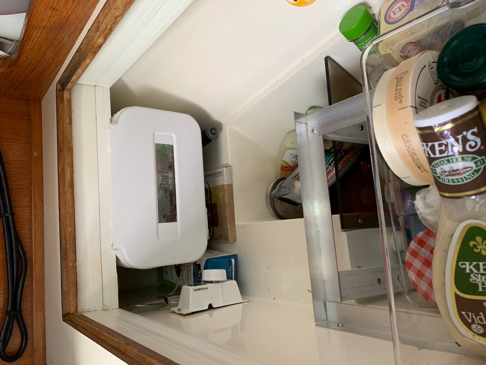

I have a 1993 Catalina 36 that I purchased in 2017.  It came with an Adler Barbour Cold Machine Installed.  It has the 101Z Compressor and, I believe, the PB105H evaporator.  I am not sure when this unit was installed although I do know it was not initially installed.  Currently the freezer temperature only goes into the 25 - 35 degree F range and the refrigerator in the 40's directly adjacent to the freezer and into the low 50's elsewhere.
The location of the compressor is fine, although I am considering improving the air flow.  However, it does not get overly warm.  The evaporator is mounted on the "shelf" at the aft end of the ice box. I am thinking that I may have 2 problems: 1) Insufficient coolent, and 2) a poorly placed evaporator.  Please see the attached image.  I am wondering if anyone has a similar configuration, especially the placement of the evaporator and can provide any insight into this situation.

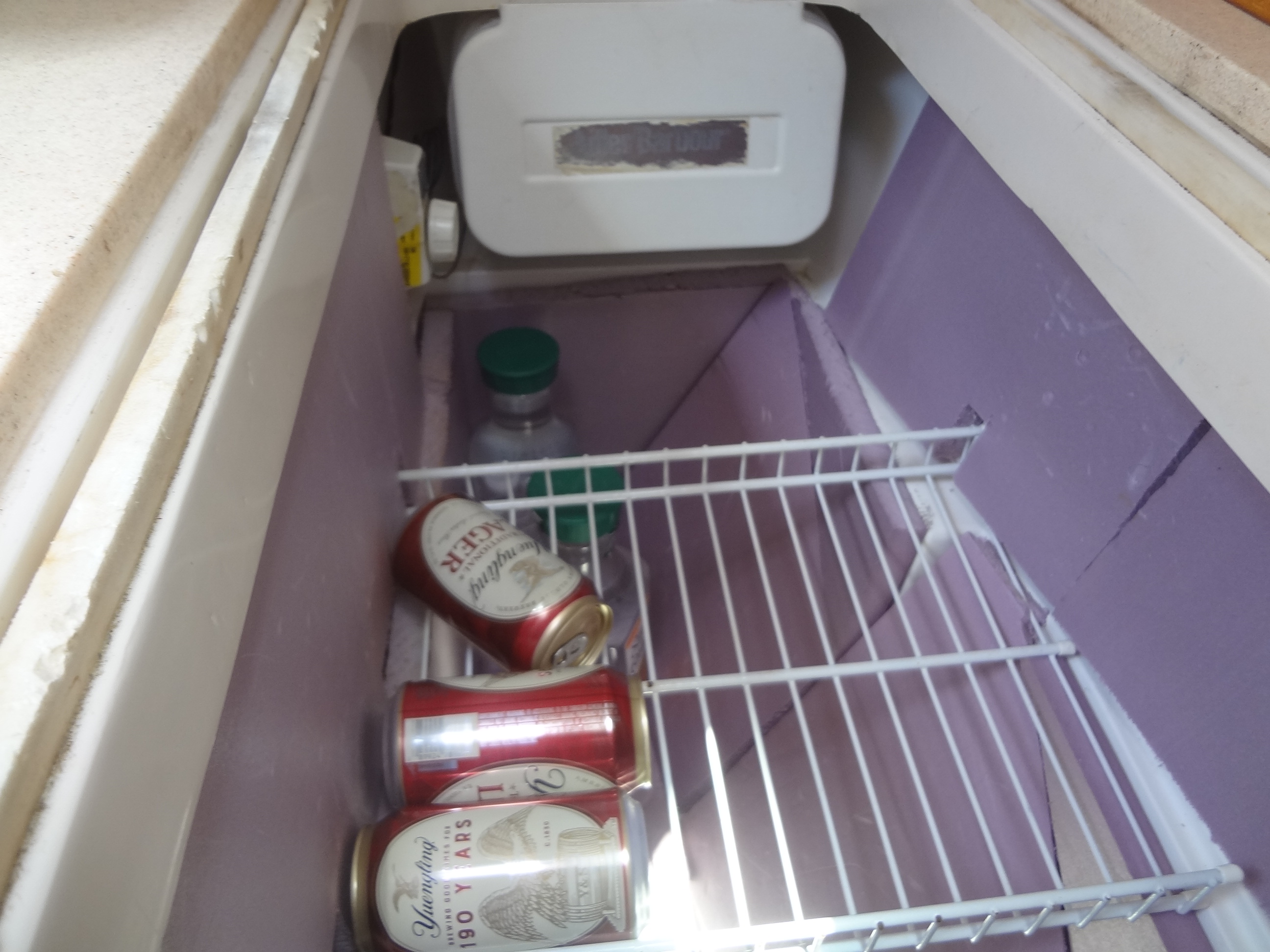

That placement is the same on our '98.You should also insulate the inside of the box with styrofoam sheets cut to size. Home Depot has a good product for that. In addition, a refrigerator fan would help spread the cold air within the box With a fully charged system, our freezer will be in the lower 20s and the refrigerator portion 38 in the fall and 92 in the summer in Florida. Water and air temperature can have a big impact on the system 's effeciciency.

Kevin, we at one time thought about adding additional foam on the outside. I don't remember how we were going to do 3 sides; but I did read how someone did drill a series of holes on the outside wall through which he sprayed foam and then glassed over the holes. We were not interested in doing that. The next best option was adding insulation on the inside. We first did it when living aboard using, I think, 1/2 inch styrofoam. With that in place we cruised throughout the west and east coasts of Florida, being able to plan 21 meals on board. We recently redid the insulation, upgrading to 7/8 inch sheets. Still no concern about storage size. Also, with a fully recharged system, in the warm waters of southwest Florida, the system would draw less than 2 amps an hour.

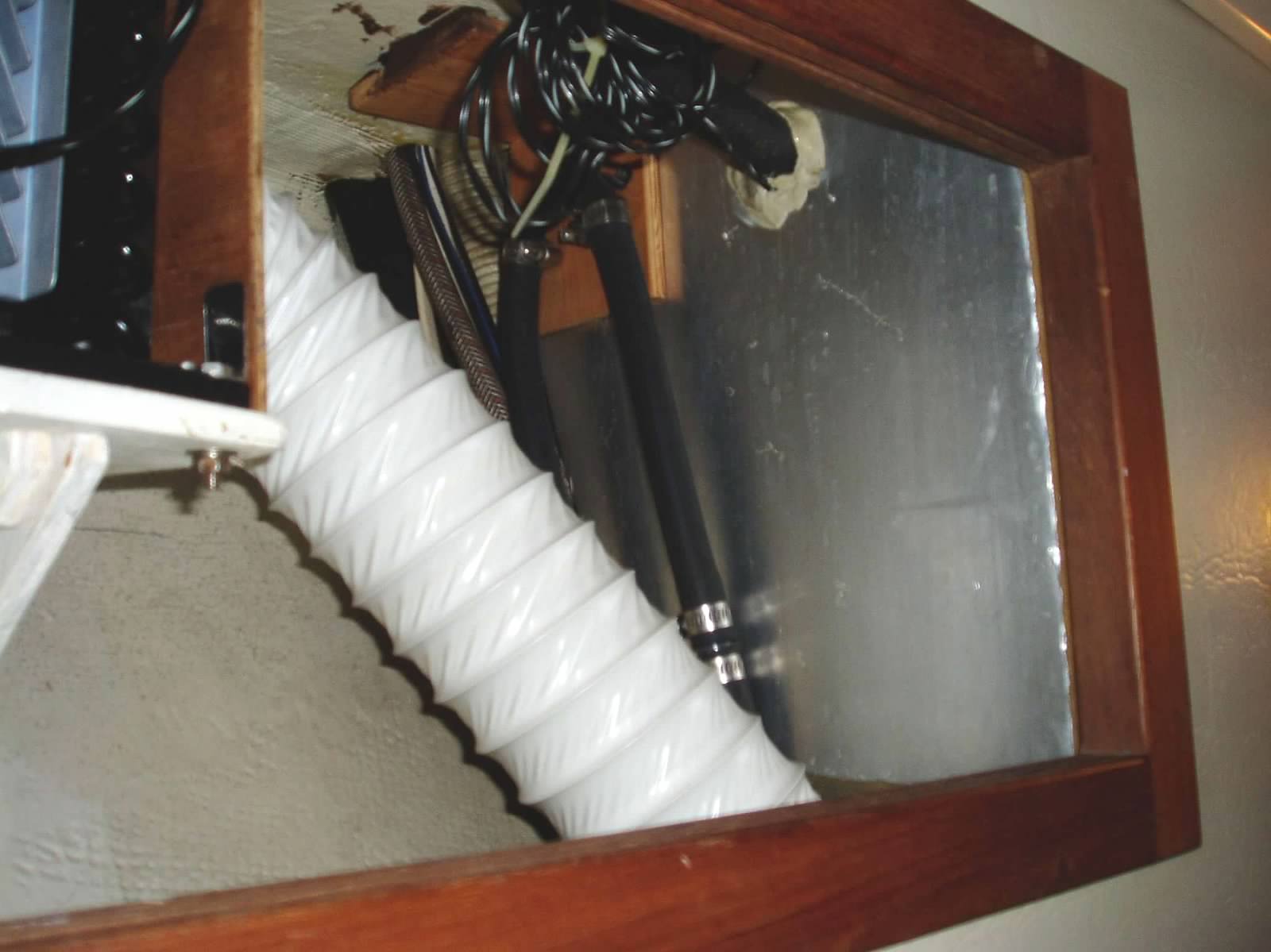

On Julandra (see photo) the owner added a panel of what looks like 7/8" foam board in the rear area through the aft cabin sliding panel (a challenge) and I believe got into the front space by removing the cubby under the stove and used a long flex tube to spray up under the counter, but drilling holes through the inner wall of the fridge would also work, then seal the holes.  Still, to your point, not as guaranteed to ensure full coverage as doing the interior.

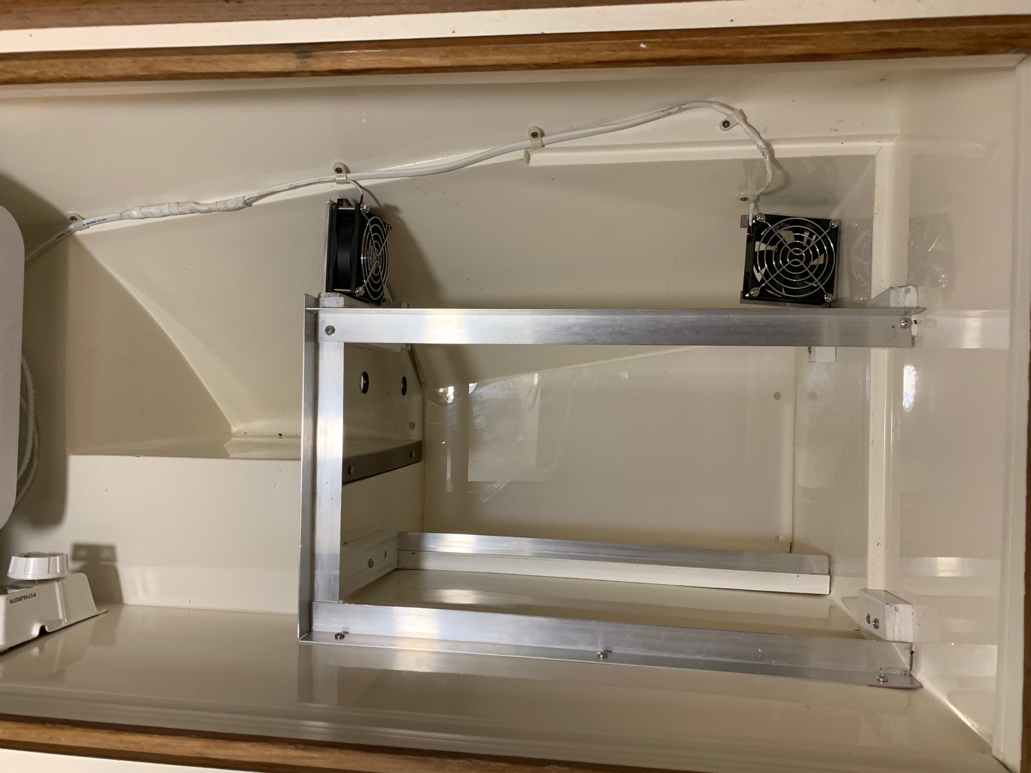

I defrosted the fridge, made sure that nothing gets put around the freezer unit and installed 2 fans inthe fridge to circulate the air better (see attachment).  The inside of the freezer unit is consistently between -5 and -10 degrees F.  Just outside the freezer the temperature is in the mid-40s and elsewhere still in the high 40's to mid-50's F.  This is with the thermostat on its lowest setting of 7. This situation is consistent with the fridge empty or with food in it.
Since the freezer is below 0 degrees F it seems to me that a problem with the thermostat is unlikely since it takes it reading from the freezer unit.  That would seem to leave a compressor/condenser problem - most likely low refrigerant.

Kevin, as you requested, I am attaching a photo of the interior of our refrigerator, showing the insulation we added. I did not place along the sides or bottom of the evaporator as we do use the area to pack frozen food on extended voyages. Bob, our thermostat setting is at "one'" the warmest setting. Currently, in Florida temps around 90 degrees, with equally warm water, our freezer is at 28 degrees and the box is at 42 degrees. During the winter, these will run 3 to 4 degrees colder. Even now, it is sufficient to freeze the all important ice and keep food frozen. Unfortunately, ice cream is a different matter. How much power do you use at your current setting? During the summer, our unit will draw on average a bit over 2 amps per hour and less than 2 during the winter.

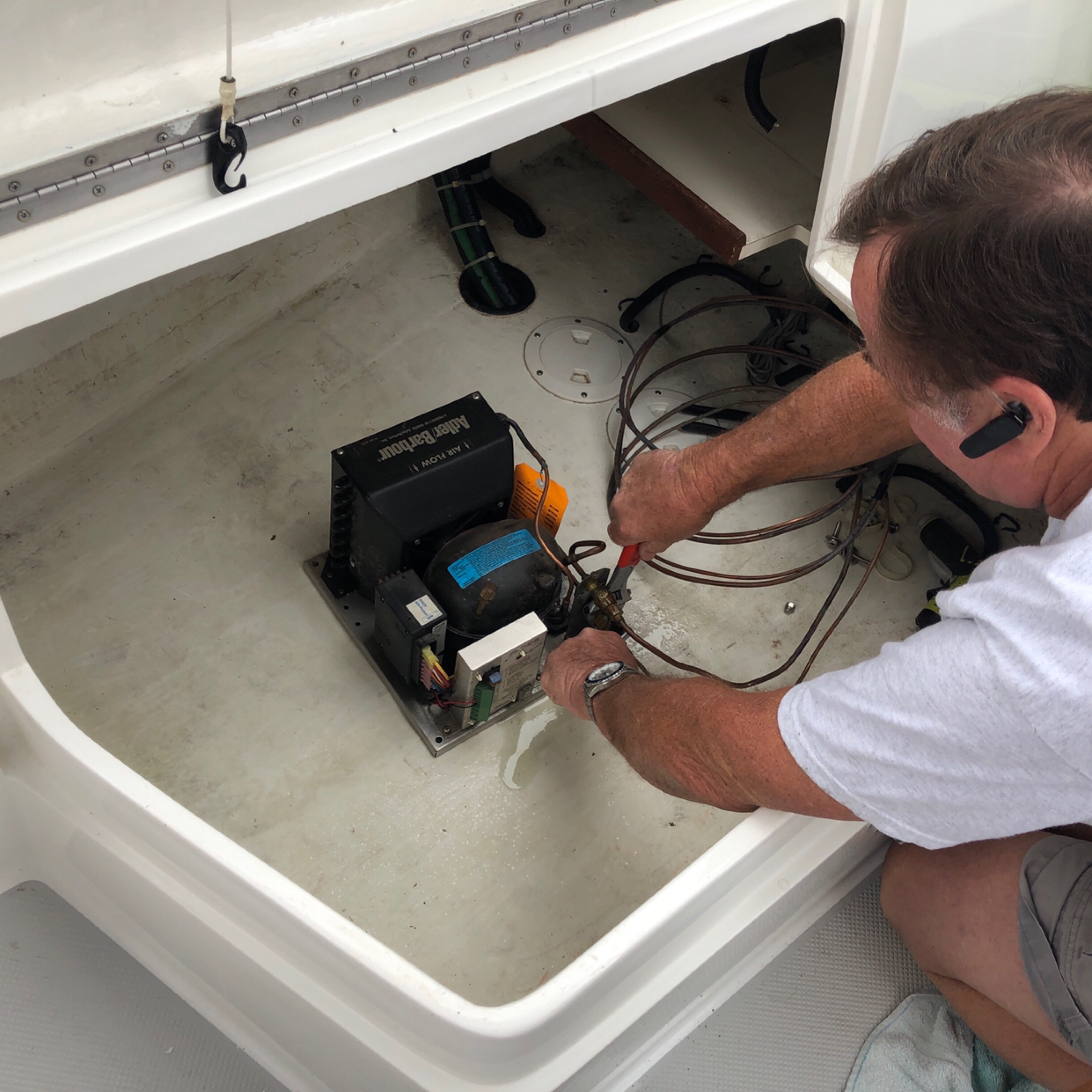

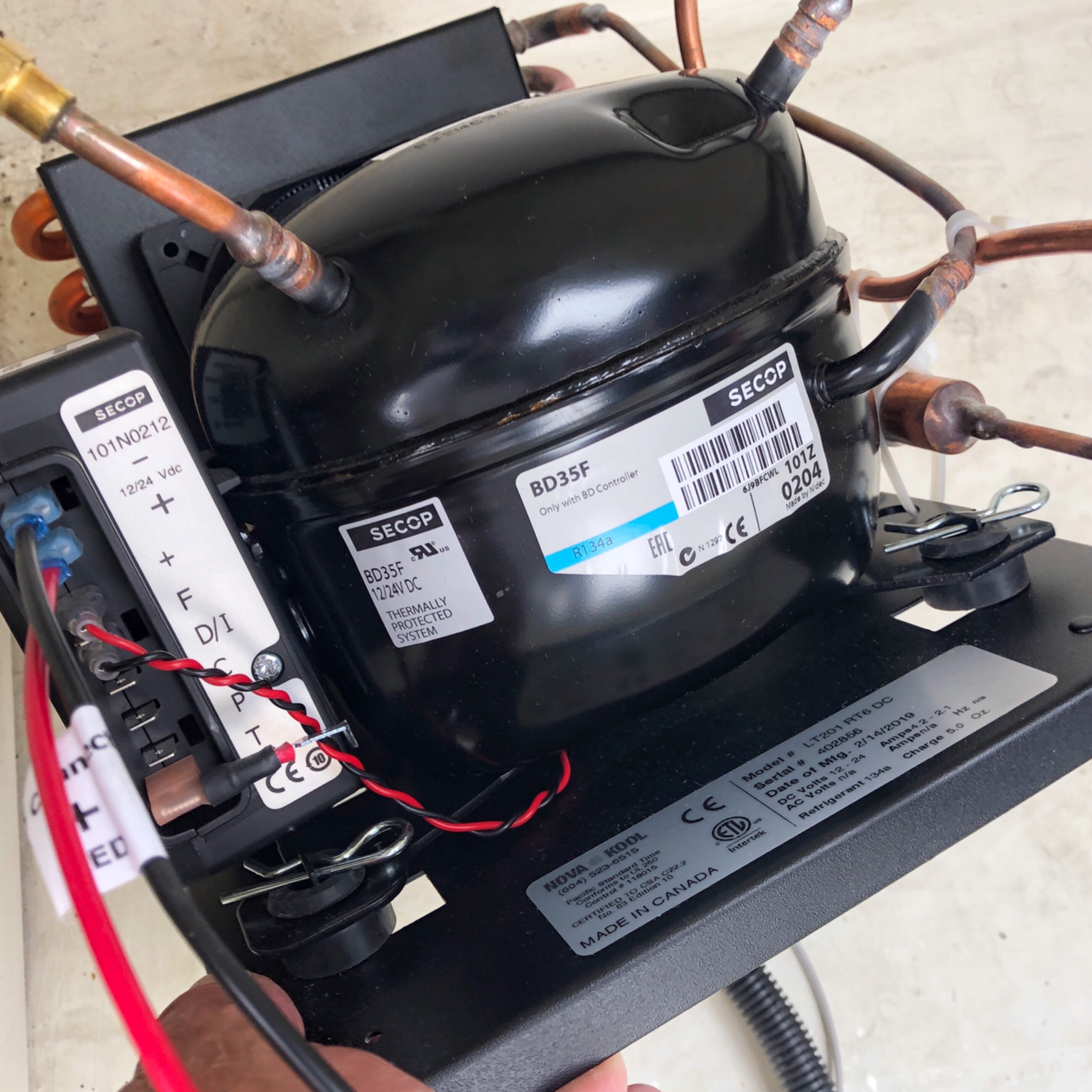

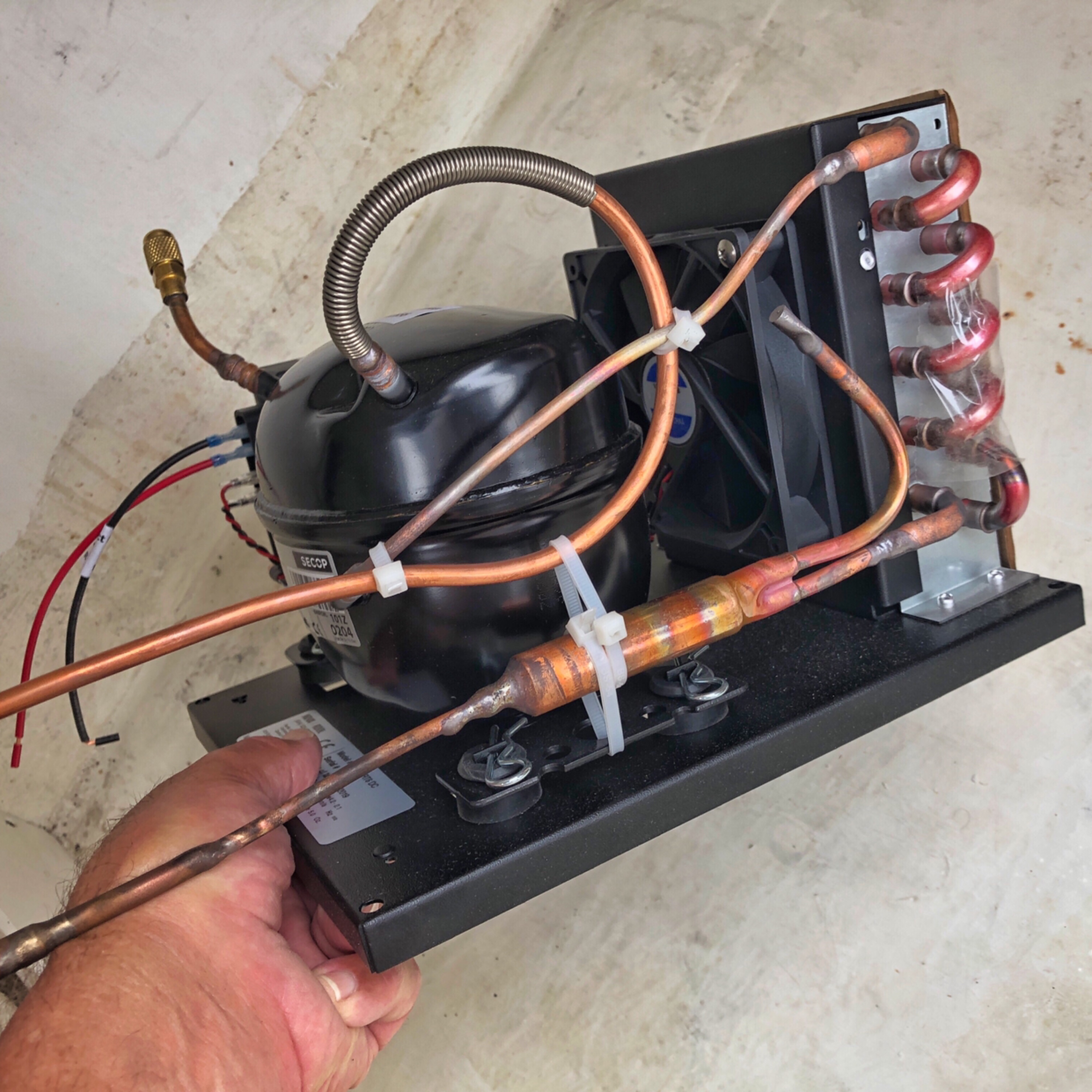

This week my frig unit was replaced on my 2003 C36 #2164.  The refrigerant was leaking at a pin-hole point where the tubing goes thru the box wall. As I understand, the tubing corrodes there at the caulked opening.  I’d had the Freon (?) recharged twice over the last two years, success at first, then returned to never getting colder that 50°F (and never cycling, running all the time.
Replaced with a Nova Kool unit.
Steven Jones
Seal Beach, CA, USA
stevenjones21@gmail.com
Posts: 239
Steven, I have not heard of Nova Kool. Therefore, I have several questions: 1) what model did you get; 2) what is the evaporator/freezer unit like and any modifications needed for the new one; 3) what does the unit draw, realizing your locale is a bit cooler than southwest Florida; and, finally, 4) is that you doing the install?
