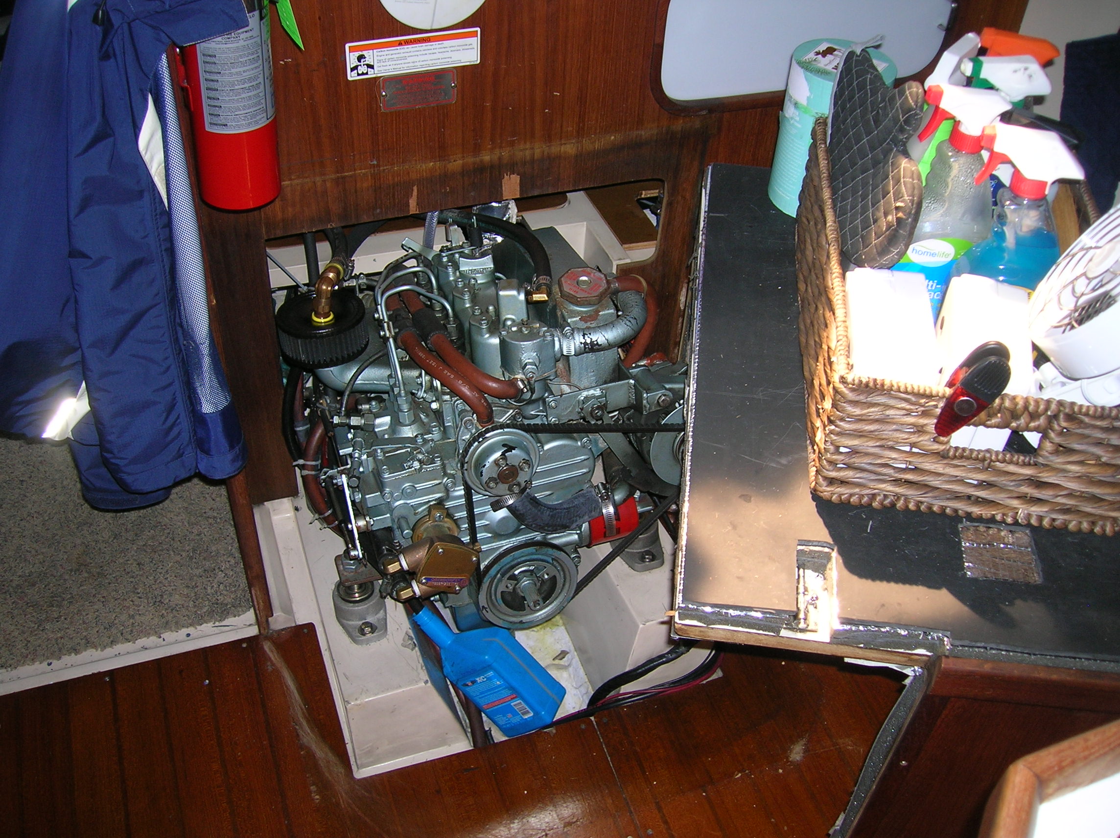

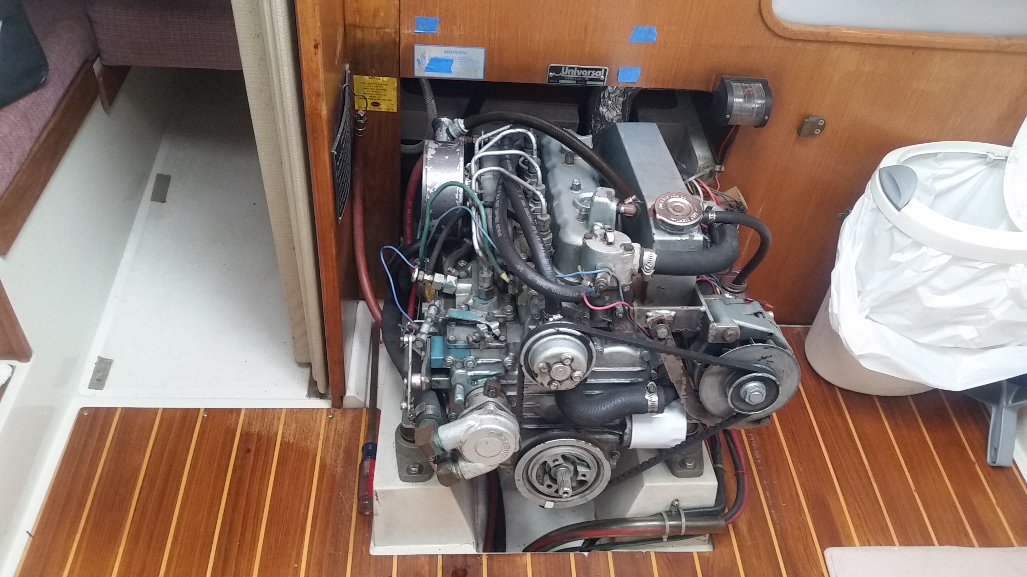

I have a 1991 Catalina Mark 1.5 (walkthrough transom) with a Universal M-35 Engine.  The oil breather is connected to the air intake through the Filter.  I've attached a photo.  There is some oil that collects on the breather and drips onto one of the rear motor mounts.  My concerns is the oil could corrode the rubber on the motor mount, or loosen the bolt on the mount.  I would like to install some sort of collection system for the oil before it enters the intake.  Has anyone made such a modification or seen this setup ?

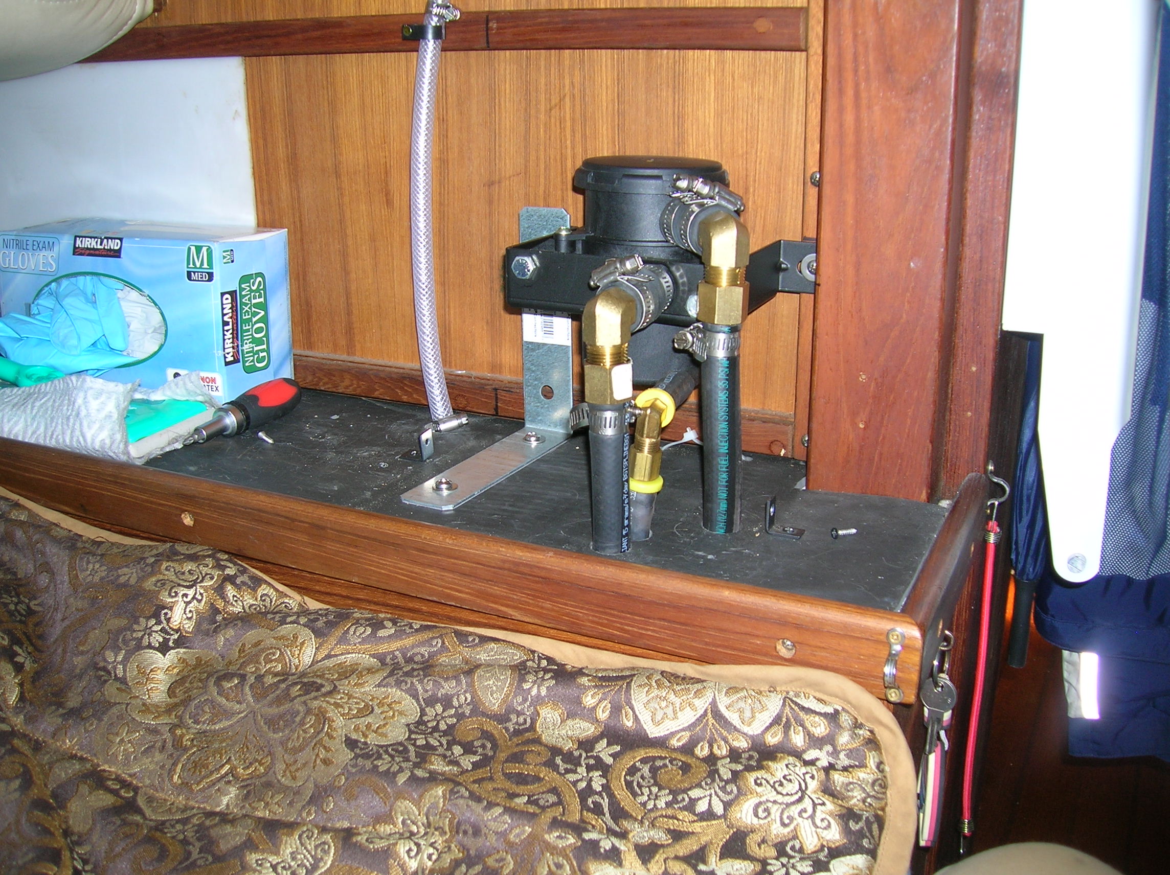

I did a closed crankcase vent system.I bought a Racor system .You go from the breather to the racor and then to the air filter. The racor has a filter inside that takes all oil out and sends just fumes to the air filter.I will be on the boat tomorrow and will get the model of racor which is a match for our engines since I talked to the people at racor.My wife loves this system as there are are no smells from the engine now

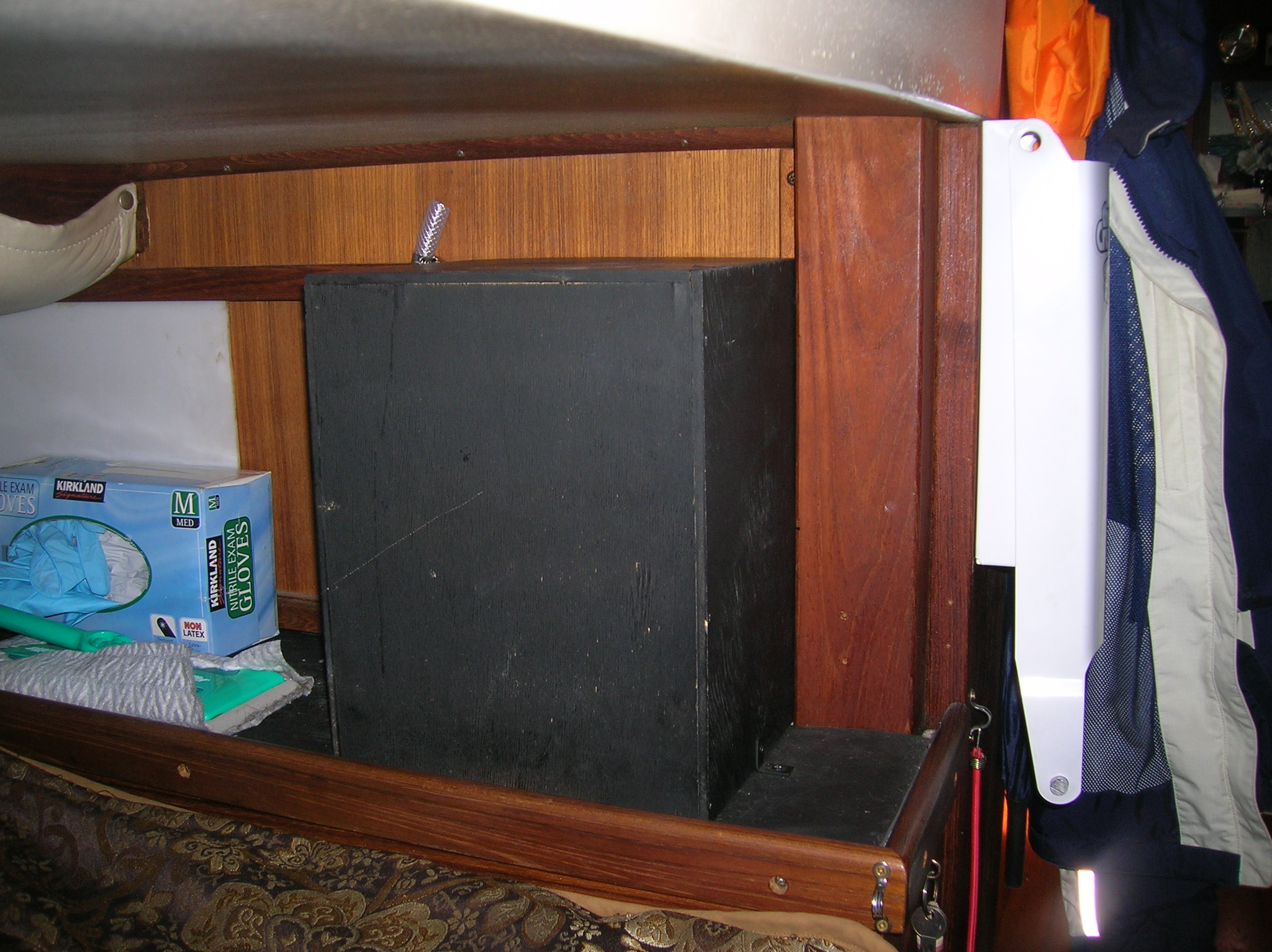

The unit I used is Racor CCV1500-04.I mounted the unit on the shelf in the aft state room.ran the hose from engine to racor then back to the air filter. there is a hose that comes off the ccv which will cary any oil to a quart oil container under the front of the engine The oil does not come out until the engine is shut downand after 2 years there is very little oil in there.Racor shows to route this hose back to the oil pan.Make sure you leave enough room above the ccv to get the filter out they advise to change at 500 hours.I paid about 265$for the unit it has cut down on oil mess and smells

Hm.  Well Dave, I'm no diesel expert (just bought our '91 3 years ago and only had a Saildrive and outboard previously), but I have the same engine as you do.   I suspect that the source of that oil in your air filter is NOT from the breather tube attached to the header, but from splash-back from inside the intake manifold.  I say this because on my M-35a the breather tube is not connected back to the air filter, it points straight down into the space below the engine.  I have never had any oil come out of that tube, rather it appears to be an air intake (which explains why the previous owner of your vessel attached it to the intake spout).   Also my foam air filter in the air intake drum is always oil-soaked, not because it is sucking oily air from the compartment (clean, dry air being sucked in back there), but rather because there is some spray making its way out of the engine (I am assuming unless someone can explain the source in some other way?).

I ran the hose back to Racor ccv on the shelf in the aft state room then to the K&N air filter. the other hose out of the racor goes to a blue qt container at the front of the engine
