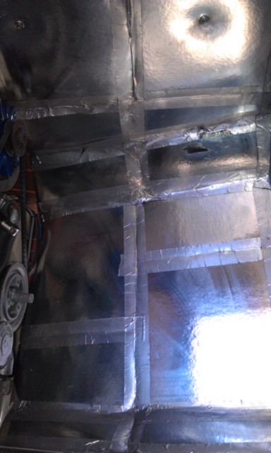

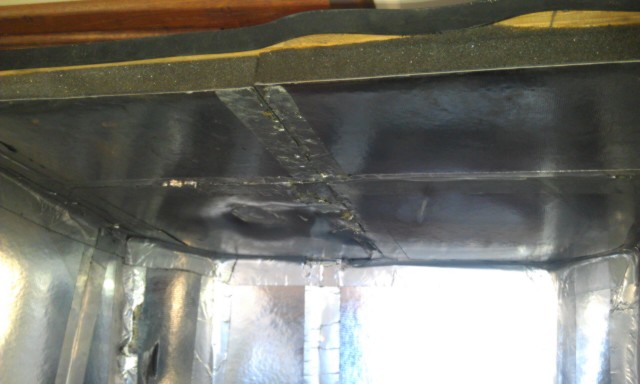

Hi Chuck. On the cover I removed all of the old Catalina insulation then added the new insulation. One of my projects here in the next couple of weeks is to add the insulation in the aft section and to make a cover for the rear where the transmission is.
Randy, if you get a chance, when next you have the engine cover off can you get a couple photos?
Larry yes I will do that for everyone.
Here is the pictures of the 12 x 12 tiles from Sailors Solution that we installed.
Thanks, Randy.

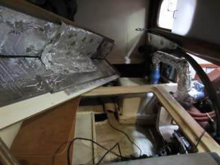

While i was changing the exhaust elbow and had the cabinetry off the back of the motor,i decided to soundproof as best i could...hopefully the picture reveals this ok...it made a noticeable difference and was worth doing.I also put this material on the wall between the galley and the aqua lift muffler..you can see some of this on the right side of photo.
