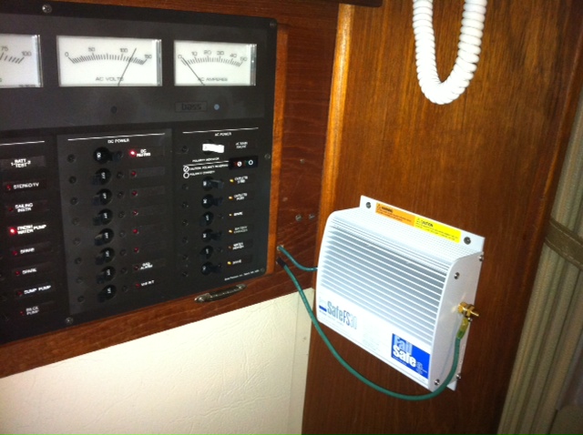

Thanks Main Sail for the idea. I took my digital clamp on amp meter and checked the green wire and I had just .032 of an amp in it, I am thinking it is the GFI's in the marina as a few other boats have had to do what I did or are running just a extension cord to their boat. I have never had a issue with corrosion due to current in the water. Yet. Maybe it is just luck.
I ordered a ProMariner ProSafe FS30 from West Marine. $300. Easy installation.
I had moved my shore plug to just above the electrical panel, so the ground wire run to the galvanic isolator is very short. See attached picture.
It needs to be in a cool, vented, dry place or they will void the warranty...so this was the best spot I could think of.

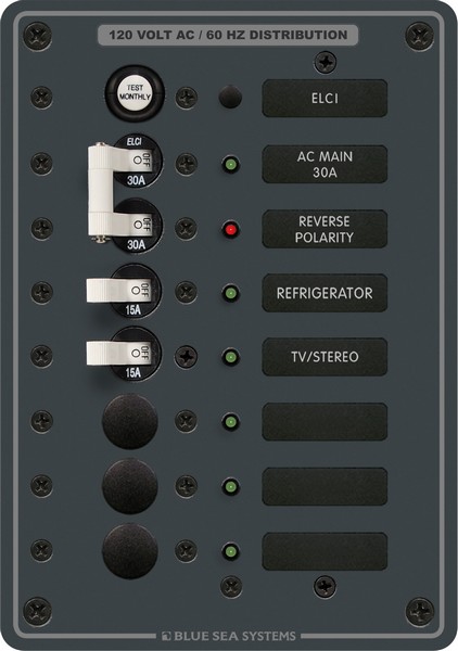

I'm looking at one of these:
[URL]http://bluesea.com/products/8100[/URL]
A local chandlery is carrying these and recommending them to comply with the ABYC E-11.11.1 requirement on all new boats.
"An Equipment Leakage Circuit Interrupter (ELCI) shall be installed with or in addition to the main shore power disconnect circuit breaker(s) or at the additional overcurrent protection as required by E–11.10.2.8.3 whichever is closer to the shore power connection."
The panel type are about $200 up here and one in a waterproof box is $320. Since it's designed exactly for this purpose would this not be the best route to go? Just not sure where it should be installed. Replace the main breaker at the panel or replace the breaker at the power inlet? If it is the latter, do I need two since we have two inlets, front and back, tied together with one breaker by the look of it.
I think I likely would get the #8101 which includes provisions for up to 5 branch circuits and replace the entire existing main breaker with this panel and run the existing 4 circuits out of it. Then add a 2nd 30 amp breaker at our front inlet, the rear one already has one on it.
