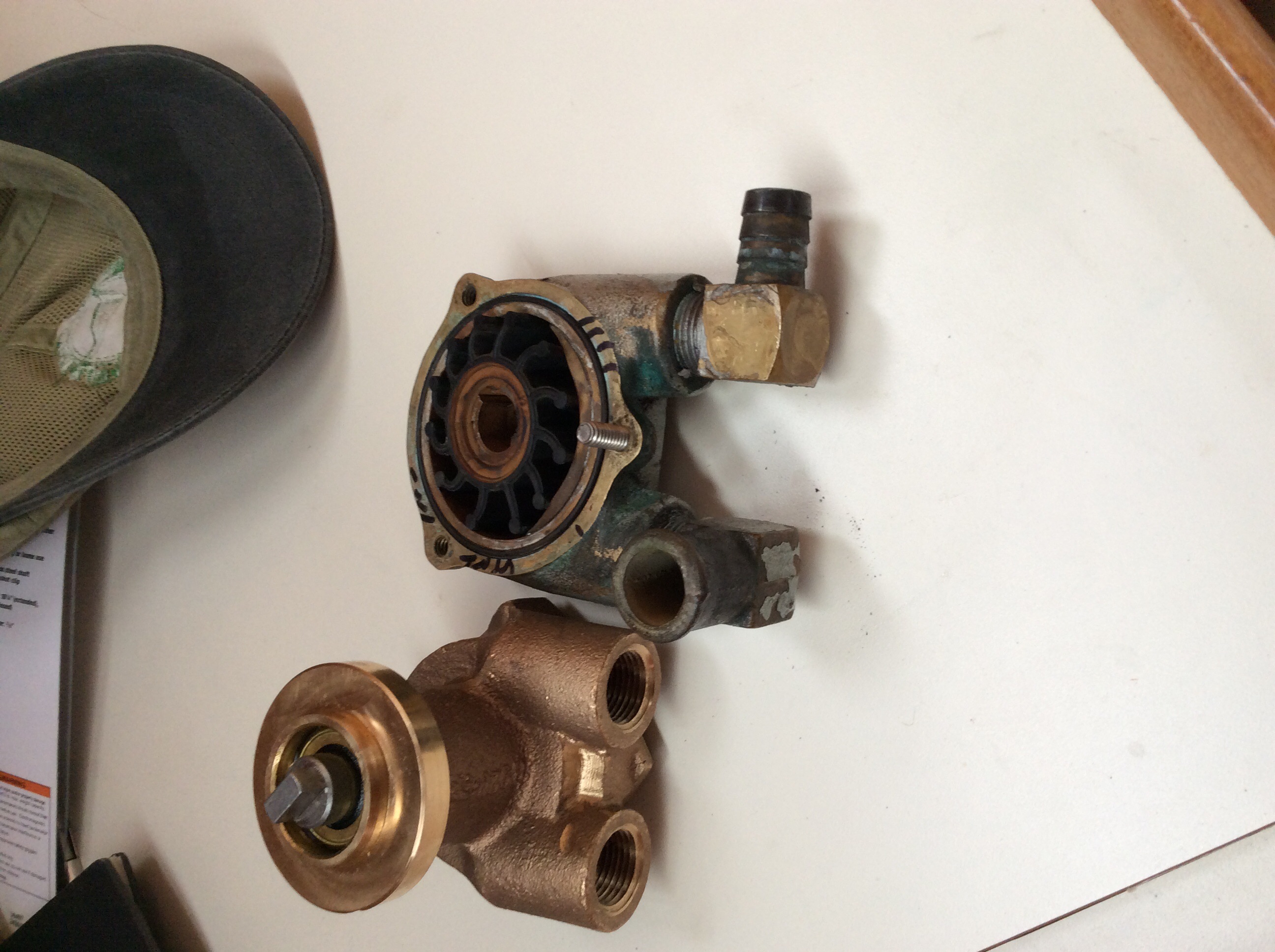

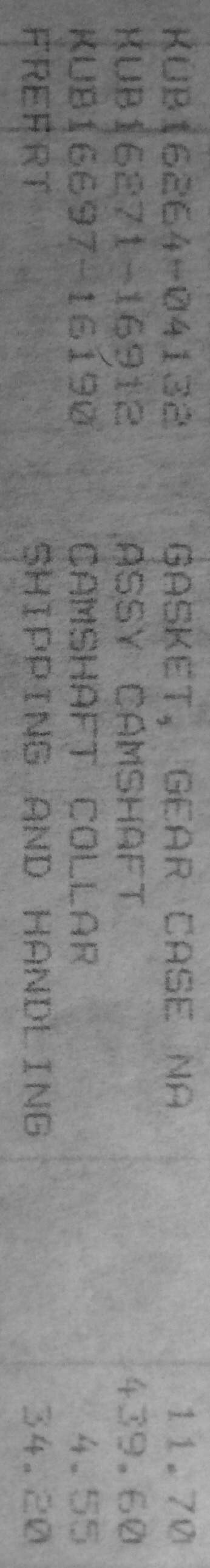

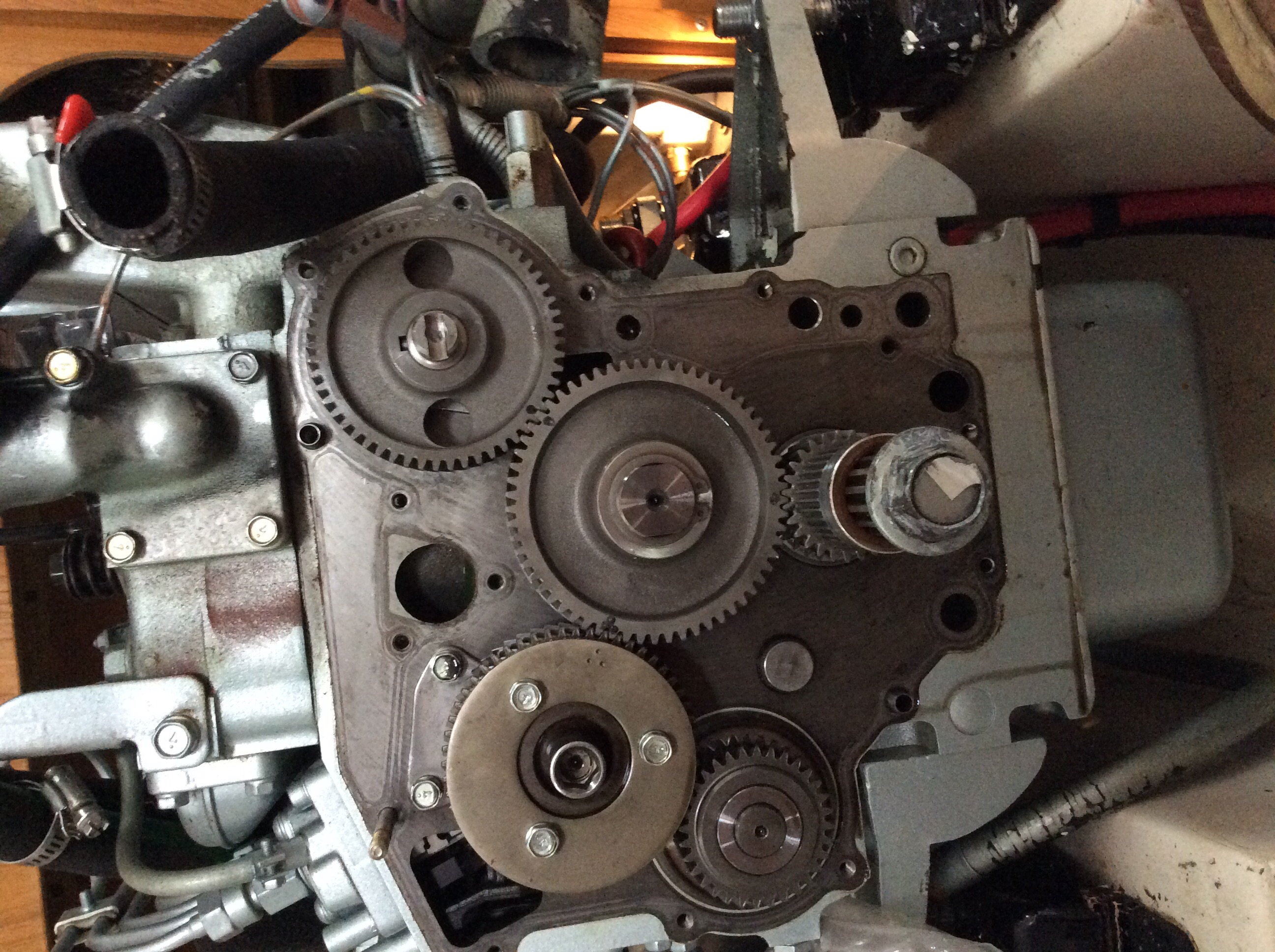

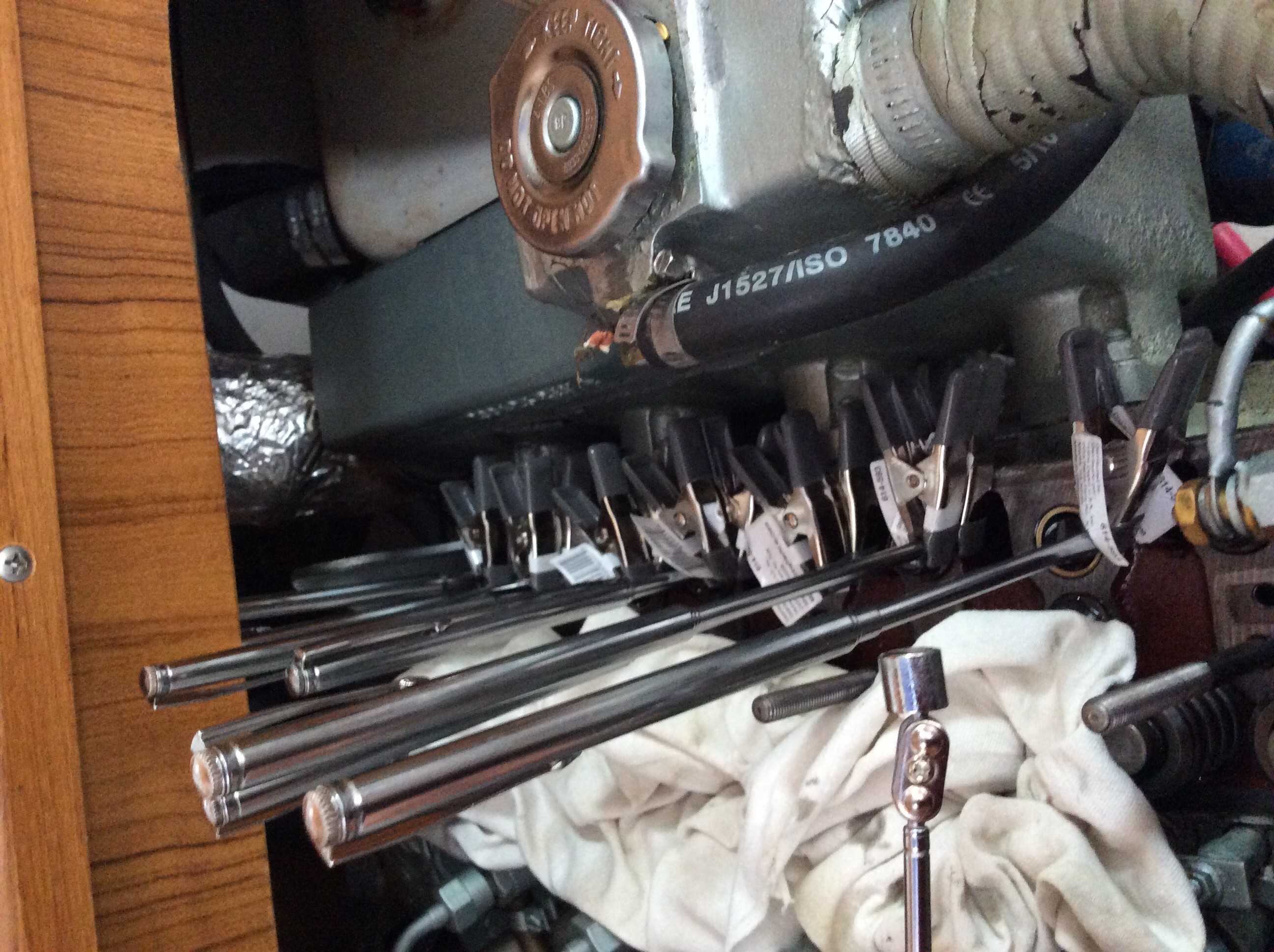

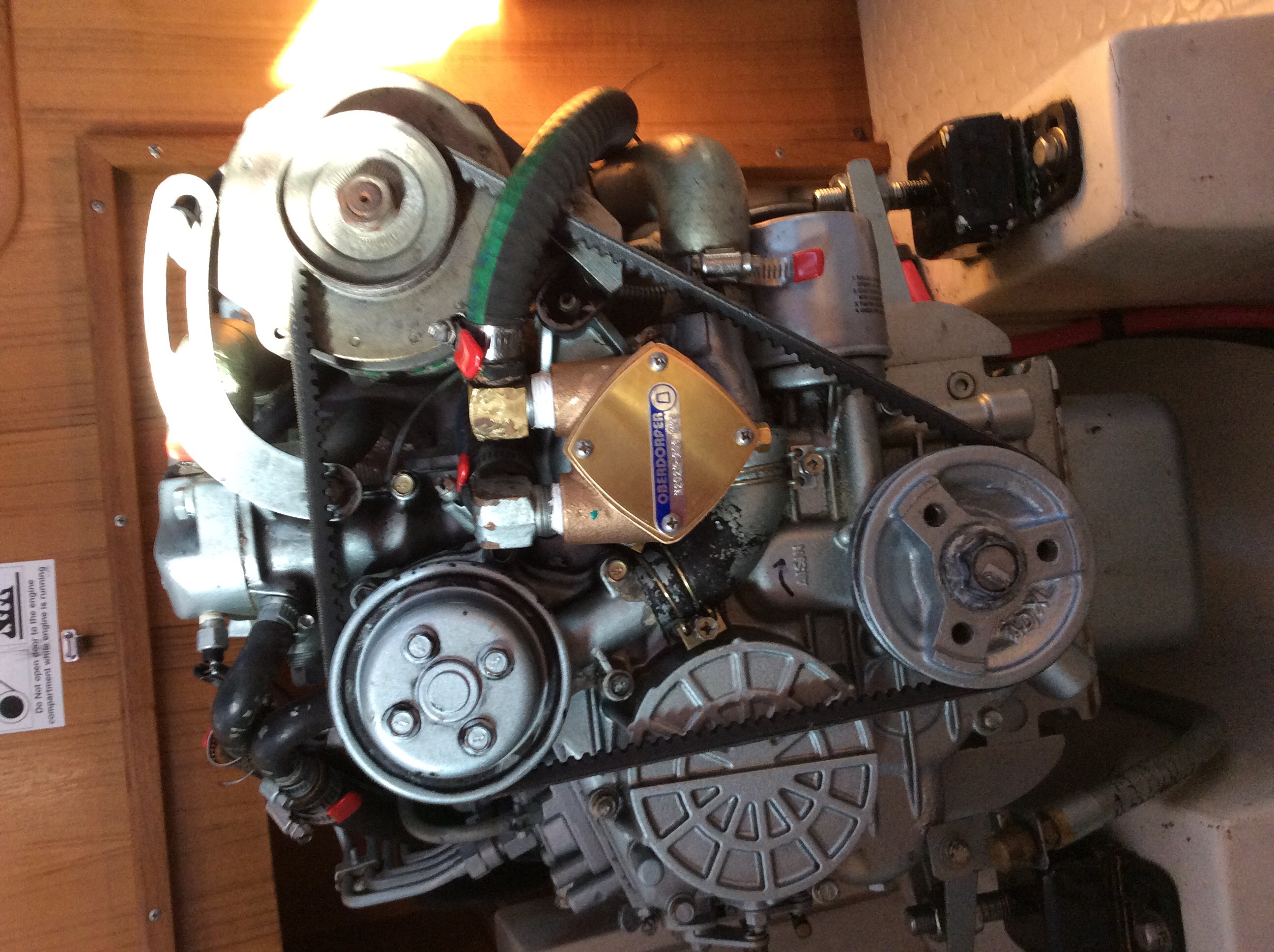

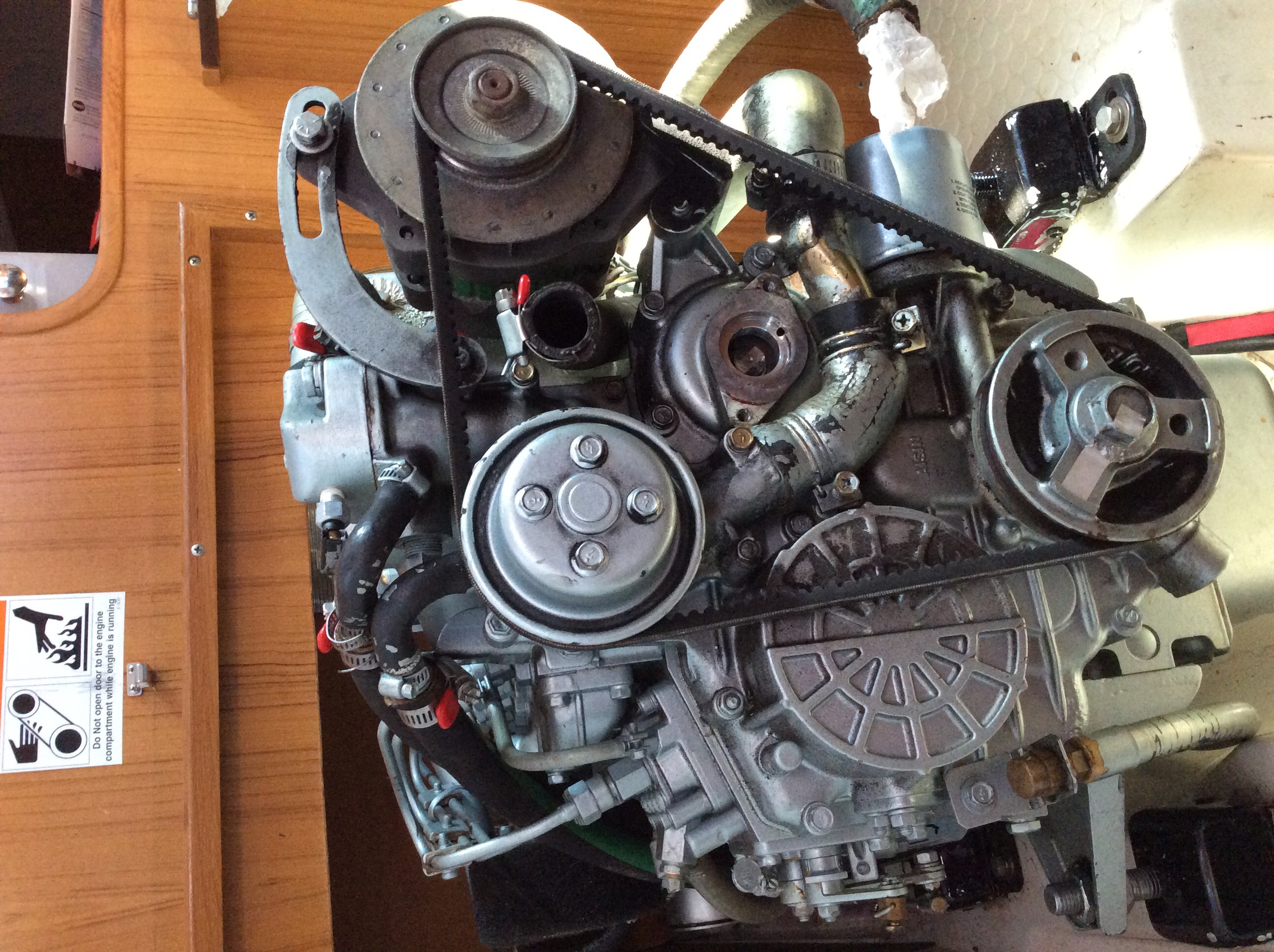

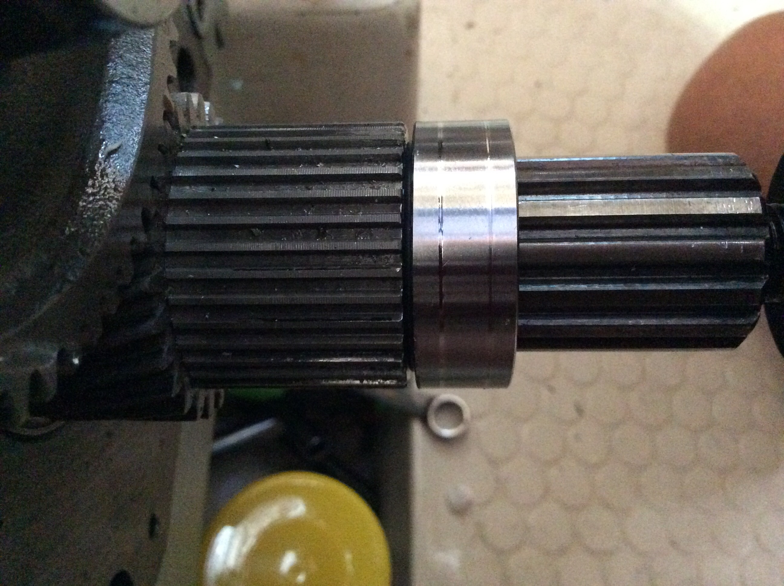

I recently had the dreaded cam shaft failure due to the Sherwood Pump seizing.
removing the gear cover was very easy. I replaced the cam shaft after removing the rocker arm, rods (being careful to keep the original order of the rods) and using magnets to hold the lifters up. The process of using magnets is very simple indeed. They are very strong and will securely hold the lifters in place. You can purchase the telescoping magnets from Harbor Freight ($3.50). I purchased small clips from Home Depot ( 2ea for every magnet ($0.30 ea.). No need to be concerned about pulling the lifter out of their channels as the bottom of the head prevents this.
You can purchase the Kubota engine cam shaft. As you will see in the photo attachments, it is considerably less expensive and rest assured it is the same Camshaft for a lot less.. I have the v1305block. Call Kubota master distributors, be persistent. Attached is a photo of the Kubota P/N's and prices.
Also attached are photos of the magnets along with other related photos.
You will be rotating the drive shaft dozens of turns until one gets all three gears in place with respect to the center idler gear.
Definitely purchase the oil seals for the sleeve that slides on the drive shaft. The sleeve will pop off. Do not slide back on for safe keeping it could easily get stuck as it is a very precise fit and may only be removed using a heat gun. (Voice of experience)
Lastly, do not replace your pump with a Sherwood Pump. Besides being backwards mounted and awkward to replace the impeller;  It can and does fail by seizing. Oferdorfer has designed an exact replacement, form, fit and function, for the Sherwood pump. The unit is designed NOT to seize!
My engine now runs perfectly again!

Firstly, how do you get the magnets down to the tappets?  It is a case of sticking them on the the ends of the pushrods?

The Oberdorfer pump started to leak so I decided to install the backup Oberdorfer that I had tested and stored away 5 years earlier. Before I installed I attempted to rotate the pumps shaft to make sure that it worked. To my surprise it was frozen and would not rotate due to dried up salt residue in the crevices.
I avoided an expensive engine repair, yes I have the cam shaft ring. I had to use a hammer to force the pump shaft out, I cleaned and restored and installed.
So, if you haven not turned on your engine for a while, the pump shaft may be seized. Remove the pump and try to turn it by hand to test it and prevent engine damage.
