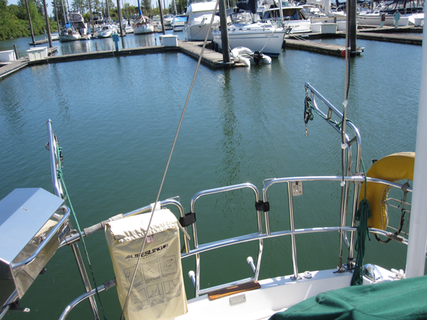

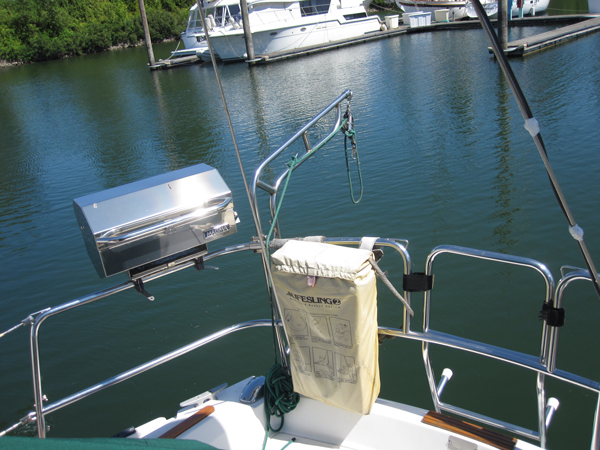

This year I installed the Forespar davits on my Mk I, #1339, Pooka. They are installed on the transom, 60" apart. The swivel bases (3" diam) are mounted on one inch teak blocks with a corresponding backing block on the inside. The only reqret I have is that I can't lower the swim ladder without lowing the dingy. The forespar davits swing in when not be used. This feature can save four feet on your winter storage bill and look neater if your racing. As you can see from the attached photos, the mounting options are limited.
John & Kathy Impagliazzo
s/v Pooka
Jamestown, RI
1994 C36 TR #1339, M35AC
During my cruising recently, I came across a couple of Mk I davit installations. I photographed them for this thread. If the photo resolution here isn't satisfactory, I do have high-res jpegs available. Just email a request to me.
