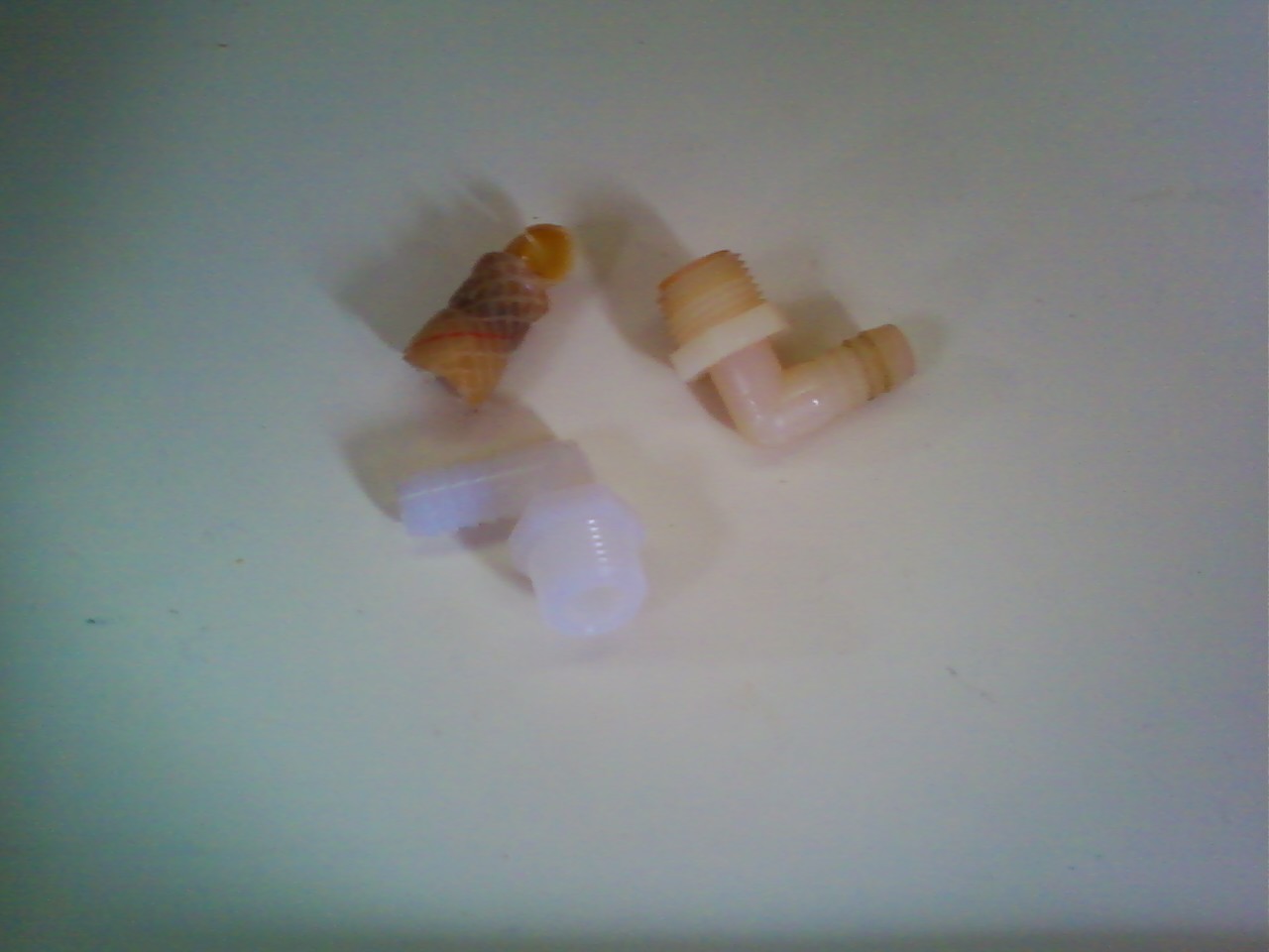

As my boat has aged, I've run into a problem with various plastic fittings in the fresh water system failing. The problem usually starts with the pump cycling mysteriously every half hour or so (I have an accumulator) and me going crazy trying to find the source of the leak. I then find a very, very fine leak in a cracked fitting; the one I had this week I could only find by shining a flashlight at the mist until I saw the very fine stream of water; almost like the stream of light in a laser light show. This one was the cold water attachment to the hot water heater (I replaced both, hot and cold sides).
The failed fittings have usually turned brown and brittle like in the pic. The fitting broke off trying to remove the hose, so I cut off the hose, which is also discolored. A new fitting is at the bottom for reference.
I can't find anything in common with the fittings that have failed other than the fact that they're all discolored brown. I now have a fair supply of 1/2" plastic fittings, but may start using brass.
Anyone else have an issue like this????

Yes, my C36 is 18 years old. I just acquired her last June and spending nights aboard I heard the pump cycle on a few times during the night.
I too traced the problem to fine leaks at fittings. When I replace the plastic fitting it doesn't always stop. I, like you have found that I often have to trim the hose connection back about an inch and reseat it before the leak will stop. I just think that the plastic stiffens over time and deforms due to the uneven pressure of the hose clamp. The leaks are never severe (not counting the one time the hot water intake blew off completely) but I carry a spare length of hose and spare fittings on board.

Gary, could the brown color be caused by ambioent heat from the hot water heater, or do fittings distant from the heater also show that discoloration?

You know Larry, I can't really answer that question. The one I replaced this week was on the cold side of the water heater; but that doesn't mean it doesn't get hot. The slightly discolored fitting in the pic I attached is on the HOT water side, so would definitely get very hot. I can't really recall where the other failed fittings have been, but they have all been in that general area, eg., under the settee in front of the galley. You could be on the right track.
I had to replace all the fittings at the hot water tank, they were brown and brittle and leaking. Our thermostat was also toast, it kept popping the breaker and it got the water so hot it blew a line off. That could be part of the problem because those fittings looked like they had a lot of heat. No problems since I put new T-stat on.
