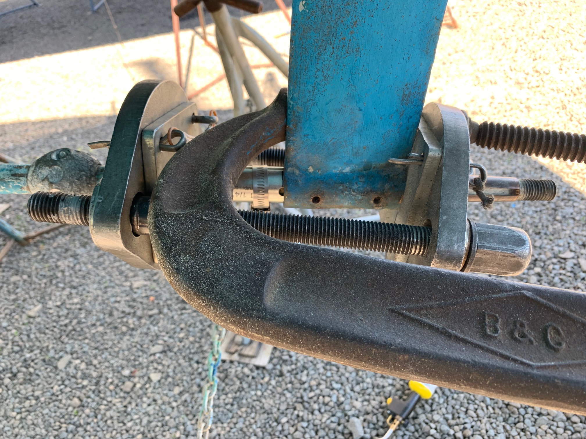

I have the association's tool and I have been unable to get my old cutless bearing out.  The tool is set up correctly, and the old bearing has moved about 1/8" and then stopped.  I have already applied too much torque to the bolts on the tool and now the tool has started to damage my strut.  I removed the two set screws on the side of the strut and some of the rubber from the old bearing has been coming out of one of the holes.  I'm thinking I am going to have to remove the shaft to change the bearing.  It seems like the easiest way would be to disconnect the coupling then pull the engine vertically to allow the shaft to move forward around a foot to expose the strut.  Has anyone had an experience like this?  I have an old boat, 1983, hull 55 and I don't believe the cutlass has ever been changed.
I put a clamp on the tool to maintain the alignment as I applied torque.  I ended up using a 30" breaker bar with a lot of force.

I am not sure if I am looking at the photo correctly, but it appears to me that the c clamp is in the way of the tool to make its progress forward.

I had my yard attempt to remove the bearing and they had the same problem.  So I ended up pulling the engine and sliding the prop shaft forward about a foot.  The bearing had to be cut out and it the aft end of the strut was peened over.  Don't know if this was done by the various attempts to remove the bearing or if it had been that way.  Removing and re-installing the engine is easier that it would seem and the new bearing is in with the boat in the water.  Thanks for the replies
