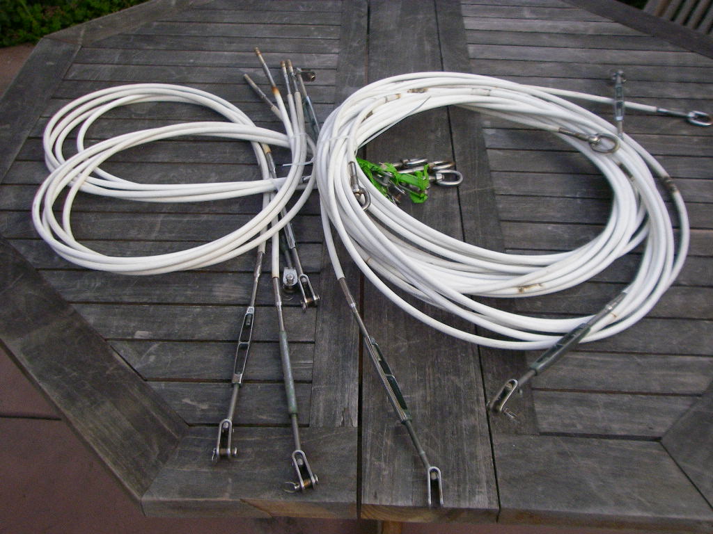

I just replaced my year 1999 lifelines with new ones.
Does anybody want the old ones? Good to fair condition.
Otherwise I'll just recycle them...

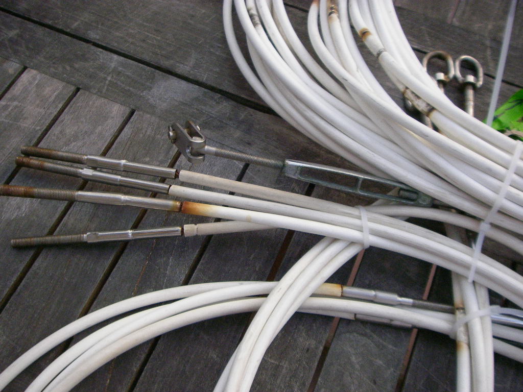

OK, what should I do with these old lines and hardware?
I replaced everything, down to turnbuckles, t-buckles.
So it was your 130 feet of 3/16" vinyl cable plus then all the hardware.
Those turnbuckles are not cheap...arrrrgggggg.
The old stuff was getting dirty...not shiny anymore....

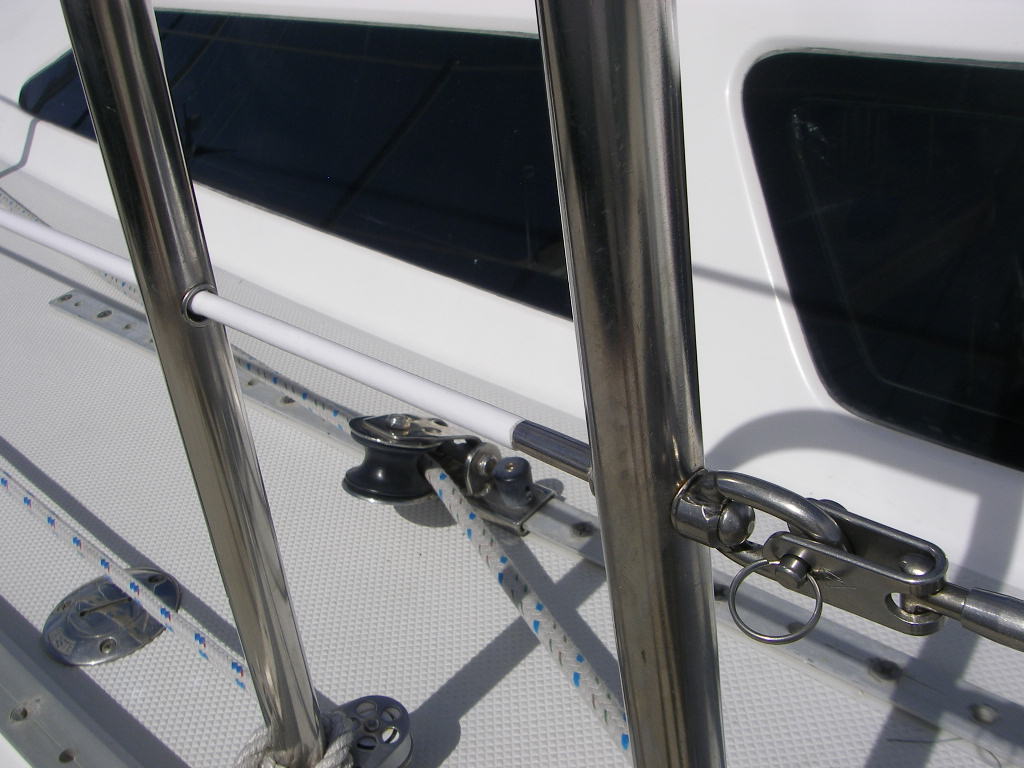

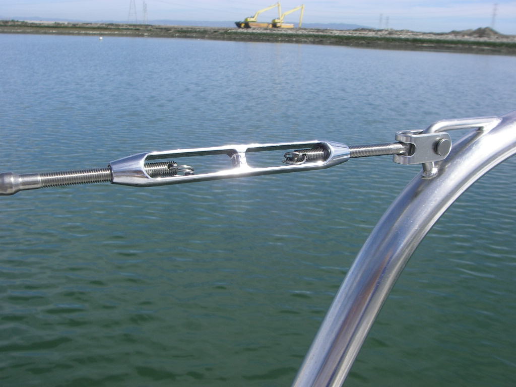

See photos of the new lifelines and hardware.

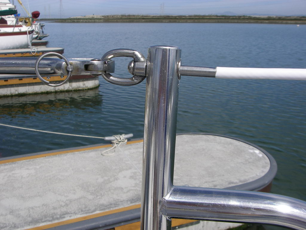

And some more...
