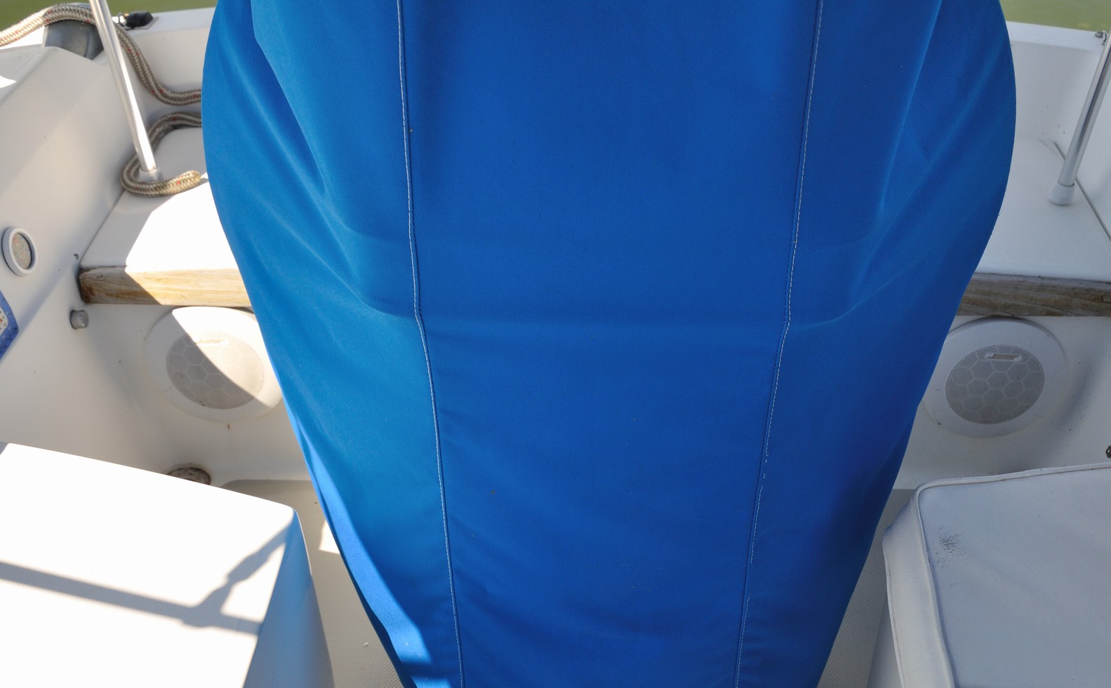

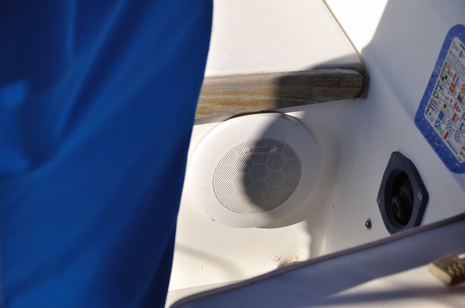

I took some pictures of my installation. The speakers have a hard case on the back of them and there is no additional protection added. They are mounted as high as possible on the vertical surface of the lazarette and they do not interfere with the lazarette lid. the speakers are mounted so that the back of them have the long speaker case pointed outboard, but NOT into the space between the hull and the interior wall/seatback.
This location does not cause any interference with people in the cockpit or the locker. I hose the boat down every time I use it and the speakers have been soaked with freshwater for the past 9 years and sound just fine.
