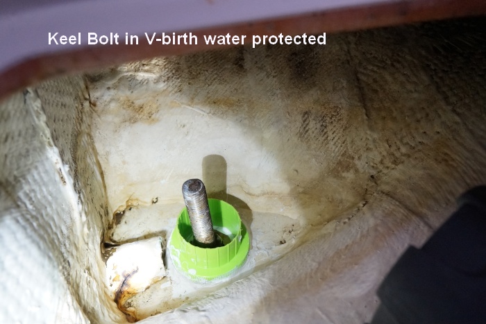

There has been many posts and comments regarding the Catalina smile and how to repair it - but I have not seen any possible cuses.
Here is what I believe is the cause - and I have a solution.
There is a keel bolt hidden under the V-birth floor board. To see this bolt remove the floor board retaining screws. The rain water floods the bilge that we see and can empty - but not the one beneath the floor board. Over time this water eventually find its way around the broken sealant of the keel bolt and enters into the plywood below weakening it and the keel drops down. To prevent this I placed a plastic cylinderical enclosure around the bolt and the washer and used 3M 4200 to keep the water out. See images here http://mei1970.org/saillavie/c36Album/index.php?album=Catalina-Smile
The plastic "cup" is the cover of a liquid laundry detergent. The reason I picked this cup was because it is double walled, about 1/4" wide, where it meets the bilge and its wide area provides good space for caulking. The image shows how the water accumulates around the outside of the cup - and keeps the bolt dry.
The other cause is over-tightening the standing rigging specially the forestay. This will bend the bow up and peel the keel away from the hull.

Have you found a way to tighten that nut?  With several tools I failed and gave up contrary to all the other bolts I tighten annually.
Enrique
Talisman
1998 36 MK2 Hull #1673
Tall Rig Wing Keel
M35BC engine
Old Saybrook, CT Summer
South Glastonbury, CT Winter
Posts: 473
I do not have the smile so I have not attempted to tighten the nut. I hope my solution will avoid the problem.
