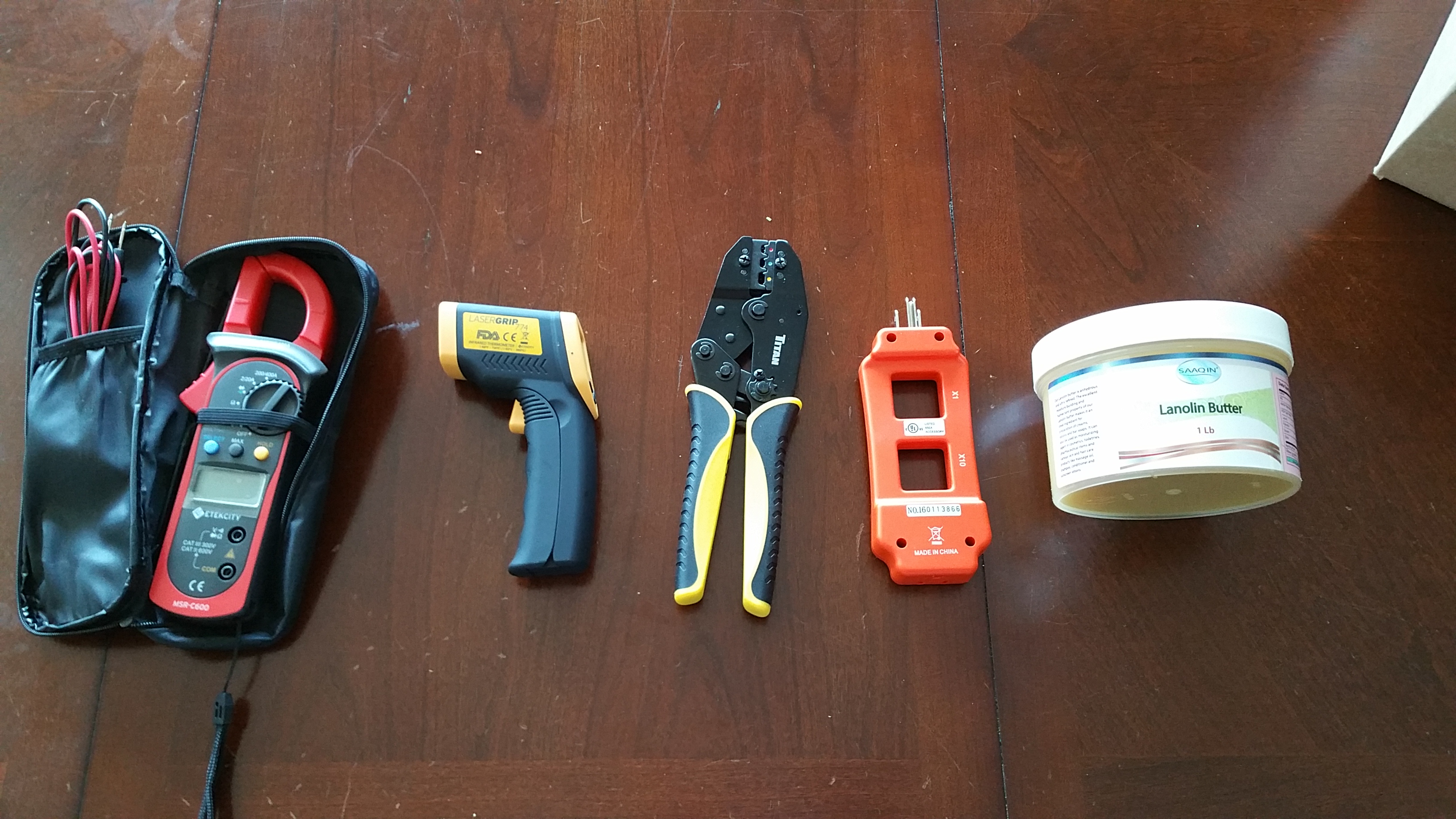

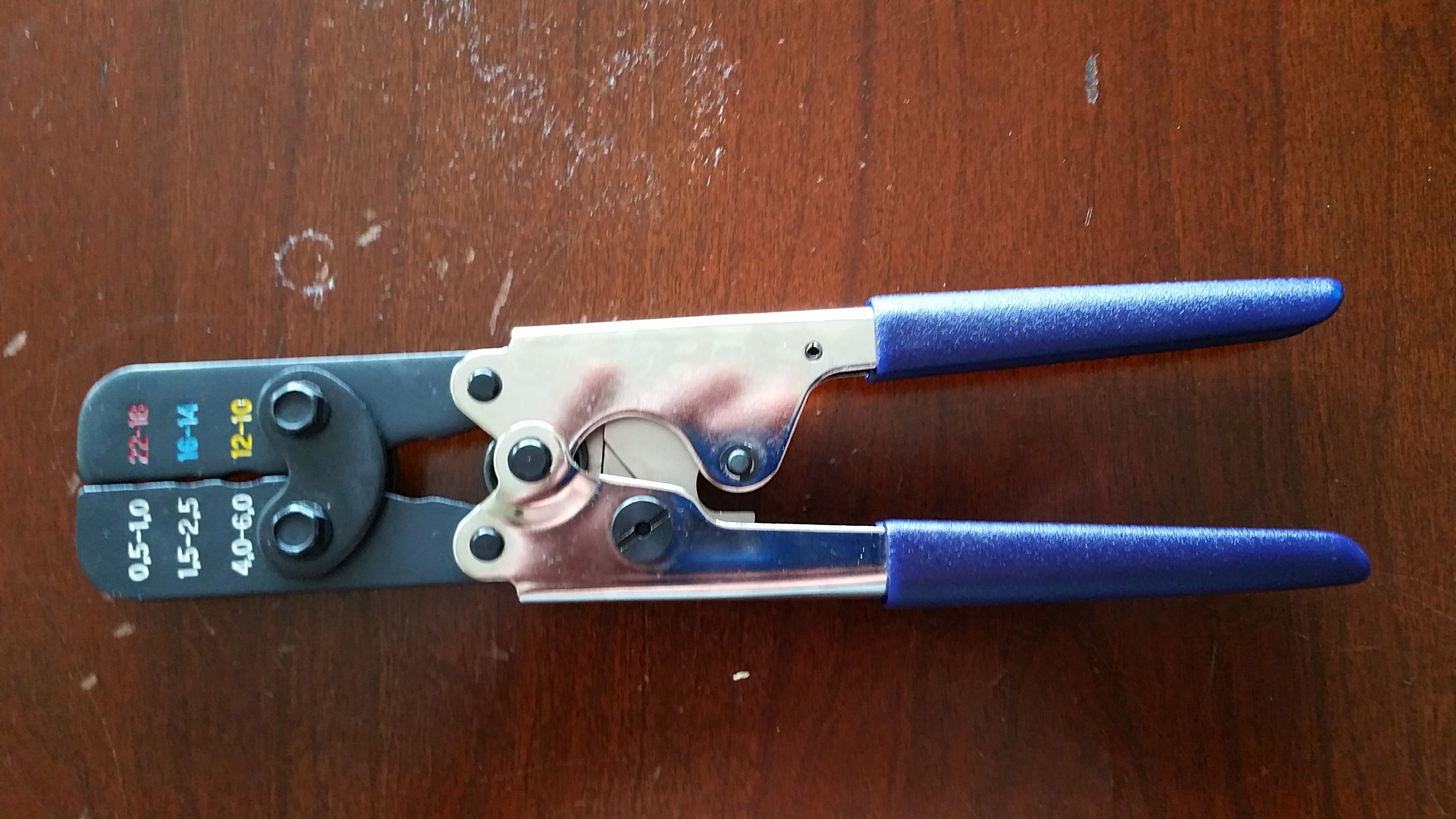

Btw, I think  you are right about  my electrical problem not getting better.  I visited  the boat yesterday and this time the water heater and the AC circuit  breakers both tripped.  The water heater definitely tripped while I was gone, not sure when the outlets tripped as I did not discover until after I plugged in a fan that would not turn on.

Joel,
As Chuck suggested above, I would NOT leave the boat with the AC plugged in until you have found and solved the problem.  You might come back and find the boat burned to the waterline.  Turn everything off and call a qualified electrician.

No more smoking or sparking, but I have no idea if I fixed the problem. Still, I feel a lot more confident about working with my electrical now that I have run a few tests from Calder's book and few others suggested by my fellow sailors on this forum. As far as the offending wire/terminal is concerned, I sanded it down and lubricated it. It wasn't green, but it didn't look that great either. But currently it is not exhibiting any scary behaviors.
Joel Schwartz
s/v Get-A-Grip
1993 Catalina 36 Hull #1259
Newport Beach, California
JAS's picture
JAS
Joined: 12/16/12
Posts: 258
Also, I learned about some stuff I wasn't intending to learn about. I learned that my gavanic isolator is likely not working properly, when I tested my water heater, I found and fixed a leak at my water heater line that was slowly filling my bilge (that I mistakenly thought was coming from washing my boat and over filling my tanks), I discovered a .6 volt reading in the water near my shore power (which Calder says is a serious issue) and reported it to my marina, I discovered that my neutral and ground circuits are likely improperly tied together (see above), and I took off and cleaned the misbehaving terminal that got this whole process started....but I'm not sure any of this interesting information and cleaning is at all tied to the sparking and smoking I witnessed at my AC breaker!
Joel Schwartz
s/v Get-A-Grip

JAS's picture
JAS
Joined: 12/16/12
Posts: 258
Maine Sail's heat shrink terminal crimpers just arrived...time to head back to the boat and keep testing and then do me some crimping!
Joel Schwartz
s/v Get-A-Grip
benethridge's picture
benethridge
Joined: 5/13/09
Posts: 446
Well, if you spent all that money on tools, I'm thinking you might as well spend a few more $ for the book I mentioned.  It's a good troubleshooting guide, in addition to Calder.
