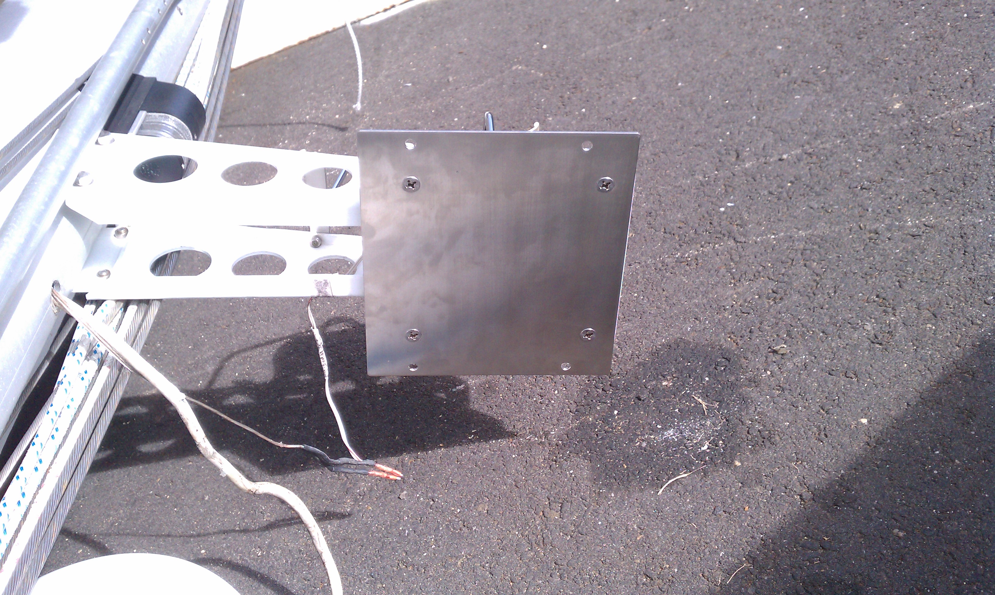

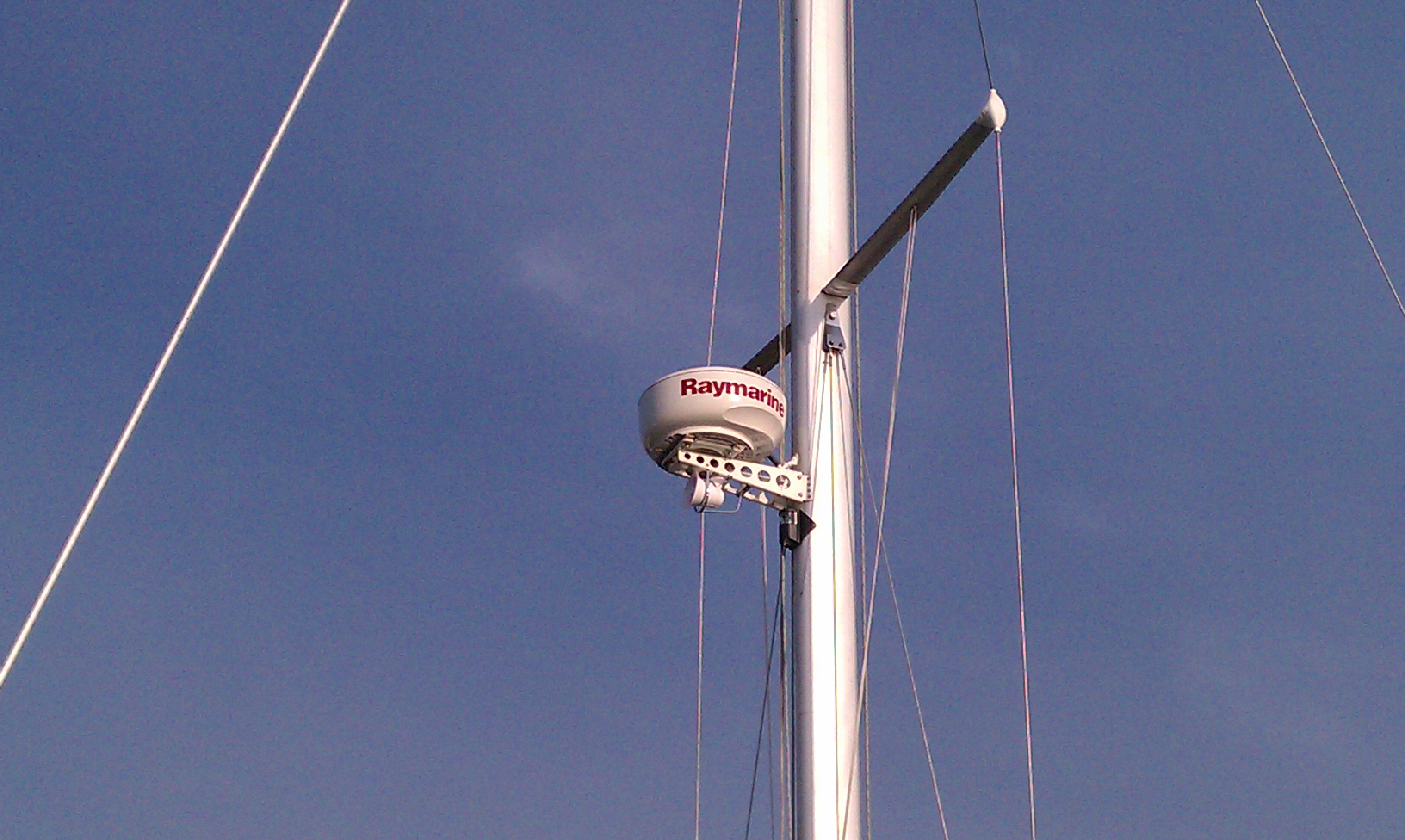

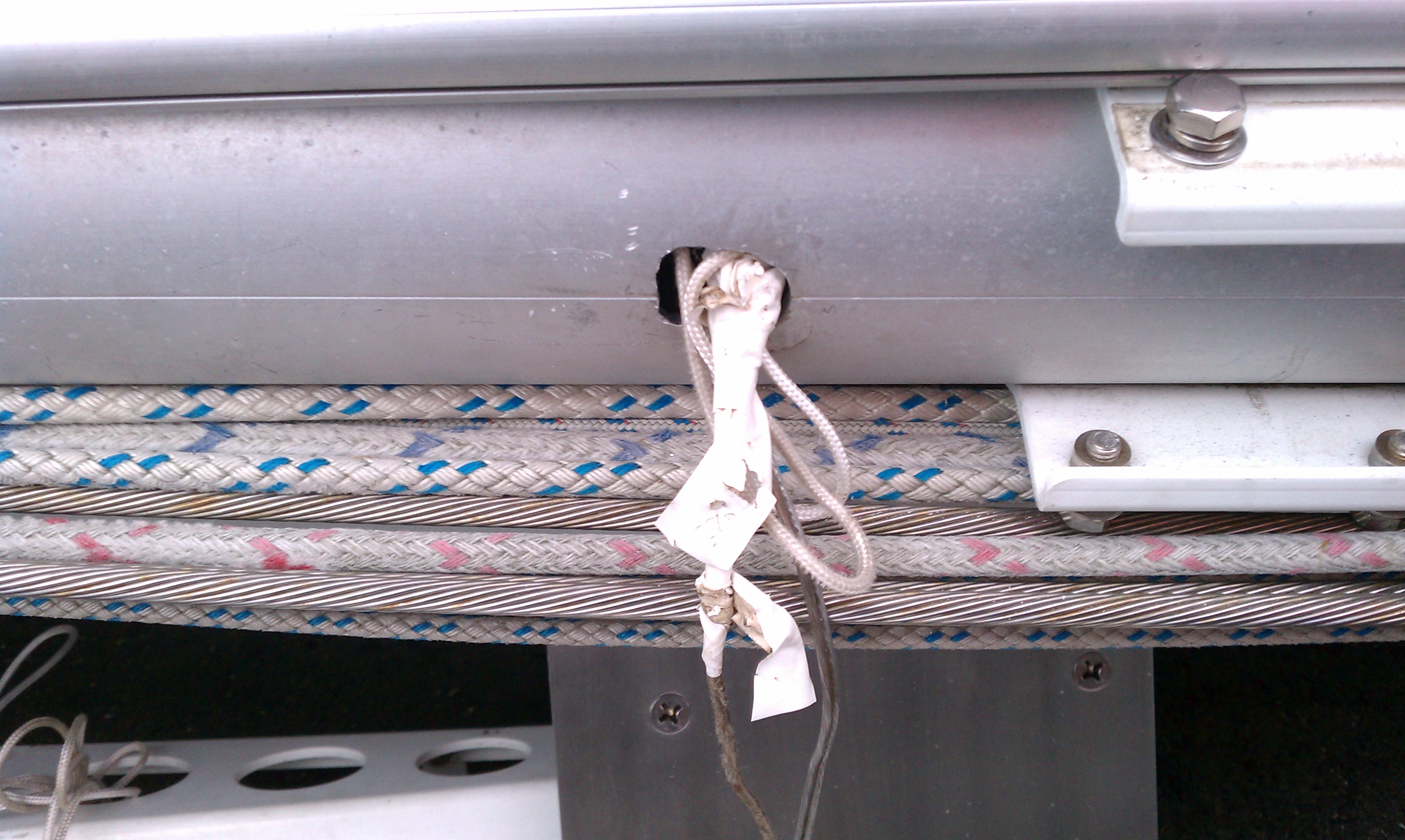

Attached are a few pictures from when I did my electronics upgrade.
Ron St. Onge
C36 MKII Hull1384
Ron St. Onge
When you cut the hole in the mast try to line it up between the pop rivets that go up the mast.  Use a very short pilot drill on your hole saw and remove the pilot when outer hole is established.  When you get to the pvc don’t press hard on the drill or you may push the conduit off the pop rivets.   Now you can feed your wires directly into the conduit and if careful haven’t damaged any insulation one the wires currently in there.  If you damage the insulation liquid electricians tape should fix it.
