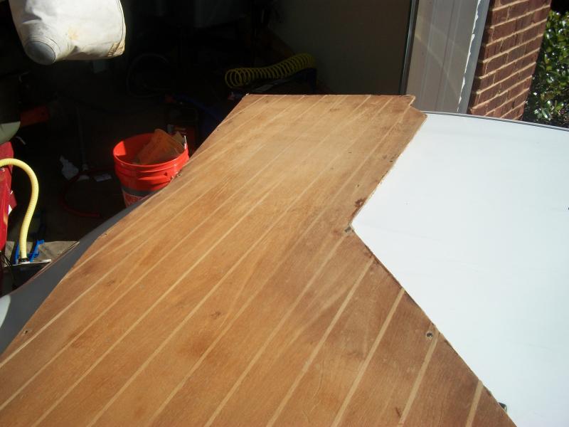

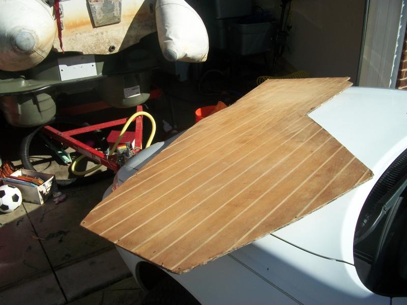

Please take a look at these pics and let me know what to do to refinish the board. I stripped most of the coating but I have this big grey spot where the solar vent had been leaking on the sole. Do I need to try to stain the whole board? I haven't done anything except stripped with Klean Strip. It looks like grey teak that has been in the sun.
The original boards are not stained before they varnish them are they?
I am pretty sure these stains or damaged places will show through any clear coat or varnish.

That's a tough question. If the entire piece seen in the pictures is already stripped, then it looks like the dripping water had destroyed the original finish and penetrated into the veneer. If that's the case, then matching it up could be a challenge. You might try a teak cleaner/bleach followed by a light sanding with a random orbit sander; I'd use a 400 grit or higher, since you don't want to sand through the veneer, which may be quite thin. Staining would be complicated by the fact that there are two quite different species of wood, one almost white the other brown. Any stain would tend to hide that. Gel stains are great for hiding things like the green, purple and brown grain in poplar, but again, would tend to hide the teak and holly contrast. You could try an amber shellac, which I've used successfully to match patched in pieces on an oak hardwood floor with the 30 year old finish on the rest of the floor.

Yeah maybe I will just light sand and use some sort of varnish on it. It will look better than it did before I stripped the old clear coat off.
The boat is an 1984 and mechanically and structurally sound as far as I know. I have had it for a year now and got it cheap. If I need it perfect I should have bought a new one....

Water stains can be iffy to get out but you will be surprised how much better it can look. As other s suggested after using paint stripper to remove all previous varnish, sand with a fine sand paper and wipe down with mineral spirits (paint Thinner). When you are doing this look at the areas that were grey you may find they have all but disappeared. If not a bit more light sanding and give the area another wipe, the paint thinner will mimic what a good oil based varnish will show. By using a paint stripper you are also causing some changes to the wood that help breakdown the water mark. If you think it is good apply an oil based finish. The last time I was given a good buy on some professional floor varnish. Use semi gloss or gloss depending on your preference.

Thanks all! I wet it with some stripper and it looks better good wet. I will clean with acid and try again. Apparently the acid acid is good for cleaning rust stains so I need it for sure.

I had a similar problem and I found once the wood got penetrated with water there isn't much you can do to stop it. If you have any specs of black in it, start over with a new piece. After two such problems, I switched to vinyl.

after bleaching whole board.

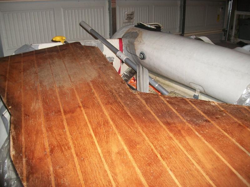

One of mine was delaminated about 4 inches in almost the whole way around the board. It was delaminated in 2 layers also. I put epoxy on a plastic knife and slopped it all over inside and built up the damaged screw holes also. clamped using a long board and c clamps. Seems to work well.

Thanks, Mike. For minor delaminations, I agree that would work. I have several sections that are now falling apart completely.
The replacement is for two reasons. The delamination is one and the deteriorated finish on the decorative side is the other. I am confident it will look good as Chuck Parker attests.

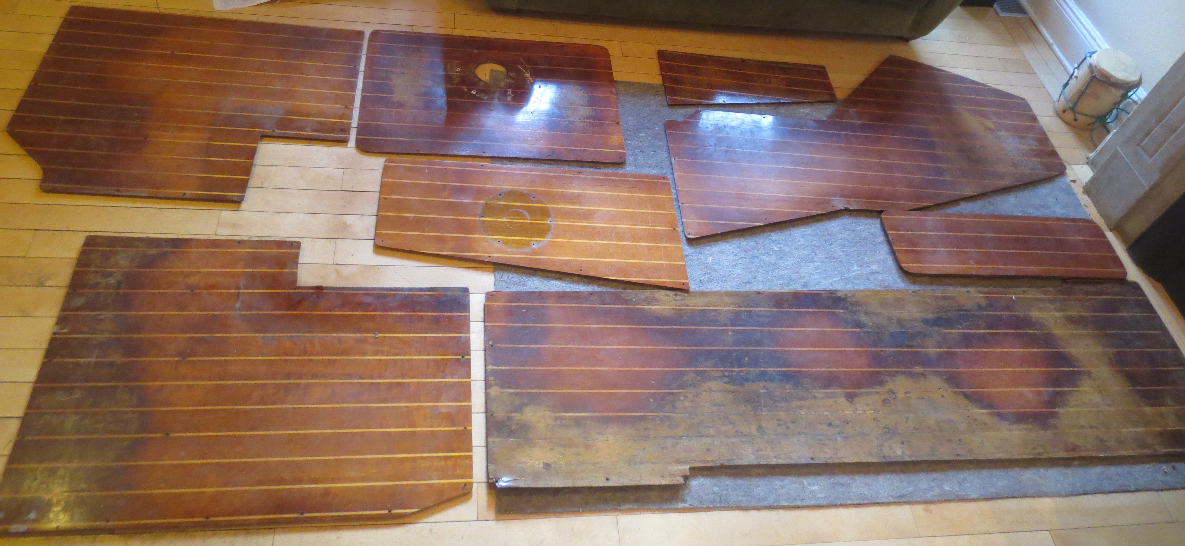

FYI - I got started on the sole board replacement this past weekend. I really respect what Chuck Parker must have gone through.
I guess the severe delamination on some of the boards made it tough to get an accurate profile, so I wound up taking the boards on and off the boat 3 times to dry fit them adequately.

It is a big job making new ones or refinishing old ones. I got a heat gun and used it to strip the rest of my boards (seems better than stripper). I removed most with heat gun and then hit the board with stripper to get any spots i missed. Stripper seems to dry really easy and it takes a lot plus it stinks and is toxic.
They look worse than the one I posted. The bleach and sanding didn't really help much either. I will recoat them and put them back. They will be way better than they were but I have other projects which will offer more "bang for the buck" than buying new floorboards.

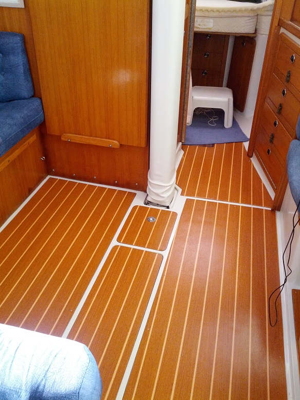

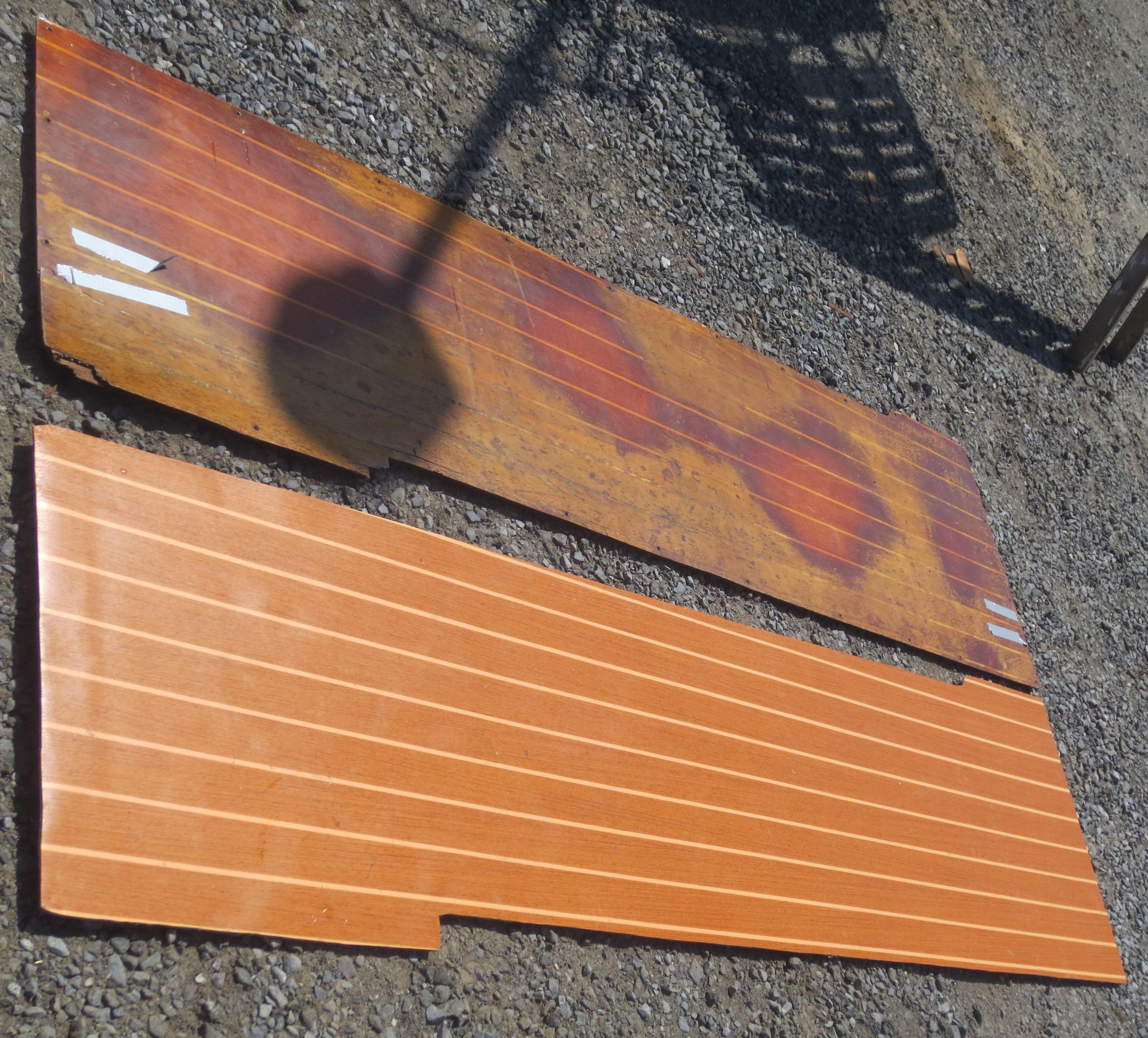

I have the epoxy curing on the new boards now and have installed the vinyl on the two bilge covers. With luck I will be done by Sun and ready for our New Year's cruise starting Mon.
Job is essentially done. Two pics show delamination of original boards, and new boards with vinyl Teak and Holly applied.

Beautiful job!

Duane,
Those floorboards look REALLY nice!
Thanks, Joe and Tom. I owe a lot to Chuck Parker for initial instructions and encouragement.
Yup, looks awesome Duane

Are all the sole boards covered with synthetic veneer? I'm really taken back by the de-lamination of your originals, never seen anything like it. Very nice job, sole looks beautiful!
Posts: 612
Duane... your delaminated boards looked like mine when I started the vinyl project. Yours look great.. got the holy stripes lined up much better than I did on mine... thank god for area rugs.

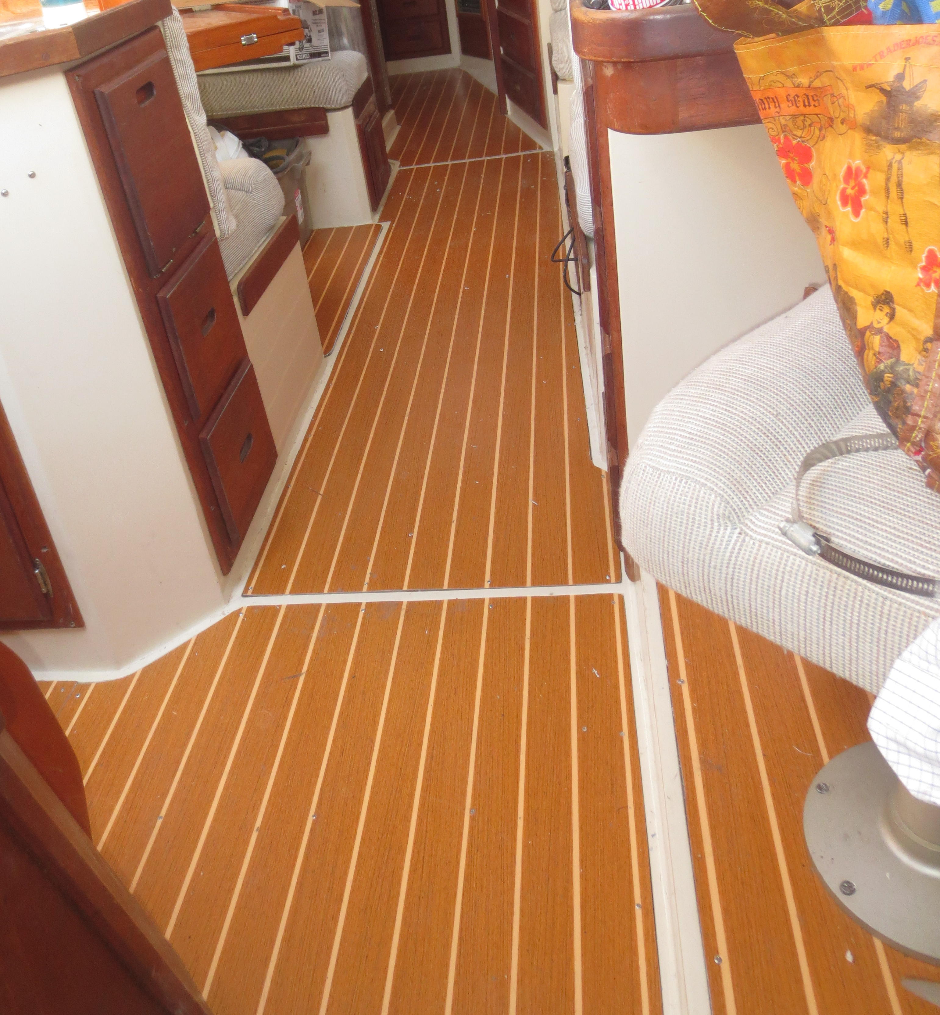

   I did this replacement as well over the past winter; like Duane's (now former) boat several of our boards were totally delaminated.   Its no small job by any means.  Chuck Parker's ("Pierview") written instructions were very helpful; I'd offer only the following one amendment/advice, which is to use West system epoxy for the final gluing. (We also used it to seal the 1/4 marine plywood, maybe 5-6 coarts each side).
   The proprietary epoxy that Lonseal sells with their vinyl flooring must be mixed all at once (a gallon!) and then applied and the pieces laid within 30 minutes, according to their instructions.  We found that the Lonseal epoxy "kicked" on two of the boards that were in direct sunlight in far less time, before we'd laid the vinyl on them, and we ended up had to scrape off all the glue and start over.  However, Lonseal's instructions also state that West System epoxy can be used (wish I'd know that before I bought it), and we found it was much easier to work with (because we could mix up more manageable amounts) and actually had a much better grip on the vinyl than the Lonseal stuff.  We also rented a 100 pound floor roller (as Lonseal recommended) to roll out the floor.
   Believe me, doing one piece at a time using West System epoxy, rather than trying to rush through setting all 8 pieces (on a Mark I) with the Lonseal stuff, is far preferable.  Lining everything up carefully takes time, and particularly with the larger pieces being laid into epoxy, and trying not to get the epoxy on the upper side of the vinyl and/or on yourself or underfoot.... well, you get the idea.
   Below are some before and after shots.  I won't say it looks as good as the real teak and holly stuff, but it looks far better that what we had.
