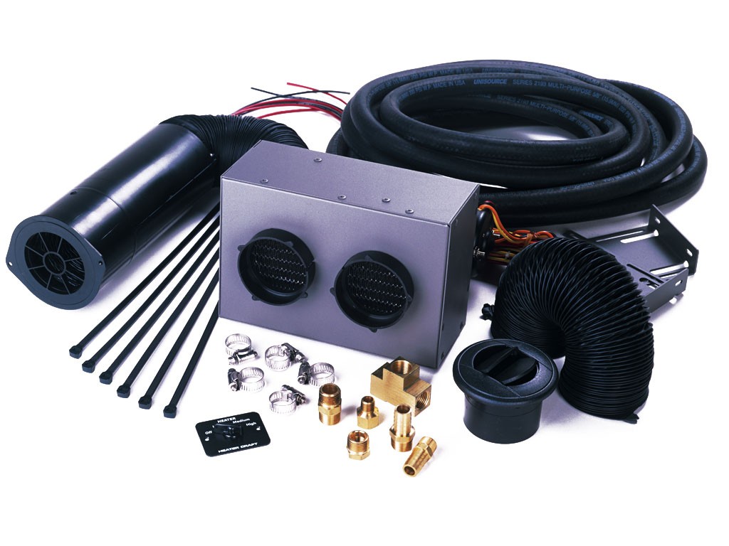

Funny; I just finished installing a heater of this type in my C36 - [url]http://www.heatercraft.com/marine-heater-kit-with-2-euro-vents-complete/...
This one shows the full kit - I purchased the hoses and fittings separately which cost me substantially less...
I installed it below and fwd of the sink and plumbed it in series with the hot water tank.
Works great for us in the PNW.
