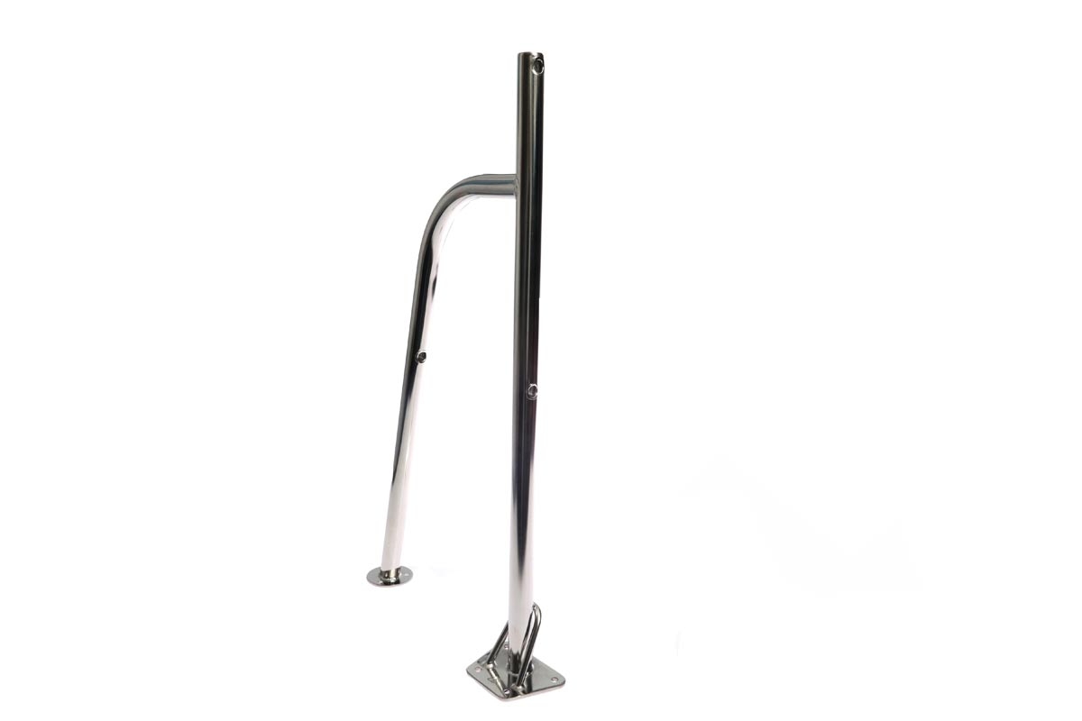

       Ah yes.   Our boat is the same vintage, and a few years ago, when I replaced the life lines, I decided to upgrade the aft-most stanchions to true gate stanchions  (like those next forward), since they get a lot of stress  (which may be why you have leaks) and are easily bent.  Catalina Direct sells them, see photo.   Anyway, I digress.

David, Most likely, the Garhauer Marine stanchions ARE the original factory stanchions. The standard stanchion base for our year boats is the ST58 with flat top. The ST52 in the photo I added to my earlier post, is the beefed up version with thicker tubing and raised welded bases... but also has square holes for carriage bolts (or I guess you could use round bolts into square holes). That one works well with carriage bolts for the Port stanchion that you can not easily reach to put on vise grips if working solo. I replaced my cracked stanchion with new aft gates, Port and Starboard. I used regular parallel gate on Starboard side and beefed up version on Port side and other than the carriage bolt head vs round phillips head, and the slight beefier raised weld, you can not tell them apart sight or touch. Garhauer is very freindly and easy to work with, just call Mike at 909-985-9993 or email info@garhauermarine.com and tell them what you want. They can mix and match bases, tops, etc. Also, that photo of the gate in post #2 with the angled brace leg is more money at Garhauer than the one with parallel leg. I used standard tubing gate with parallel leg so it didn't stick so far into stepping deck area and it was only $105. I think angled is $130 or 160?  So my forward gates are angled and aft gates are parallel.

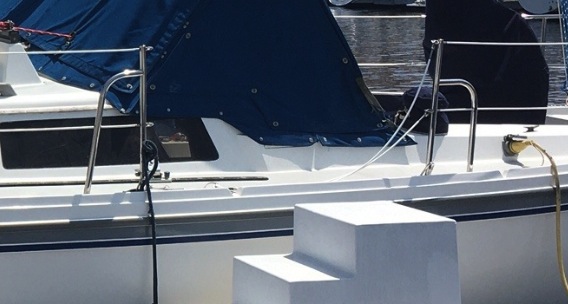

For anyone wanting to avoid the expense and PITA of replacing the aft gate stanchions, I came up with this cheaper, although not foolproof (still can rock side to side a bit, but not much).  Two open-jawed 1" fittings on each side and two lengths of SS pipe.  I removed the aft section of lifeline and simply put a SS nuts and lock washers to hold the back of the short gate-piece of life line, capped with a SS cap nut.
