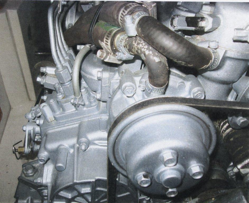

This is a very timely post as I planned to replace the coolant on my 2005 M35B next weekend but a little unsure for the first time.
Firstly, I planned to drain the coolant by removing a hose from the heater being the lowest point in the system.
Then as described in the attached post by Stu Jackson, I planned to remove the lower hose from the thermostat and fill with a funnel until coolant came out of the thermostat where the hose was removed. I've aded a photo of the set-up on my engine.
I guess the butterfly valve on top of the thermostat is an added point where air may be purged but with care if the engine is hot.
I would appreciate confirmation of this approach. There is a lot of corresppondence on this topic on the various sites and a few horror stories.

I followed Stu's advice the last time I replaced the coolant.
I filled through the cap on the manifold, then closed the cap. I then removed the small diameter coolant hose at the thermostat housing and raised it up so it was the highest level and slowly added coolant through a funnel. Air purged from the system as the liquid ran down the hose and when it was full I put the hose back on with minimal spillage.
I ran the engine to normal operating temp and verified no cooling issues under load.
