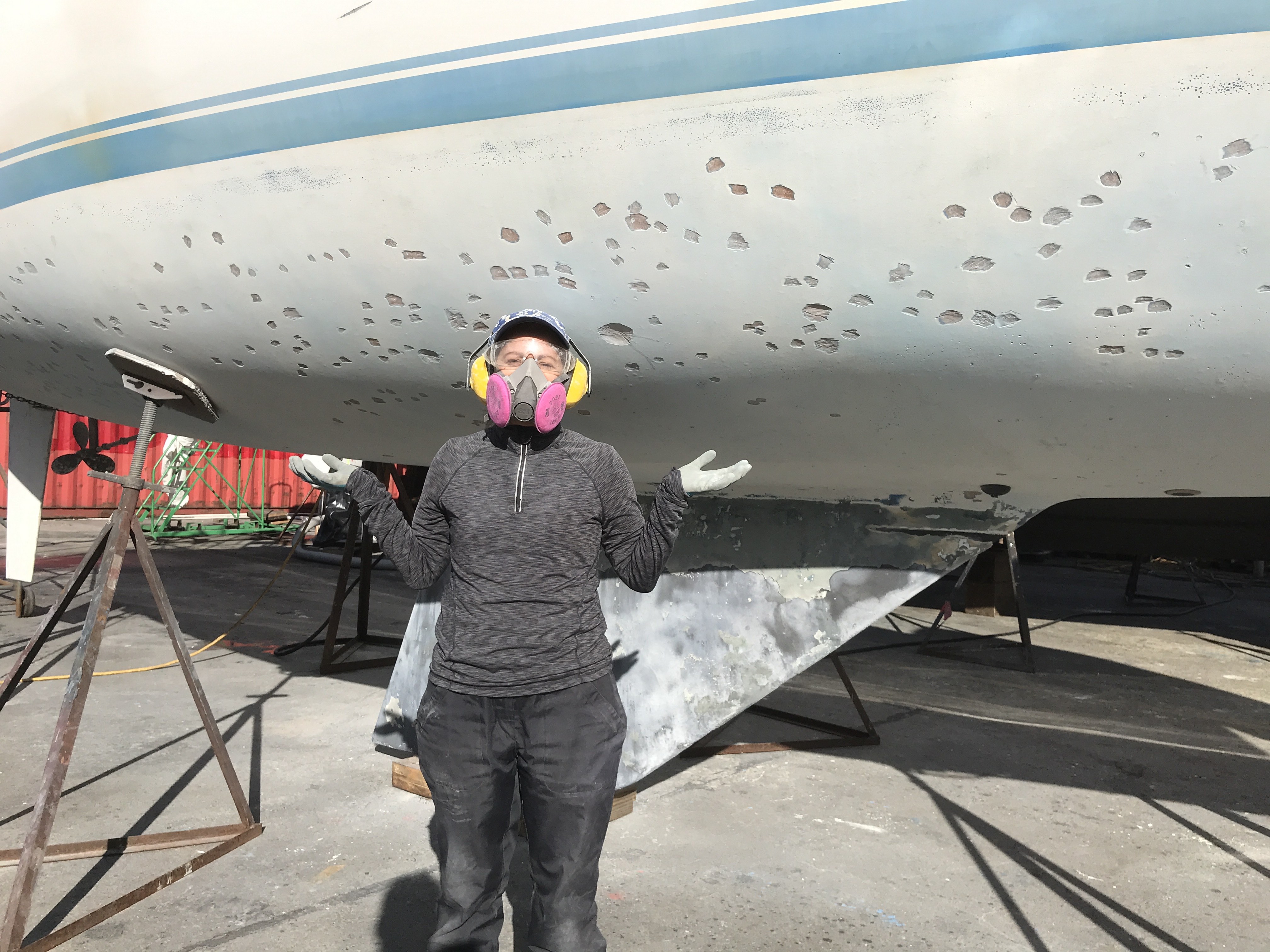

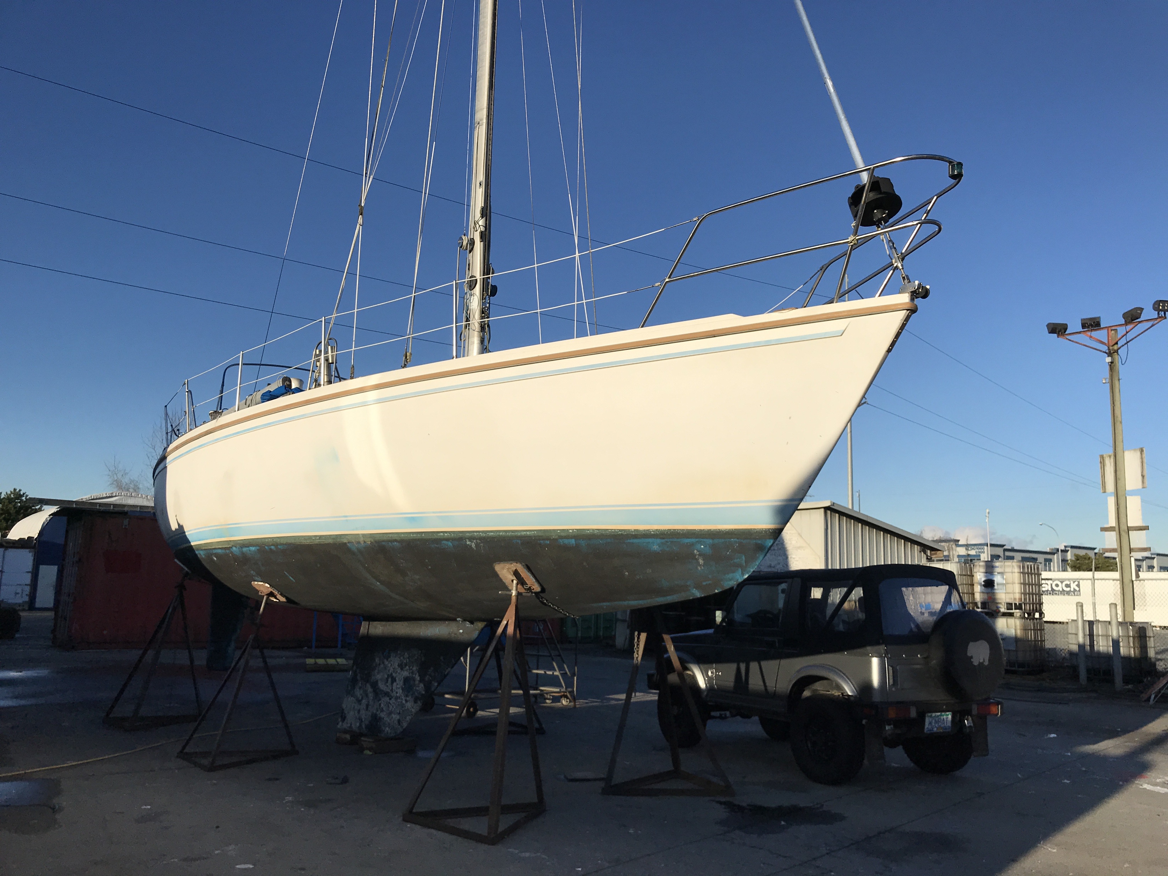

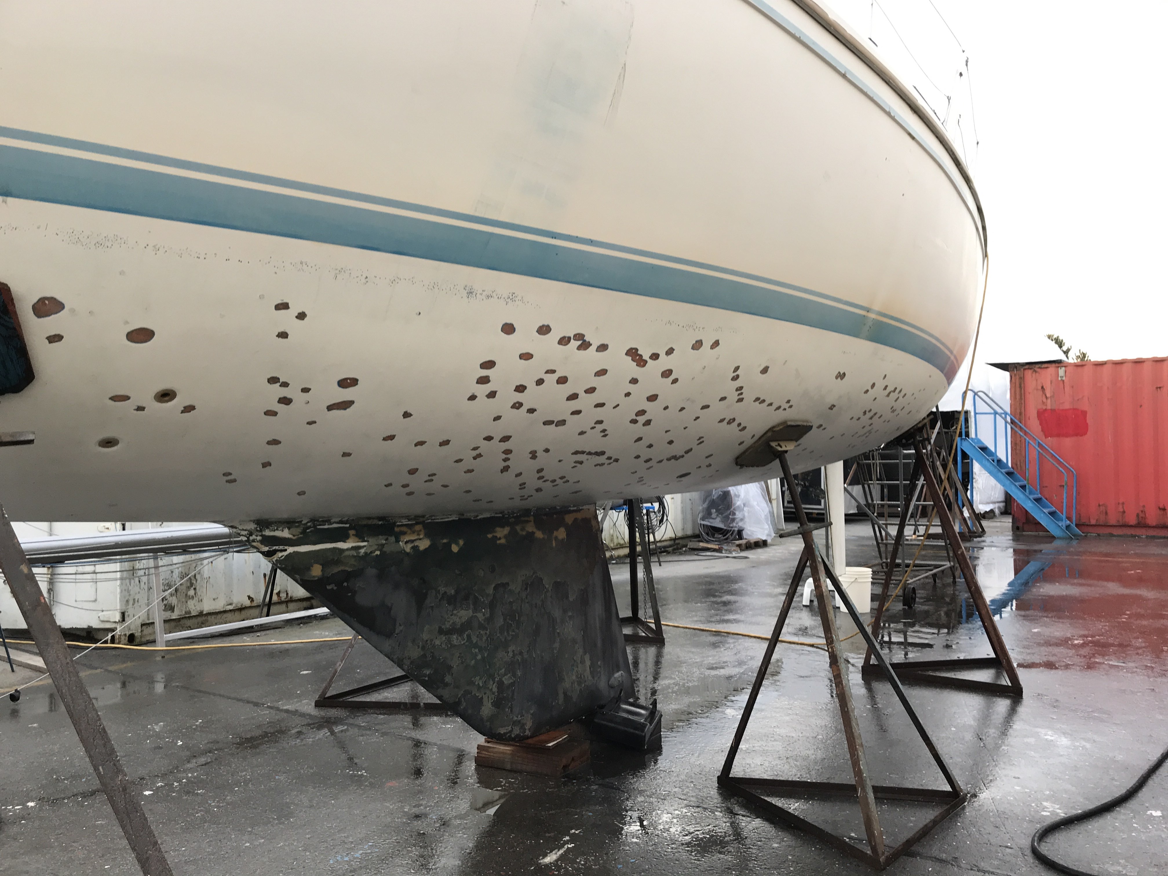

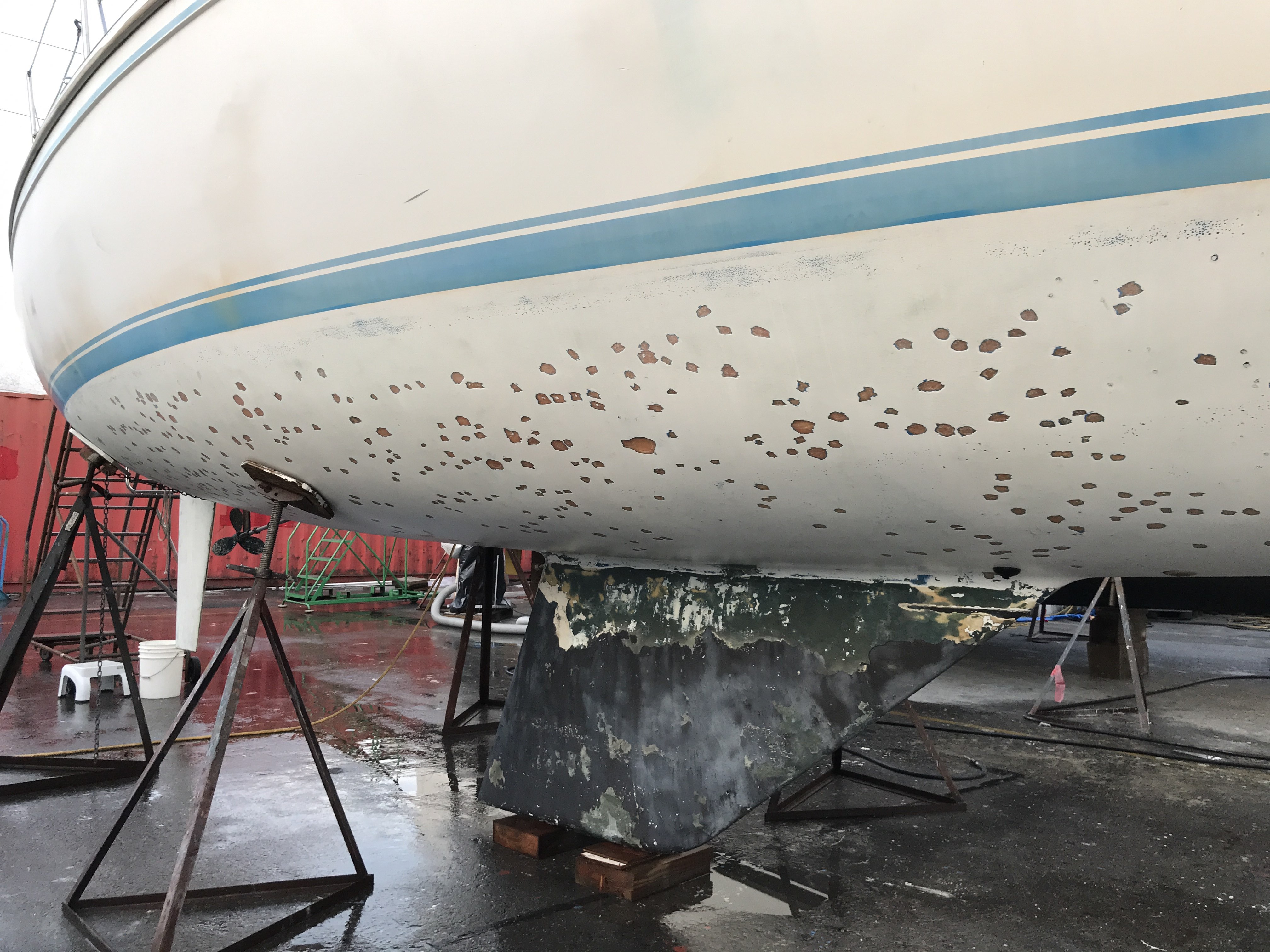

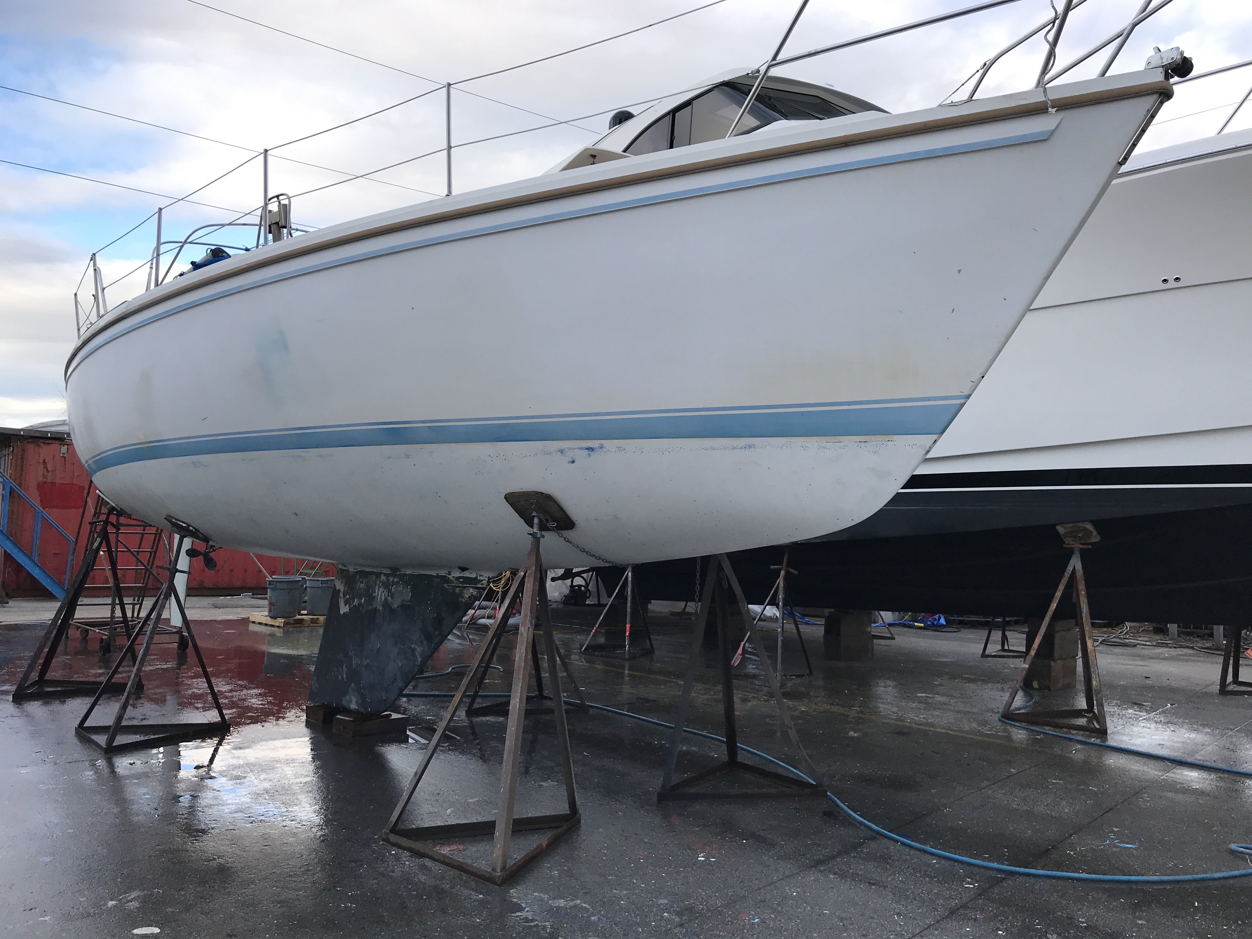

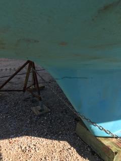

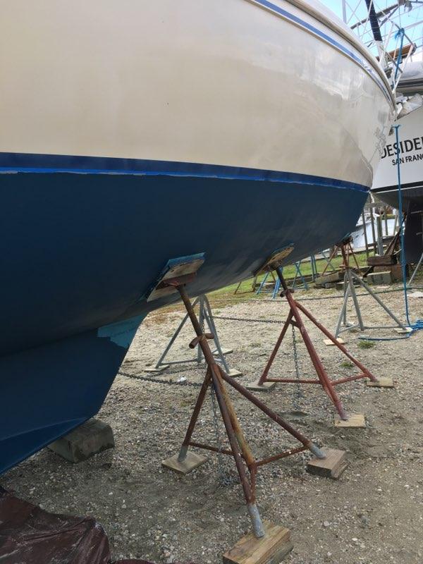

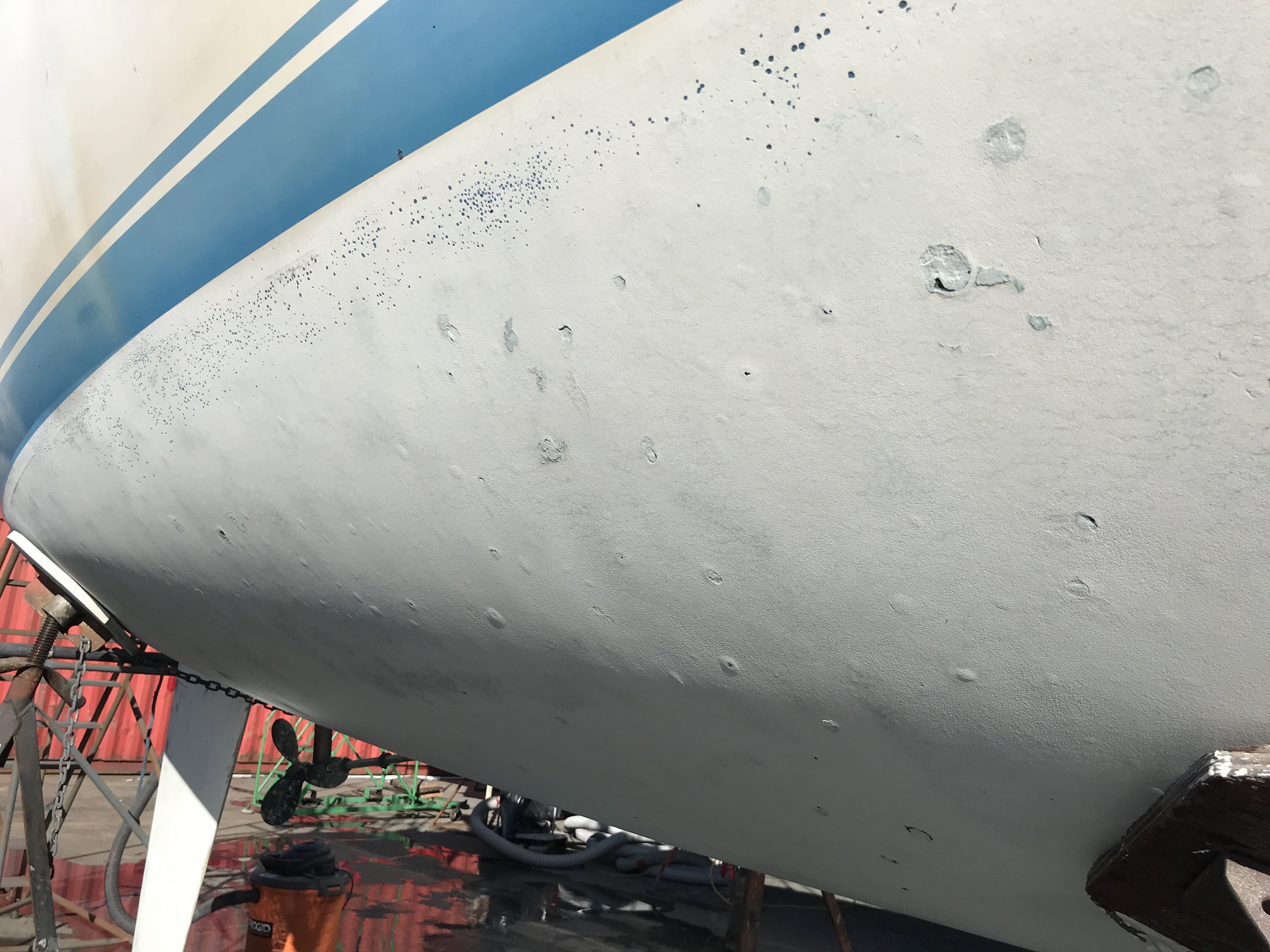

Well, we have the boat up on the hard and I planned to do a decent sand to remove the most recent bottom paint, then put a couple good coats on and away we go.

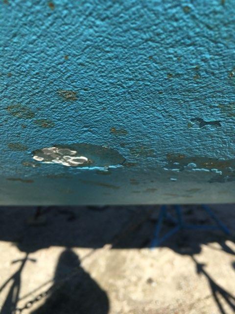

The surveyor did not report any blisters but of course there are hundreds of them.  In addition, there was no mention of the "smile" but now that I have had time to look at it, I see that it must have been an issue and poorly addressed at some point.
I have limited experience with boats and bottom painting and as such I have a number of questions already.   Time to turn to the experts....
I do not wish to pay thousands to have the bottom completely stripped and left to dry for months then re-coated.  I am quite prepared to do some serious sanding and try to get at least most of the old paint off and see what shape the hull is actually in.  How do I tell what is bottom paint, barrier coat or gelcoat?
So far the top coat is black, then something rusty coloured and beneath that a light blue.  I think the white that is showing through under the blue is gelcoat (please correct me if I am wrong).  If I sand until I have mostly blue does that seem reasonable?  I have 2 gallons of E Paint SN1HP.  Should I be putting something under it?
Some of the blisters were sort of fixed previously and they show up as white spots.  There are many more that I will attempt to deal with another time.  There are also a few bigger spots that I can't explain, maybe the gel coat is completely gone and it's just exposed fibreglass.

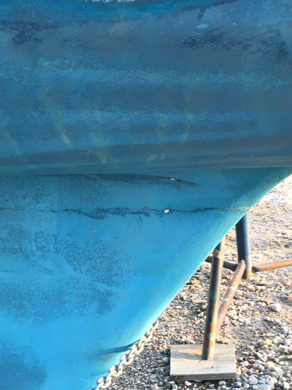

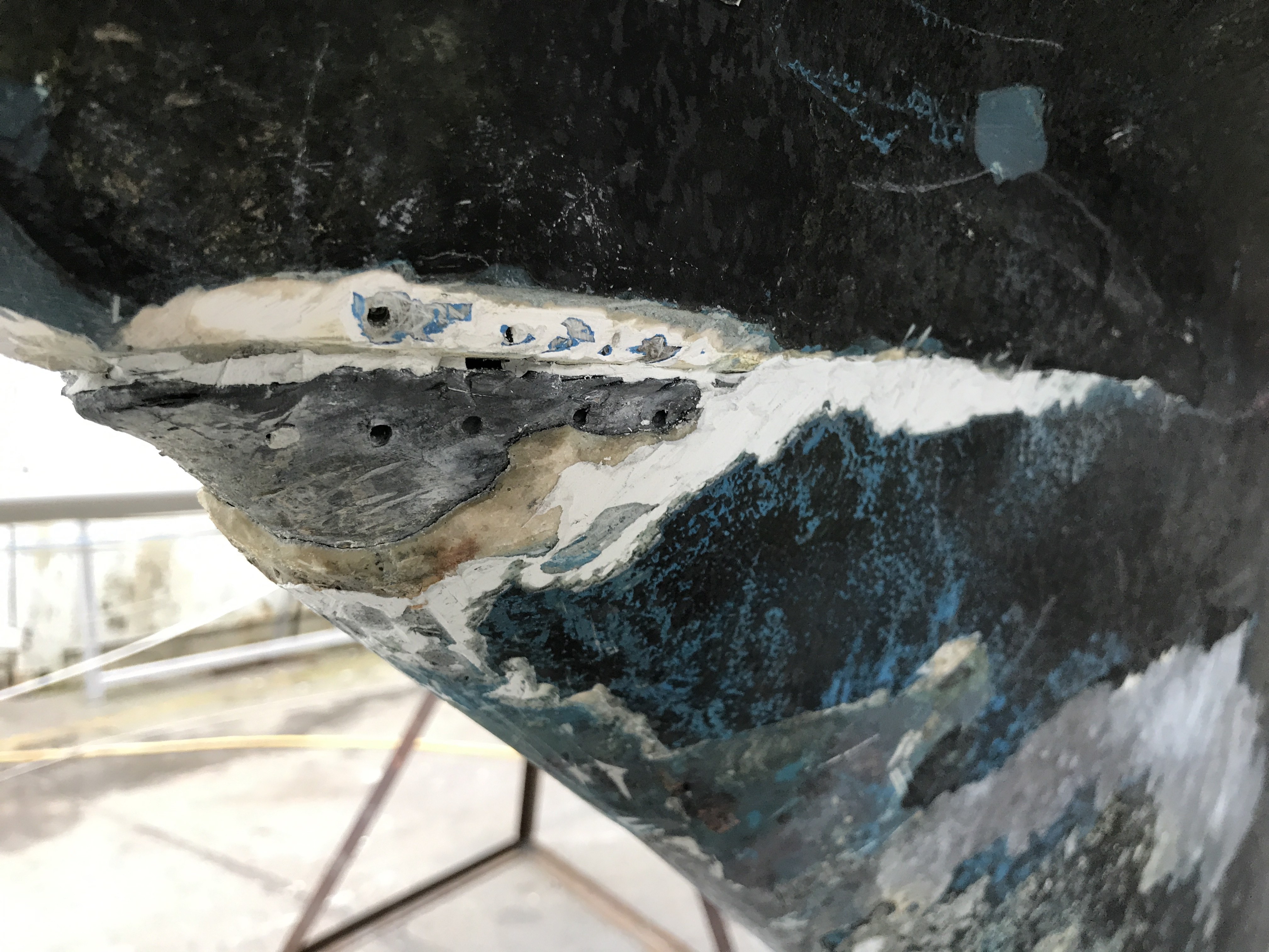

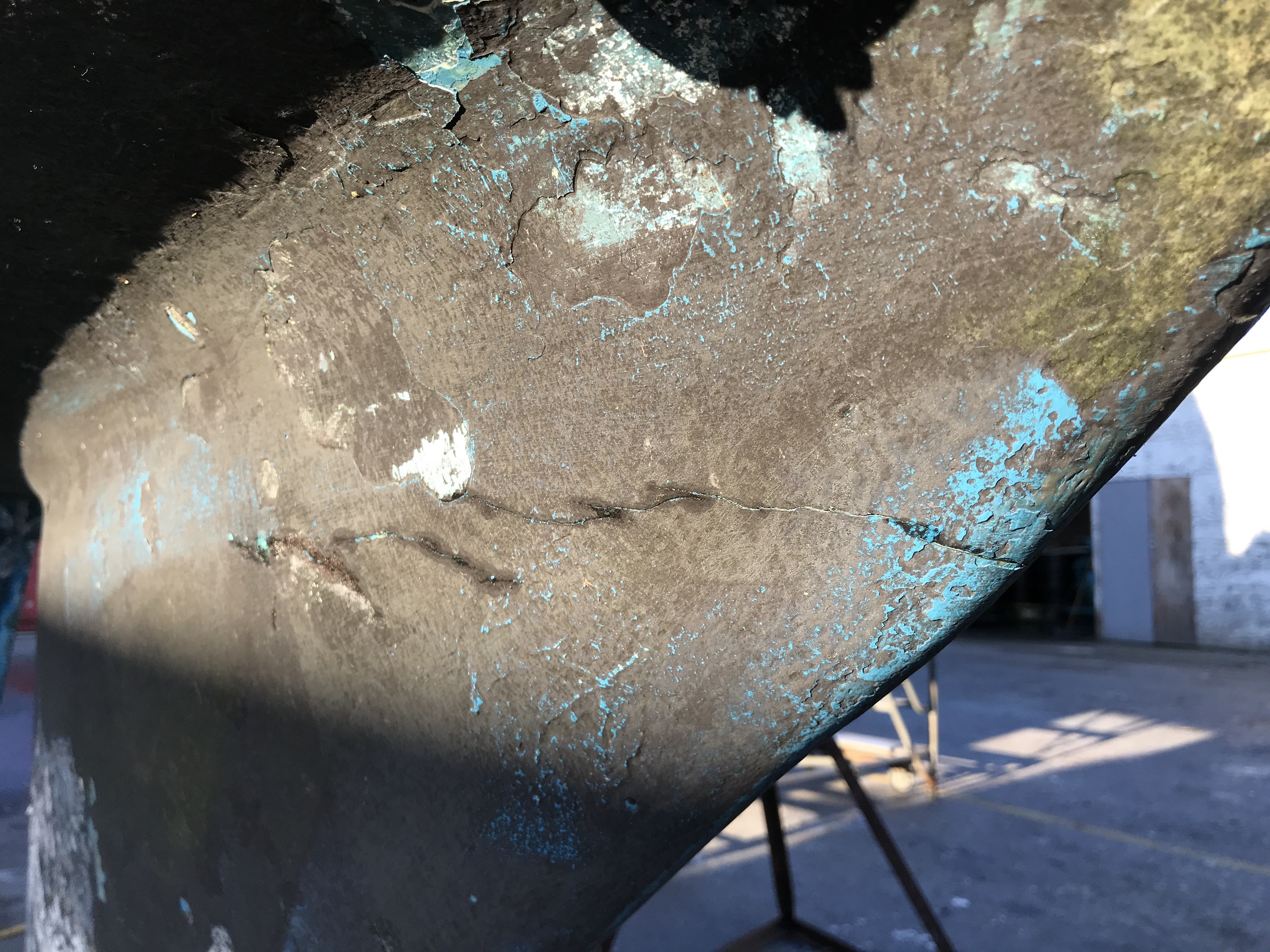

The smile is not visibly open and it actually looks like a ridge of thick paint or gel coat portside with a jagged crack starboard.  I'm not going to worry about that right now either, the bolts look good and snug but we will check to make sure they are correctly tightened.

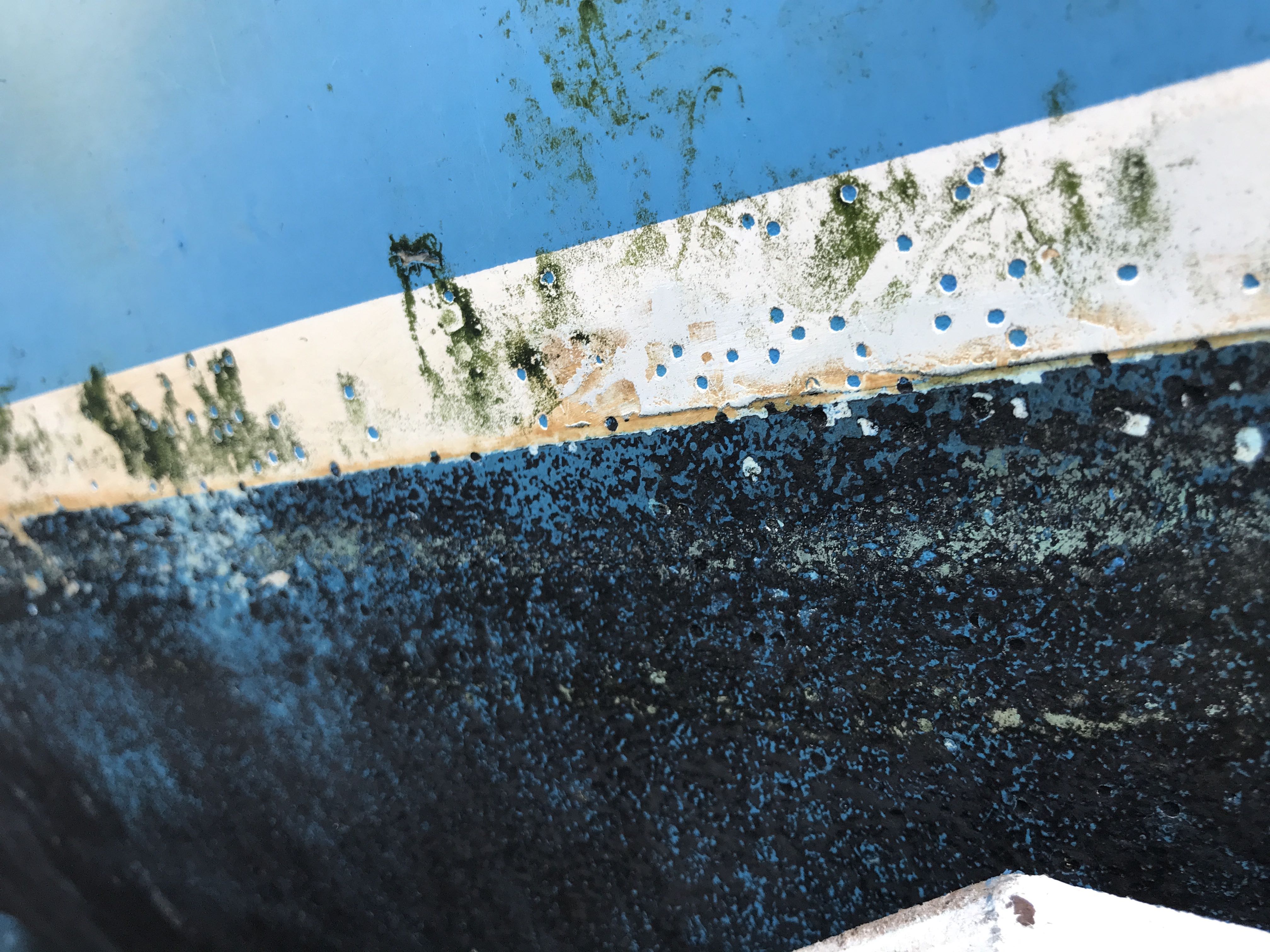

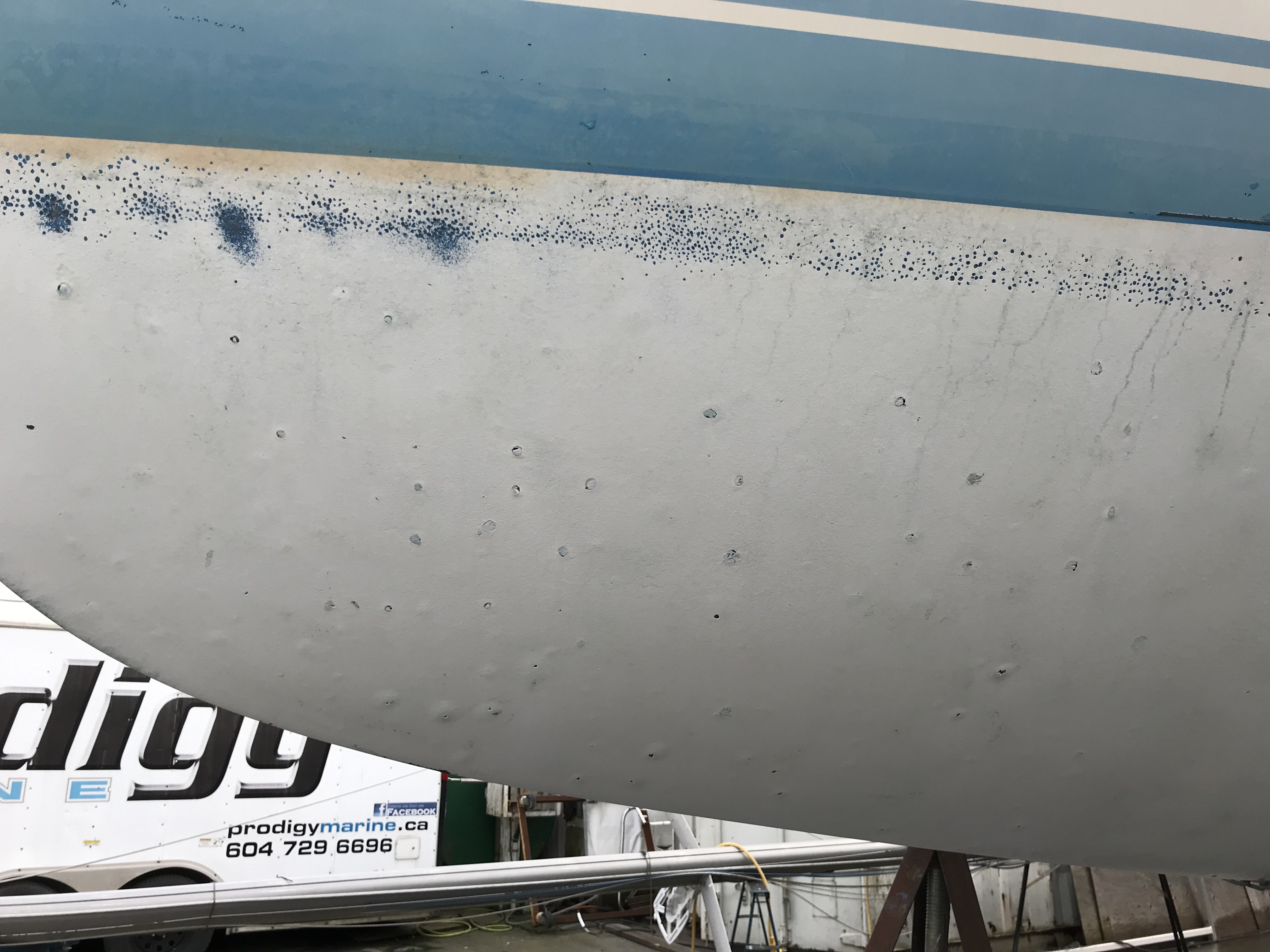

In addition, there are little pockmarks all along the waterline, well most of it.  They only appear to be in the paint/white stripe and quite shallow.  I am assuming that this is not something that I need to panic over and I could just fill them all and sand smooth then repaint.  I can't seem to find anywhere that can explain what causes this.
Thanks in advance for any and all assistance.  I don't plan to fix all the problems at once but it would at least be nice to know what they are.....

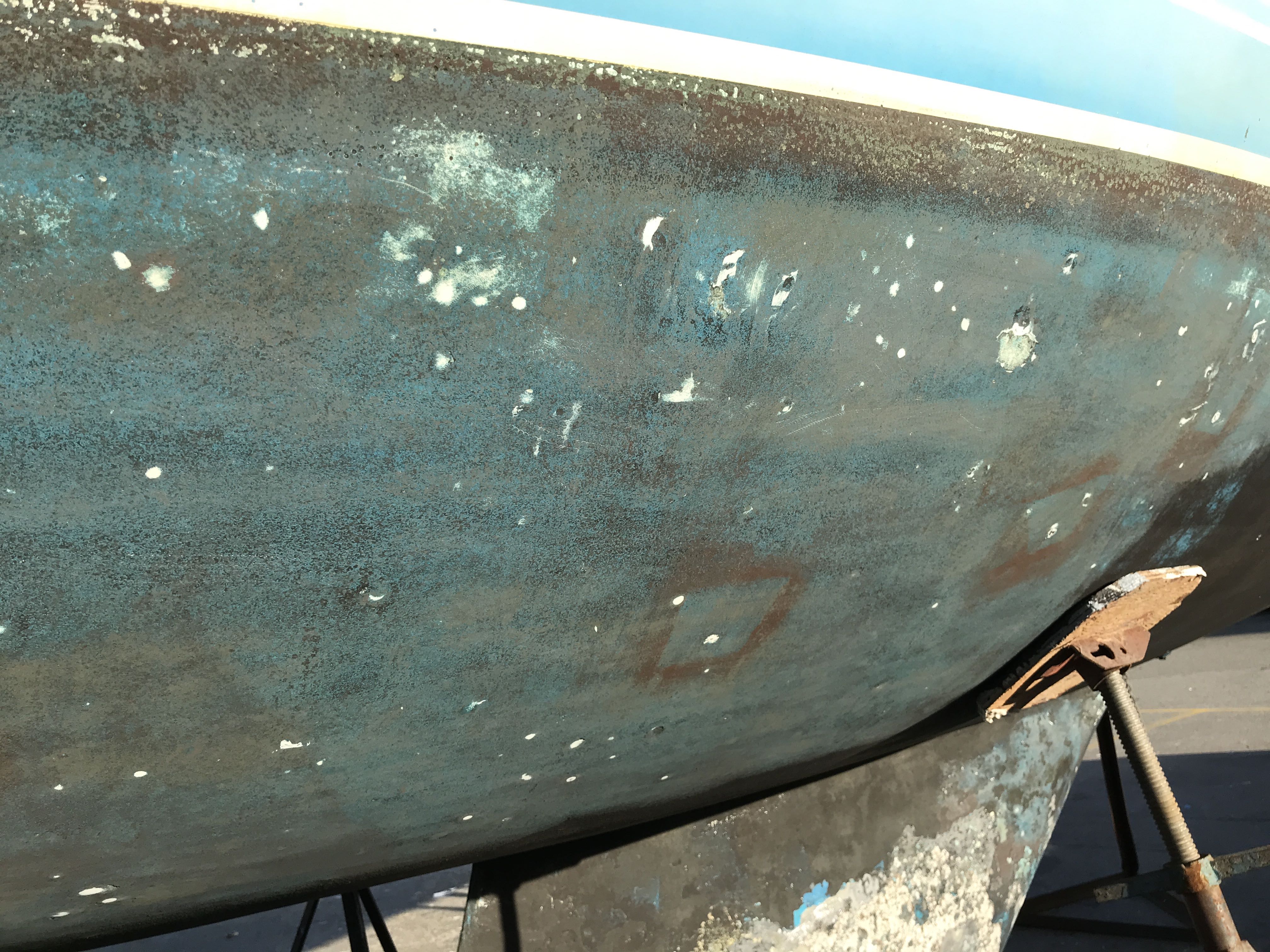

Are you sure you have blisters and not just adhesion issues with the bottom paint?  Blisters will be raised and  contain fluid when pricked.
Stripping bottom paint, in my opinion, the least fun job of all boat work. I would advise getting a quote and at least considering it. Those guys usually have the right tools. Iv'e used stripping chemicals, chemically treated adhesive paper, scrapers and ultimately decided that a grinder was the solution that worked best for me. Hours and hours and hours later, (spanning many days) I was  covered with black dust and covered the neighboring boats with grime too. For that reason, most boatyards require a collection cloth and plastic drapes to enclose the boat and capture the paint chips...and you should ware a face mask dust respirator and Tyvek clothing.
To apply a barrier coat, all the bottom paint needs to be removed.
Your "Catalina smile" is the largest I've ever seen. You should check the torrque on keel bolts, especially the forward ones beneath the cabin sole (remove the sole). I would also examine the bilge to see if the nuts on the keel bolts are depressed into the bilge (from over torquing, lack of washers to distribute force, sever grounding causing separation of the keel etc.) There might be someting structural going on . If all looks well, in addition to retorqing the bolts and removing all bottom paint, I would epoxy several layers of glass roving- 8-10 inches wide around the hull to keel joint and then fair it in....then apply the barrier coats as the final steps.

I 100% agree with what was posted above. There is something serious going on with that keel. Hopefully it just had a hard grounding and a bad patch job earlier in its life and there is no structural damage.
I had a similar problem with chunks of paint falling off because there were too many ablative layers ontop of each other(Think it was like 8). I had it sanded down to last coat/ barrier and raised the waterline to combat all the barnacles there. coat and then went with interlux Micron 66.
My bottom looked fine when I bought the boat, it was on the hard for 2 years. I even applied a coat of ablative before it went in. but being in the water for 6 months revealed how bad a shape it was in. I had to bite the bullet and redo it.

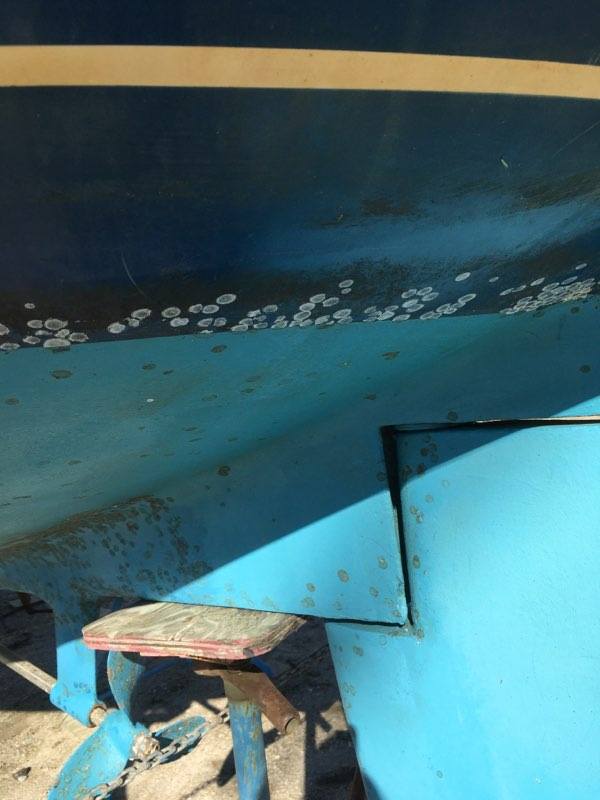

all those small dots look like someone scraped barnicles off and they took a layer of paint with them. Blisters are bumps filled with fluid, not the pockmarks like that

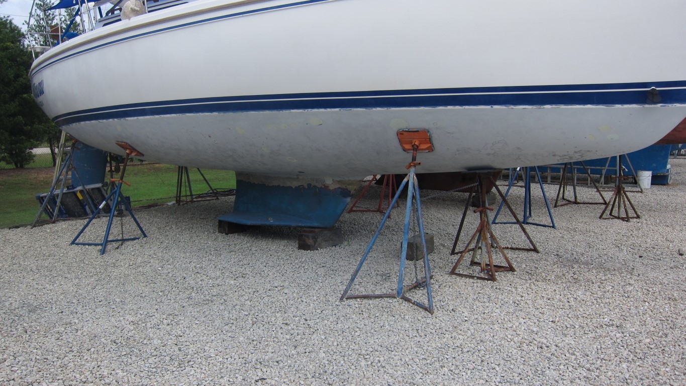

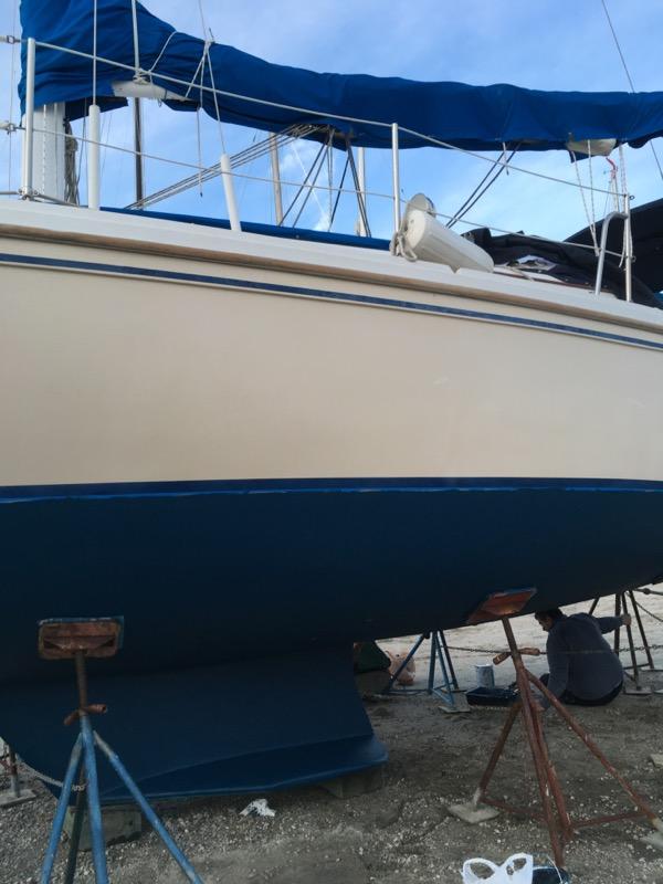

I attached some picks of before, sanded, and after. I put my catalina smile in there too so you can compare. I made sure to retorque and fair.

Thanks so much for taking the time to help me out.

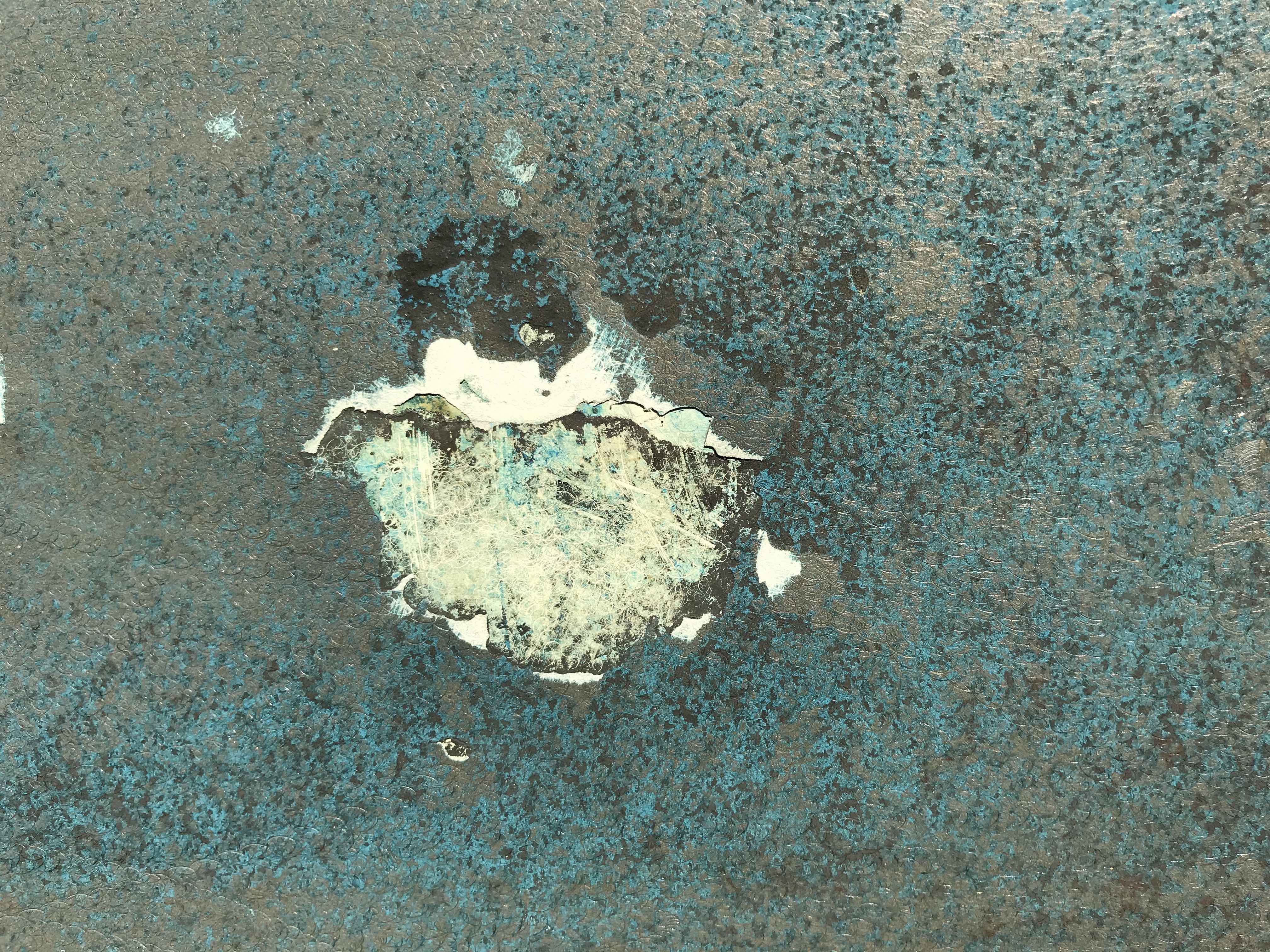

Yes, there are some spots where it is likely just bottom paint issues but I have found some blisters that definitely had liquid in them when popped.  I intend to sand the bottom as much as I can manage over the next few weeks, then put a couple good coats of bottom paint and leave the blister issue until we haul again, probably next year same time.
I am not sure about the small pockmarks, they do seem to be mostly quite uniform in size and small.  Not all the way around the boat, probably 3/4.  Only within 6 inches of the waterline.  Very odd.
As for the smile, I have no idea what went on under the layers of paint, filler and possibly gelcoat so I plan to just strip it all off and do a proper assessment.  Near as I can guess, the previous owner addressed the issue somewhat but didn't remove any of the coating from the keel.  When the bolts were tightened up, the coating pushed up on the sealant that was protruding from the gap and formed a bit of a shelf (for lack of a better word).  It does appear to be dry but until I take the very thick and solid layer off, I won't be able to tell for sure.  In the end I will be left with a bare keel and some idea of what else needs to be done.
The bolts appear to be in very good condition, there is no indication of deterioration or softness and everything is shiny and clean.  Once I have the outside cleaned off we can make sure the bolts are properly tightened.
Looking at your pictures my initial thought was the boat was shrink wraped. I noticed on a friends boat years ago that he had these small pox marks along the waterline and looked around at some other boats in the yard. It looks like when they heat shrink they may have applied heat close to the hull. Several boats in the yard showed these pox marks and some were still covered which led me to my conclusion.

Having done this by myself in the past, believe me, if you can find somebody to soda blast for $1600 or even $2500, write the check. Again, it's a miserable task to undertake. Just my opinion

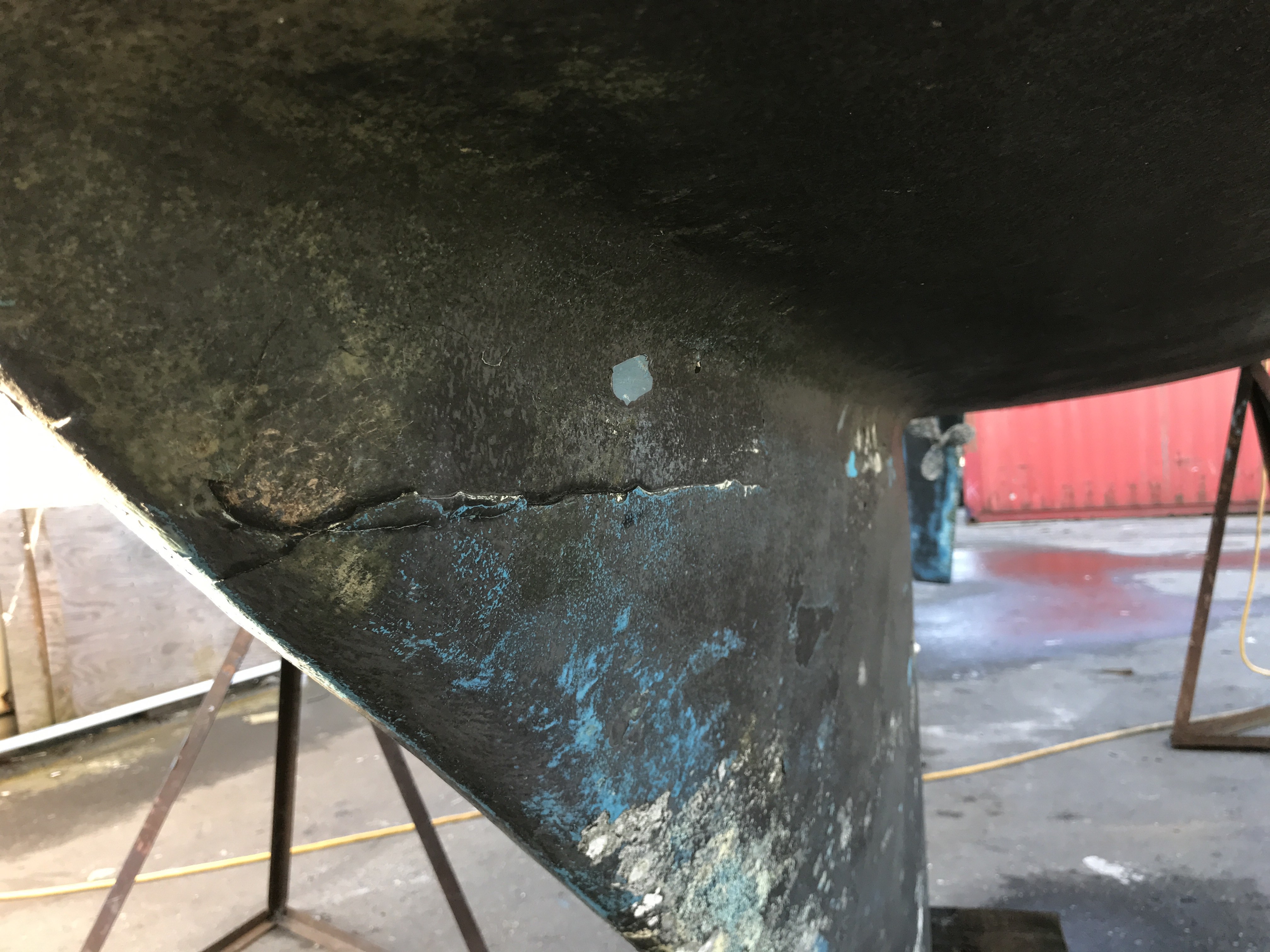

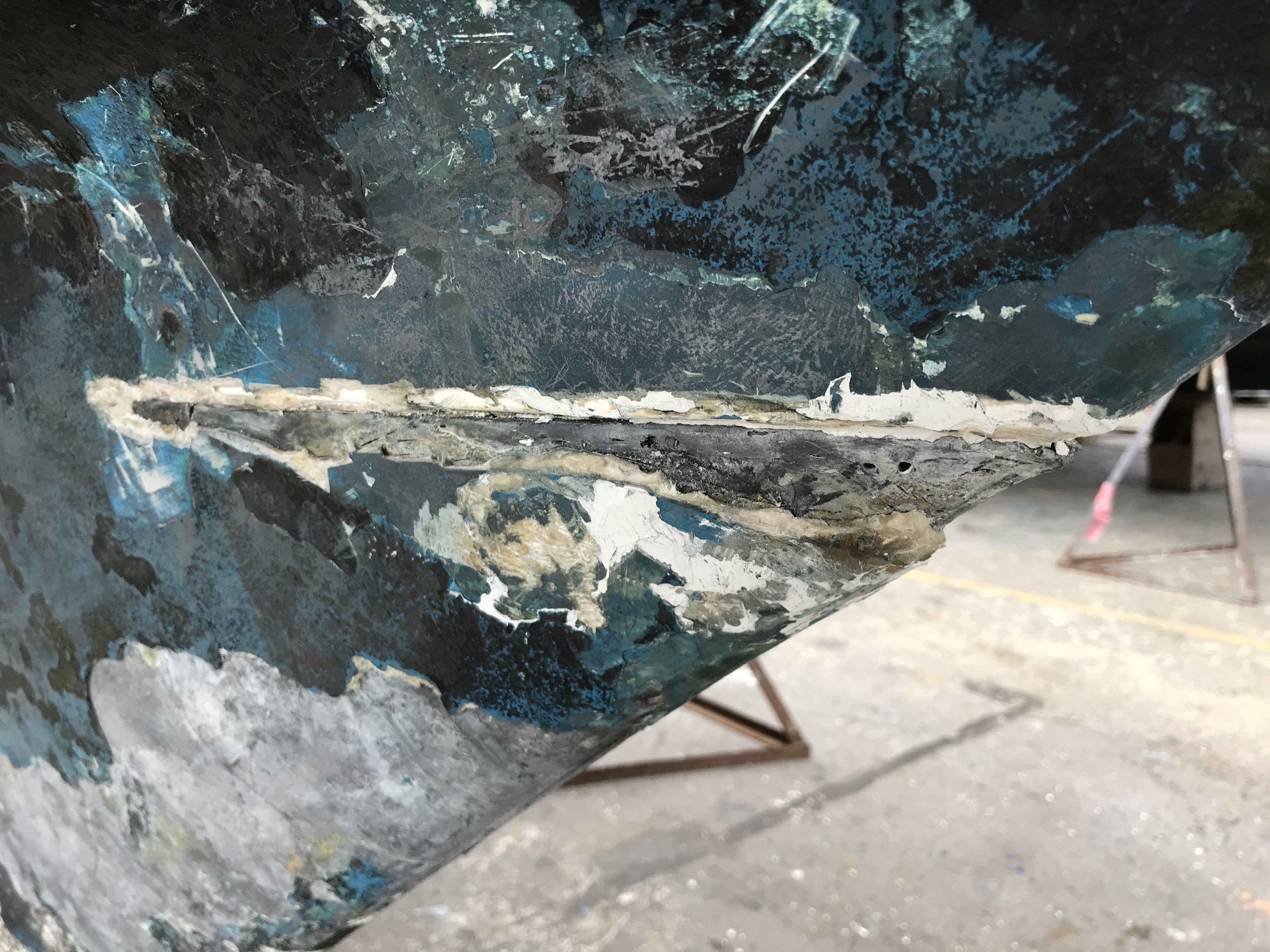

Well, a fun filled day today.  I spent some time digging out the filler on the front of the keel around the join to see if I can figure out what has been done previously.  John also checked all the bolts and found that they are tight and in good condition.
As for the smile....  it appears that at some point it was filled and then a thick layer of something was built up over the forward edge of the join and poorly finished then coated over time with a few layers of bottom paint.  The ridge of filler on the Port side still makes no sense to me.  As ugly as it looked, it was clean and dry inside with no evidence that water has been present and it was quite difficult to remove the filler.  I am confident that if I had not been banging away with a chisel and hammer it was not going to come loose or leak.  The wet cracked spots on the port side were superficial, the filler was fine.
My question for the day is one I really hope someone can answer.  What are the matching holes in the lead and hull for?  Is this normal or speical to my boat?
So, I think that I will just replace the filler that I removed and smooth everything out.  I've asked a guy at the yard to come and give me a quote on the soda blasting.  Even at $1600 that is still much more than I can really justify at this point.

   Regarding re-torquing the keel bolts:  You should know that members of the C36IA (at least those located in the USA) have access to various loaner tools, among them a set off special deep sockets and a torque wrench for the keel bolts.  I mention this because I was the last user and the tools have been sitting in my cellar for the past couple of years (as no one has asked for them to be passed along).
   There may, alas, be some duty or other issues involved in shipping them to members living up in the "balcony" section of the continent, so to speak  (sorry about that!), but perhaps if I sent them over to our fabulous Commodore Les Troyer, who I believe lives not far away in Everett (and who constructed a nifty box for the tools whne last in his paws), you could rendez-vous.
PS:  As to your "question of the day" I can answer the second part by reporting that I've never seen them on my boat or any other C36 hull (there's usually a few others in the yard when we get hauled for the winter).  As to the first part, I have no idea what they are for or from (worms don't usually attack lead).

Could the previous owner have tried to attach the two halves with screws and metal braces that have rotted away? I'm mystified as well.
Maybe reach out to catalina?

Another fun filled day behind us.  We may have an answer to the question of the holes in the lead and hull.  Theory from boat yard folks is that they were intentionally drilled to assist the filler in finding places to adhere too.  I'm not entirely sure I believe it but have no better ideas to suggest.

The holes may be there to give the filler a good grip on the keel.
Posts: 740
I agree with Les.The lead keels are encapsulated with gel coat. When an area flakes off and exposes the lead. It's almost impossible to get anything to adhere . I did some repair work on a C30 keel and the only way I could get epoxy to stick was by drilling holes at different angles and filling them.

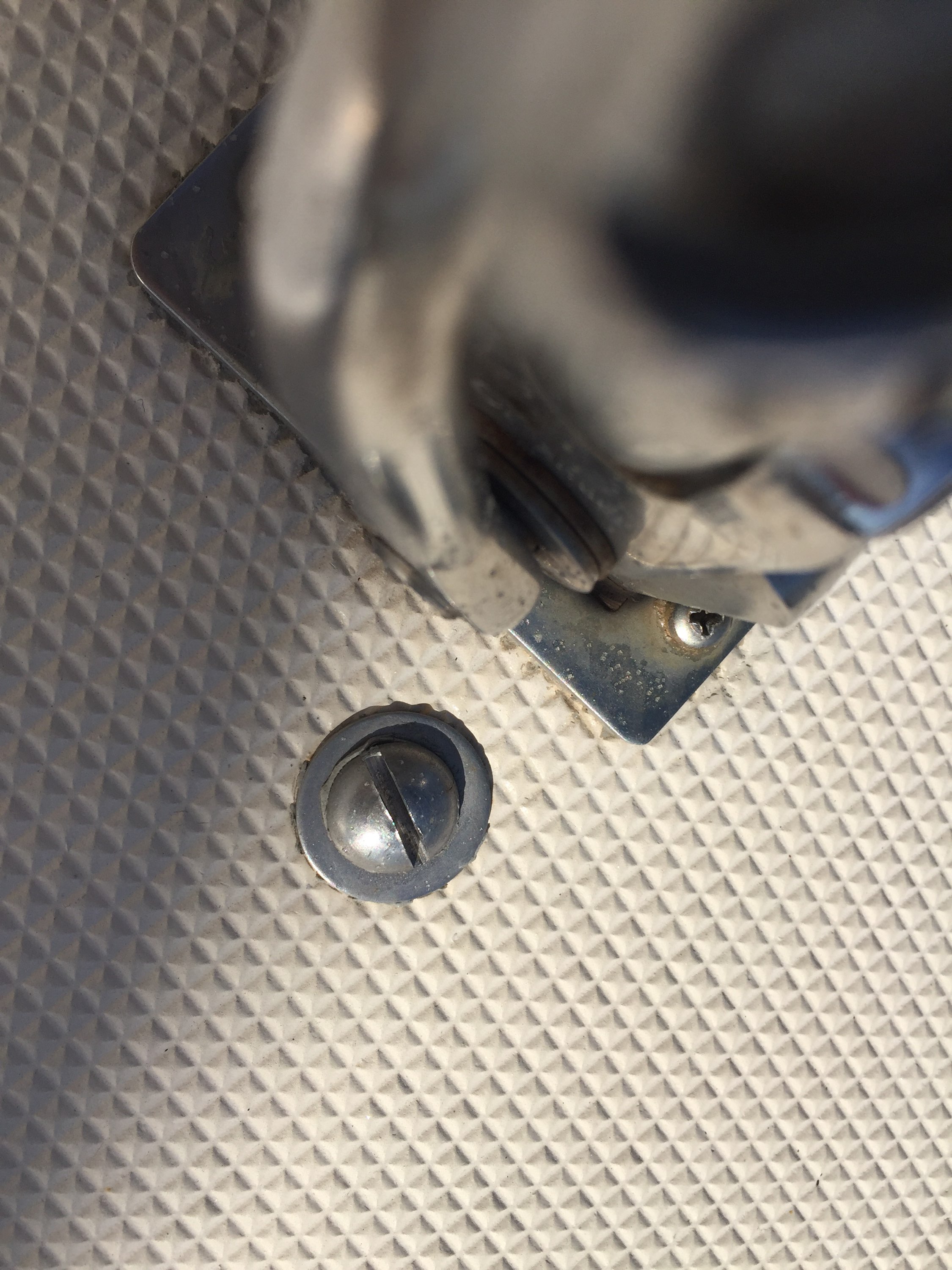

 You mentioned you were going to re-bed the chain plates on your early Catalina 36 and I wanted to share a bit of information regarding the bolts that are used in fastening the chain plate to the deck. You will have a heck of a time finding that exact slot head bolt at the hardware store ; they are 3/8" X 2" -16 thread with a slot head. (See below) . The good news is that they are available from Catalina Direct as part number. D2224 and used to hold the tiller arm in place on a Catalina 22 & 25.
Image icon Chain plate bolts756.76 KB

I'm not sure who is planning to rebed their chainplates but it isnt' me.  I have over 1000 blisters to deal with now that the hull has been soda blasted.  OMG!!  I now fully understand the saying "ignorance is bliss".  Oh well, looks like our one month on the hard is turning into two.  Yes, I realize that this would be a good time to have all the gel coat removed and the bottom completely re-done but we just aren't interested in putting that kind of money into a 1983 sailboat.  It has plenty of other issues that need to be addressed.  I will fix the ones that I can find and leave the rest for another time.   The good news is that the other 1000 blisters were already dealt with by a previous owner......

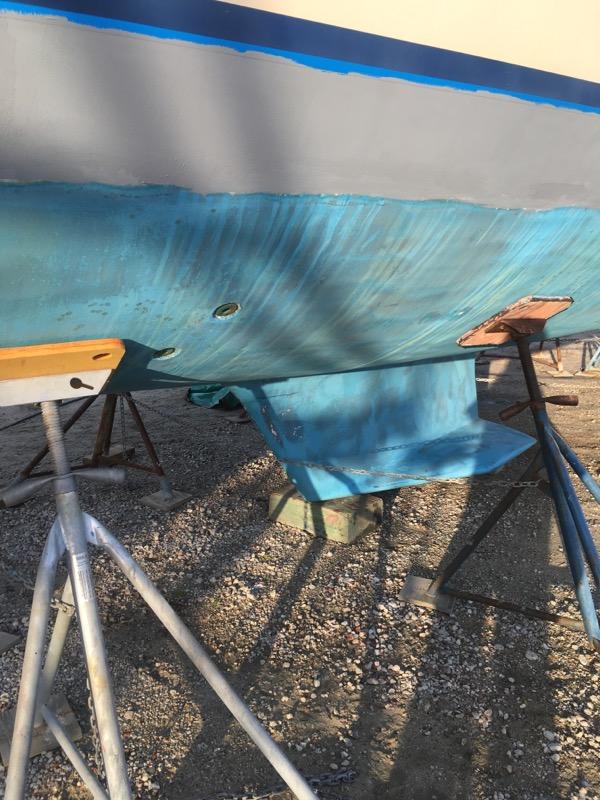

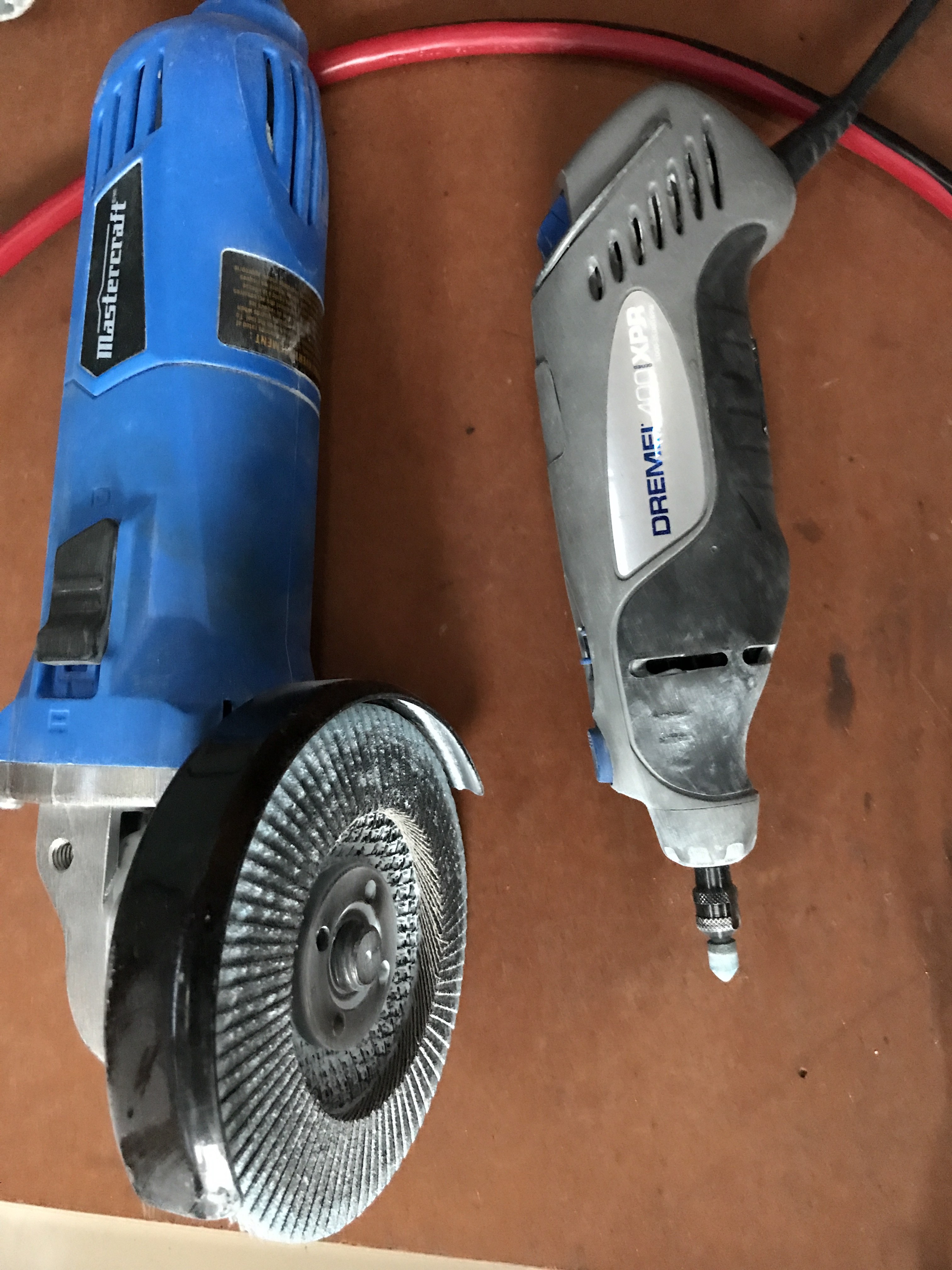

I've been grinding blisters all day and it went very well.  Got a flapper disk for the small grinder and it worked awesome, much better than the little dremel I tried yesterday.  So almost 1000 blisters are now open and well on the way to being dried out.  It took a few minutes to get the hang of it but once I figured out how much to take off it was fast and very effective.  I didn't get to every little tiny blister, partly because I just can't see them all and partly because I can no longer lift my arms.
I was re-assured to have a number of the professional boat repair guys in the yard stop by to comment and they all said it was not as bad as I might think and I was tackling it the right way.  I did grind off some of the old repairs and I found a few that were so poorly repaired that they still had liquid in them and had not been ground down to good fibreglass.  Most of them were fine so I am not going to worry about it.  It just confirmed that it really is worth taking the time to get rid of any moisture and loose fibreglass.
Anyhow, here's a few pictures of the progress.

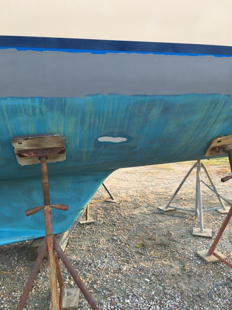

Thanks for the reminder to update my hull repair job.   We are cruising right now so internet is a bit spotty, I will add photos when I get home again.
I spent a good deal of time grinding and cleaning the blisters that I felt like fixing.  There are many more small ones that I may or may not care enough to deal with at a later date.  The good news is that most of them were quite shallow and I was able to grind them down to clean and solid fibreglass without going too deep.  After a few days of grinding and fairing I left them sit for about 6 weeks.  Sure, I could have let them sit for the whole summer as suggested in many how-to videos but I actually wanted to get out on the water this year.
After 6 weeks I cleaned them again and filled them with epoxy a few times until I could sand them mostly level with the hull.  It is not a perfect job by far but many guys in the boat yard came around to give me their opinions and suggestions and they generally approved of the job I did.  This process took a couple of weeks as there is only one of me and many many holes to fill and sand and fill and sand.
Just for fun in the meantime, I ground the keel down to bare metal and removed the original fibreglass and fairing compound that covereed the keel to hull joint.  When the keel bolt socket set arrived we tightened up the bolts then coated them inside to keep water from the bilge from draining out through the bolts.  The gap was perfectly acceptable to me so all I did was fill it with epoxy filler and a few layers of glass, fill and sand and sand and fill and a little bit more sanding then I was pretty happy with the result.
After the blisters were filled and the keel was looking pretty I gave the entire hull a good sand and cleaning.
Finally, I used Interprotect as a barrier coat and a couple coats of some beautiful black antifouling and the job was done.
I didn't take as many pictures as I should have.  Started out with good intentions but it seemed like I had so many pictures that weren't that interesting to anyone but me so I stopped taking them.  Will see what I can find and post them in a few days.
