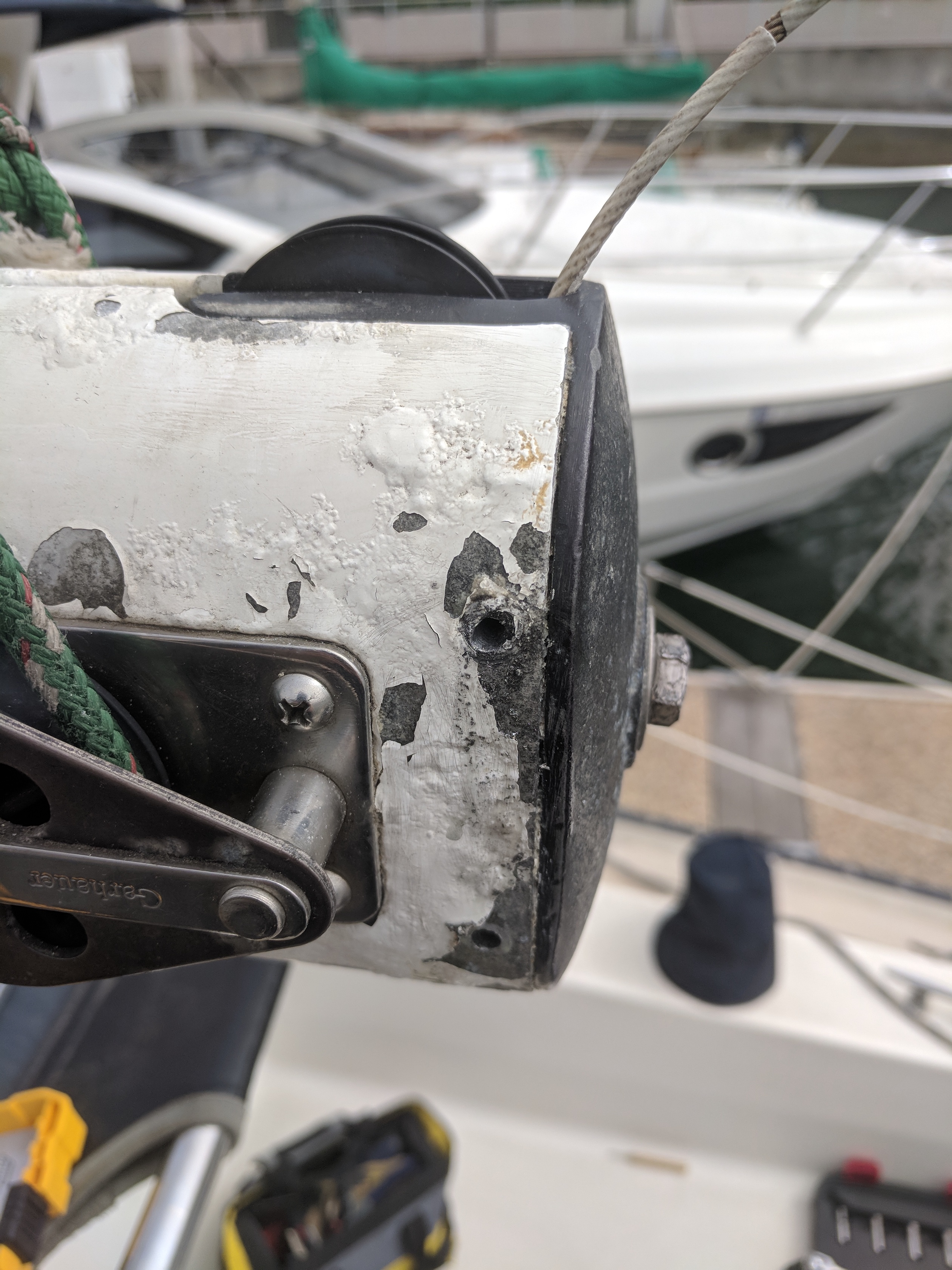

I have a 1988 C36 MK1. I tried to sew the new line to the end of the old one and pull it through, but the wire/rope joint will not clear the aft boom pulley.

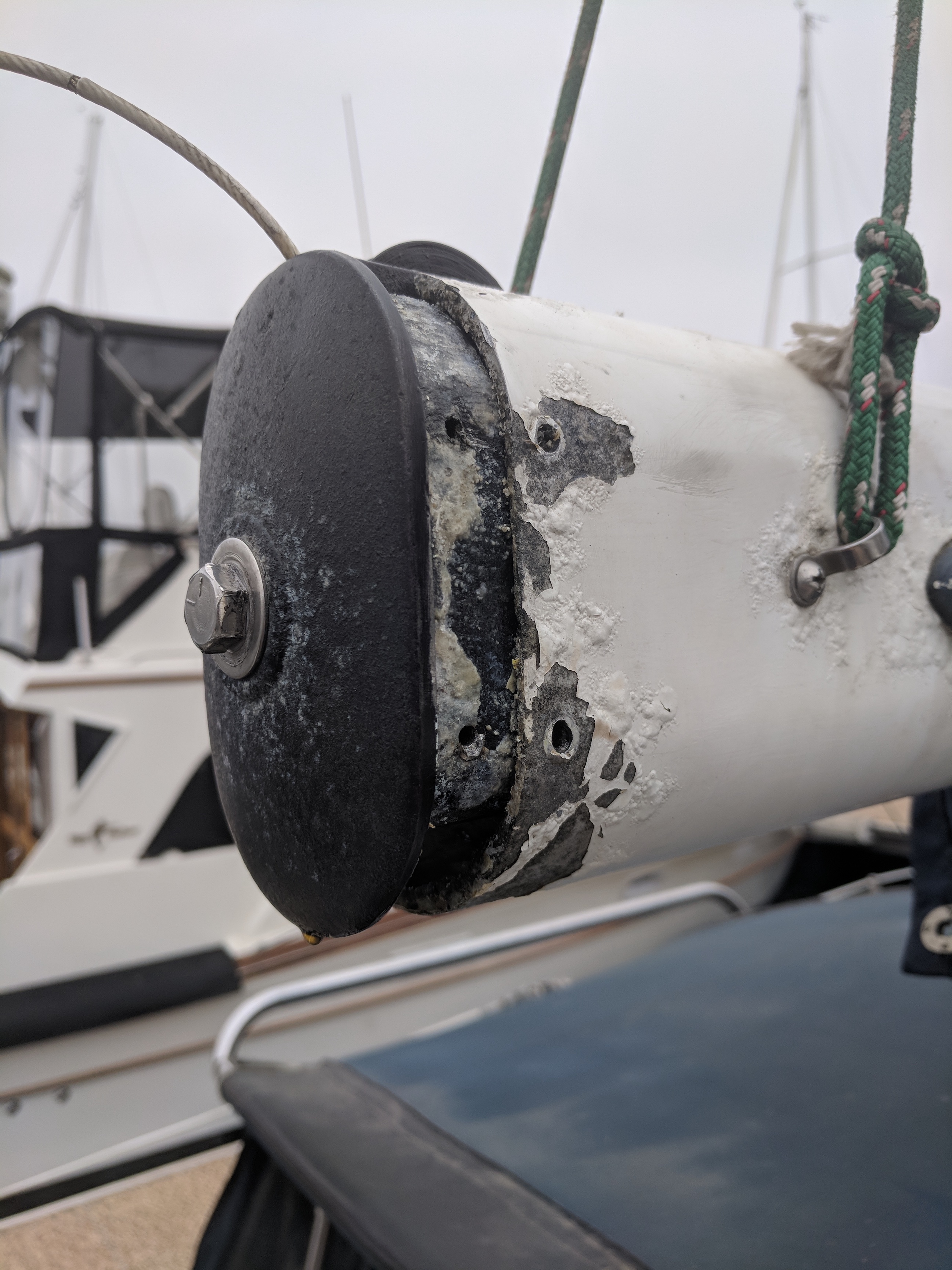

I tried to pull the aft end cap off the boom, but it won't budge. It looks to be secured by four screws (two on each side of the boom). I removed all four and the end cap is still stuck tight. There is a 9/16 bolt centered on the end cap and it extremely difficult to turn.

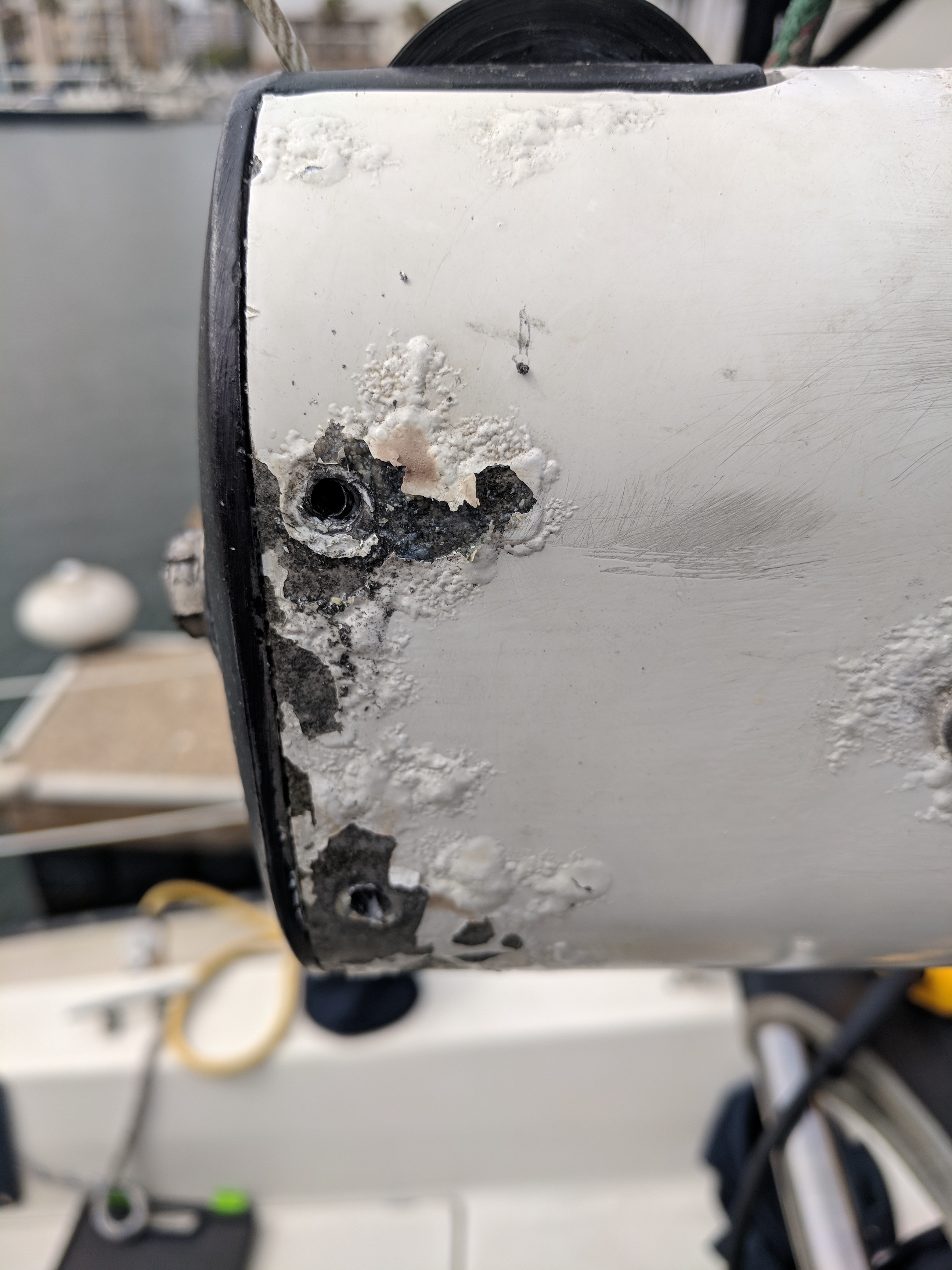

Welcome to the Forum! The outhaul can and should be replaced. The original design is only a 2:1 purchase inside the boom, the blocks inside are of questionable quality, and the small plastic covered wire is not up to the task. About 4-5 years ago I wrote an article for Mainsheet on just this topic, complete with photos and a parts list. I know that it's on the Tech Notes CD. All three year memberships and renewals in C36IA receive a free copy of the Tech Notes CD. They are probably stuck on with corrosion, but the end caps have to come off. If you were able to get the four self-tapping screws out, you've got most of the job done. Others have had to drill them out! It might be best to take the boom off the boat and work on in your garage or workshop. You might need to soak the ends with PB Blaster and/or use heat. The bolt thru the end cap does not have to be touched. Hope this helps.

Screws "removed"! Now I guess the next step is to heat it and use a hammer to get the boom end out.
Ludovic François
Marina Del Rey, CA
Lots of kroil and gentle  tapping with a punch will get them off.   Doubt mine have been off since 1983 when I pulled them this winter to replace the outhaul.

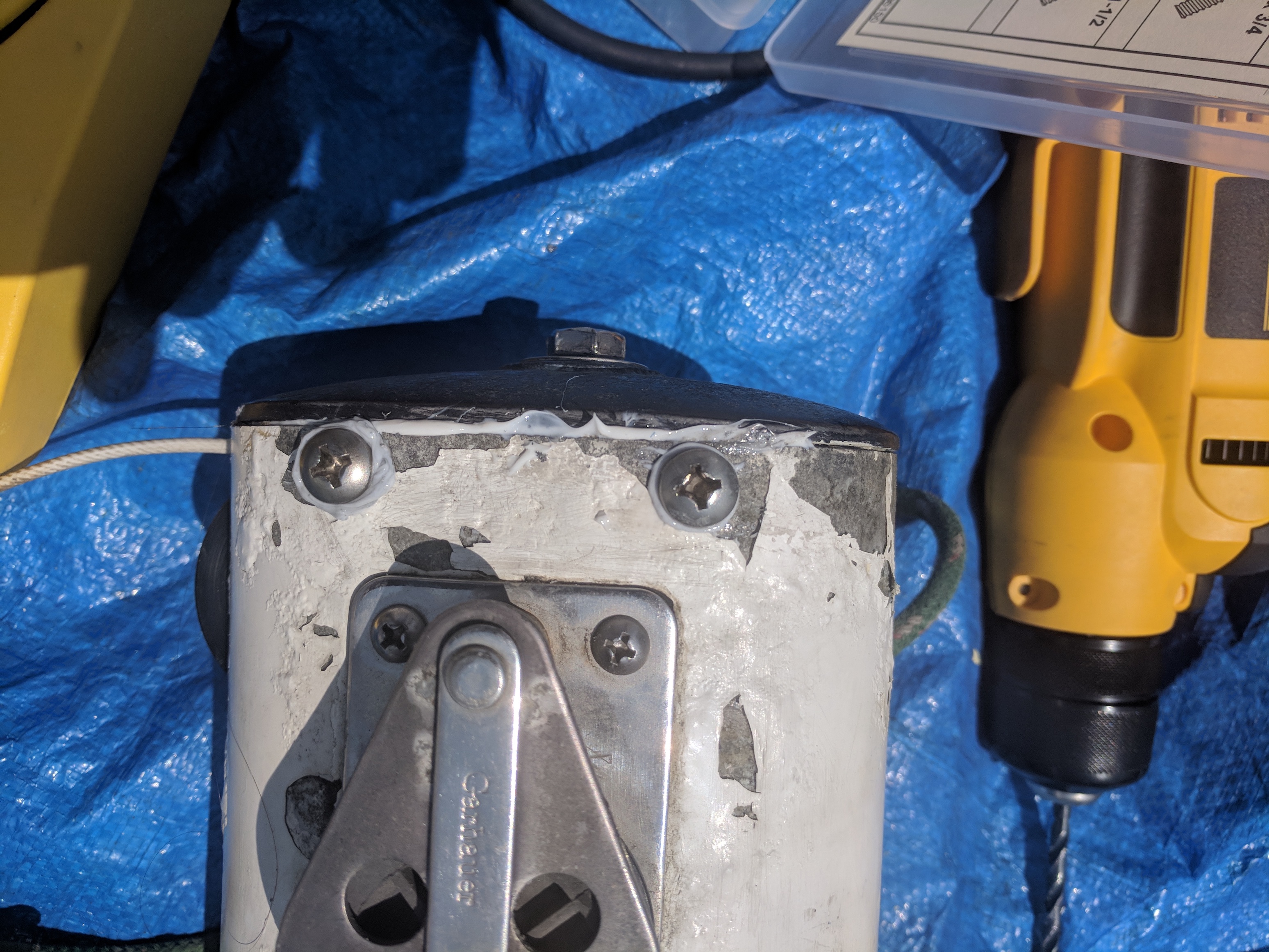

Goose neck end just remove same four screws as on the other end and remove that end cap

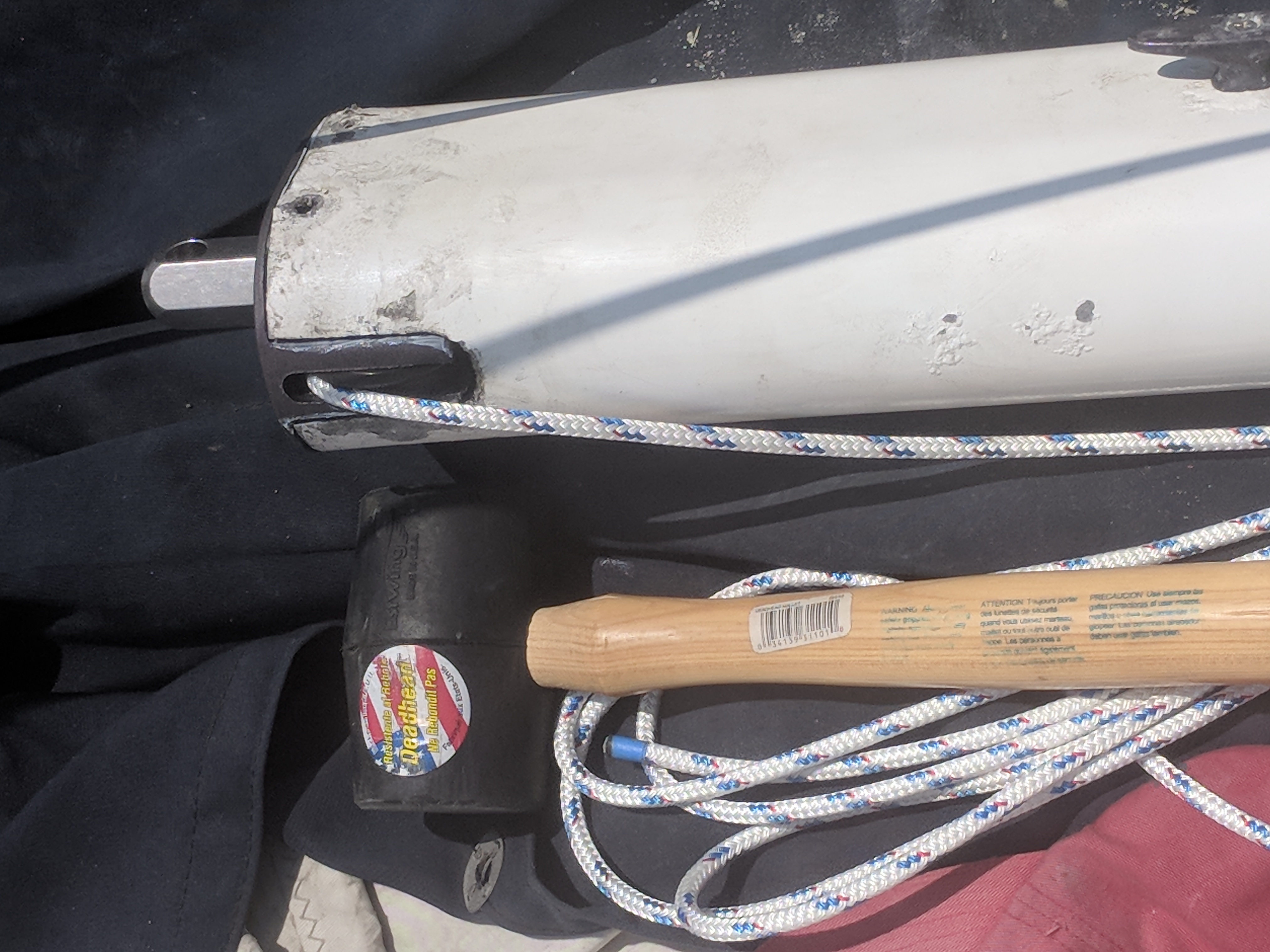

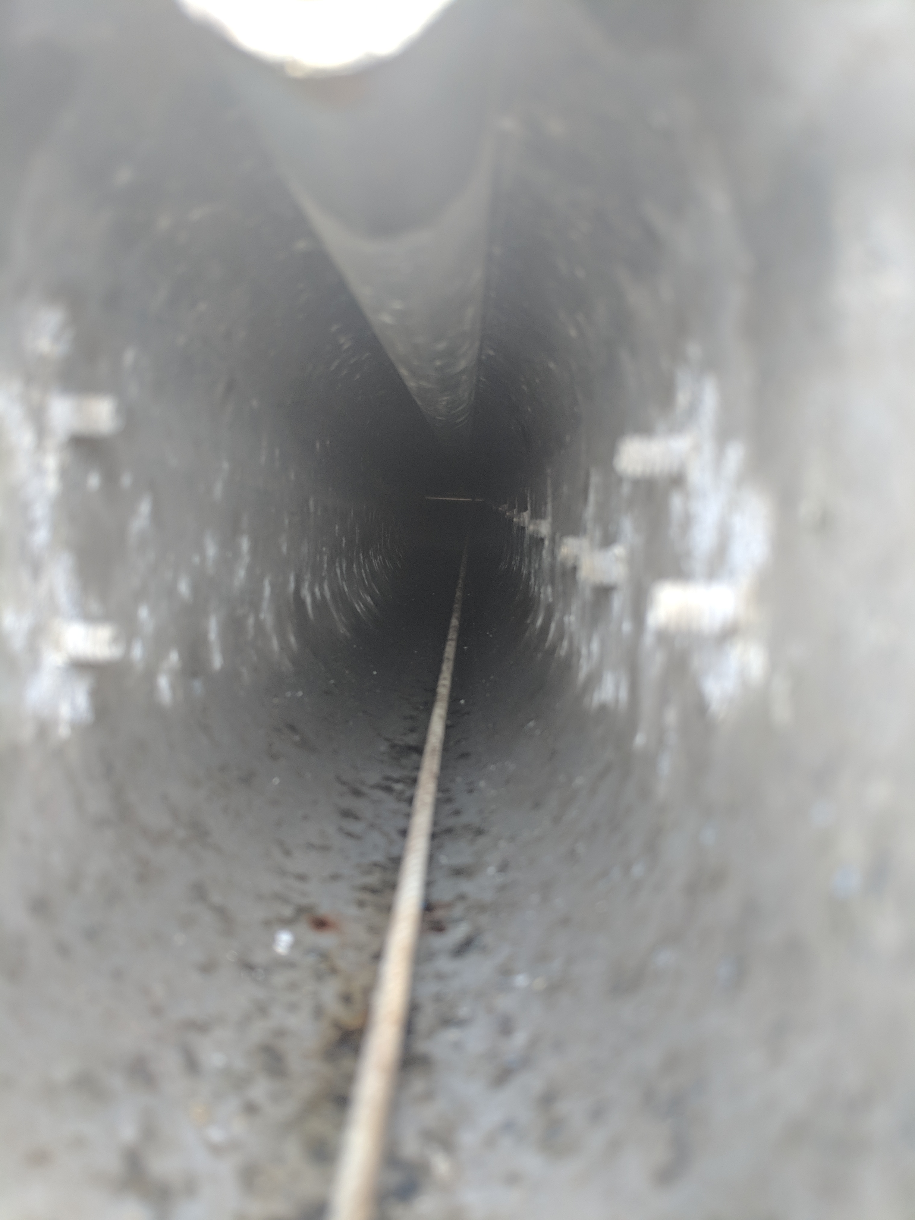

I replaced on my C30. Yes, use a penetrant like PB blaster. I used a wide screw driver blade and tapped it with a hammer- alternating sides and eventually removed the endcap. On the C30, and maybe on the C36- I found lots of mounting screws from external blocks and slides extending deep into the boom interior- often hanging up the out-haul line/block. I had to remove them and shorten to correct the problem.

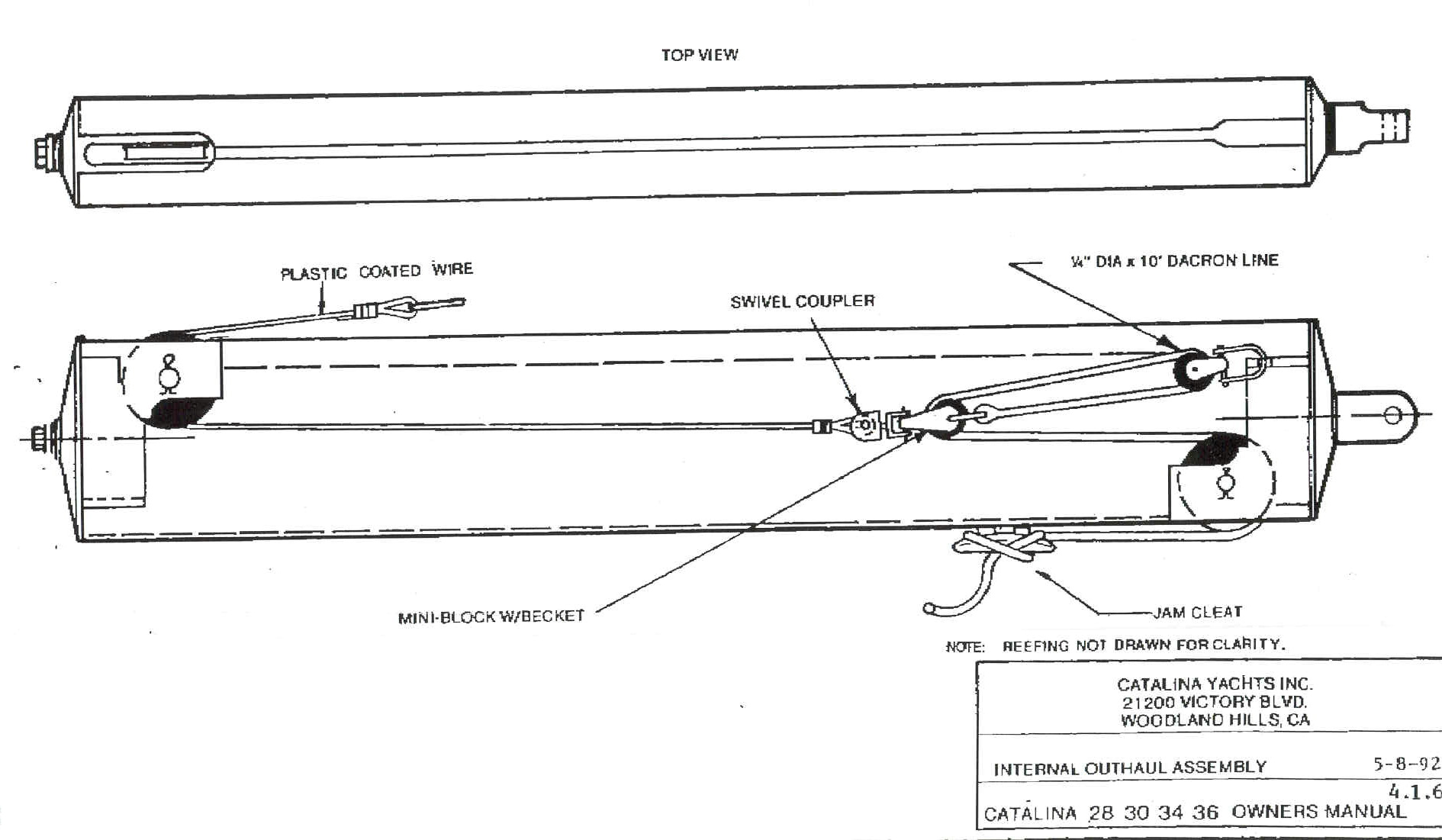

Ludovic,
As Les said, you also have to remove the gooseneck end of the boom to work on the outhaul. I've attached a pic of the factory setup. Not sure if the article I did for the Tech Notes CD is also on this site, but it has all the part numbers and pix. Hope this helps.

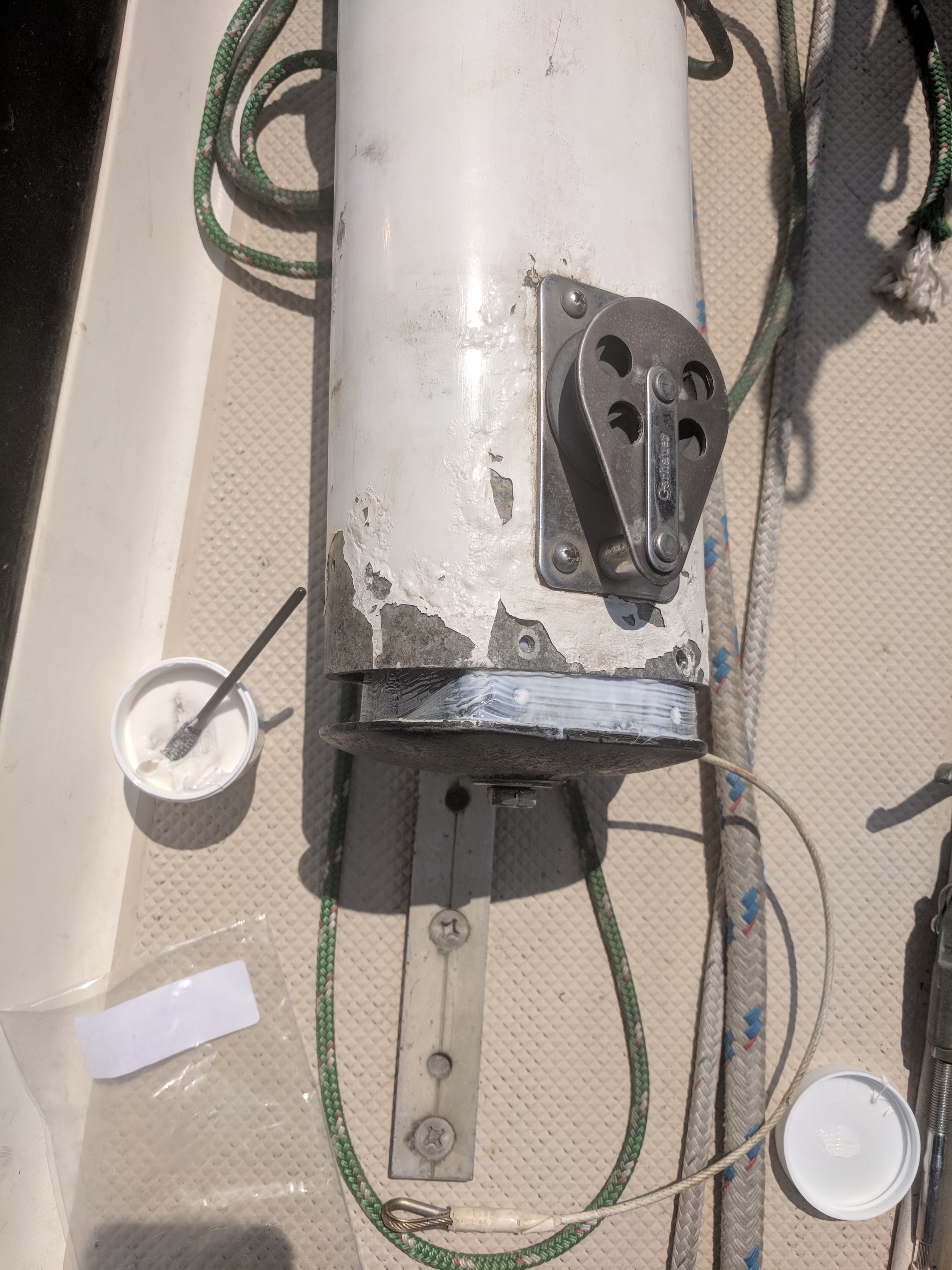

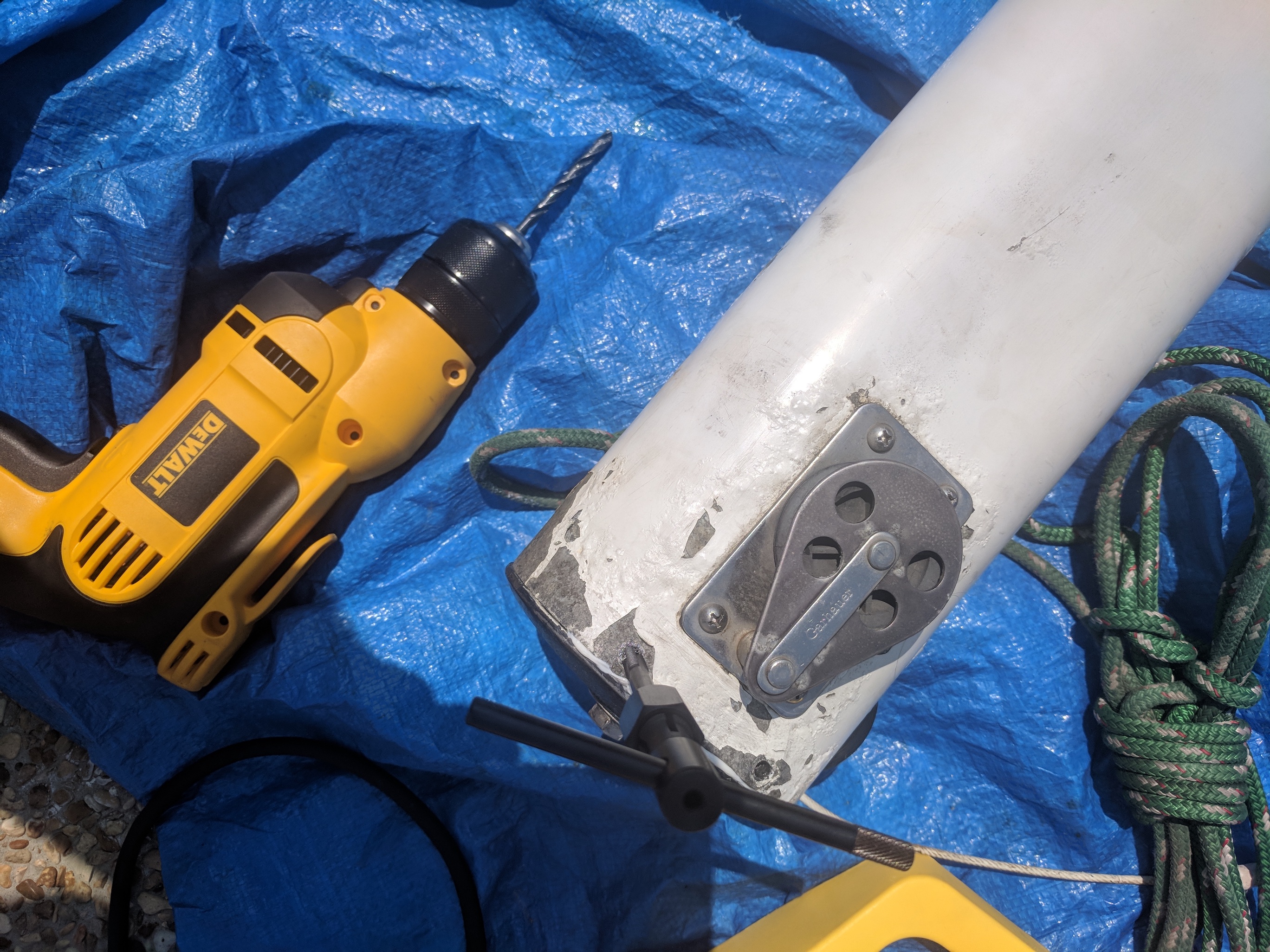

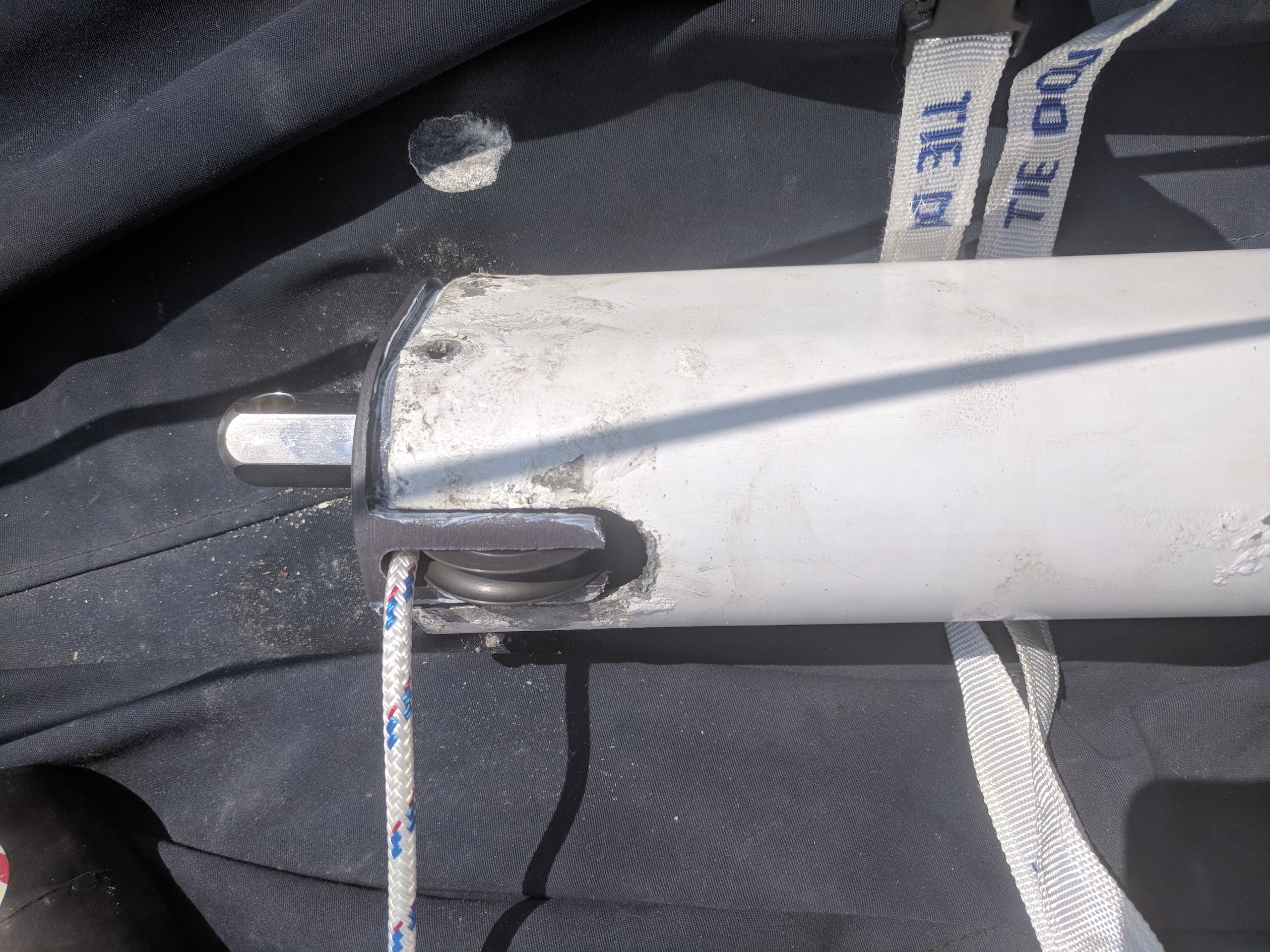

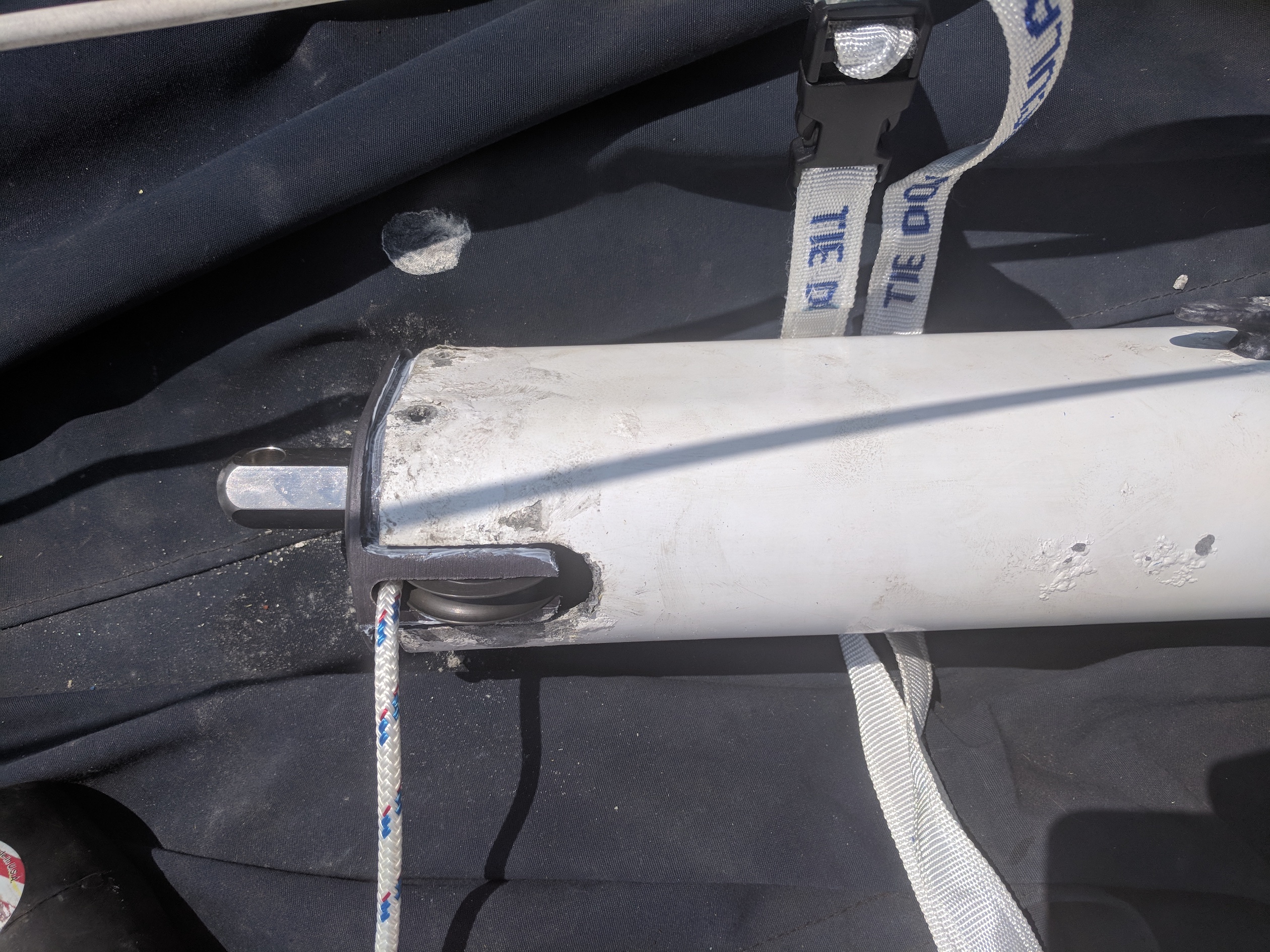

Completed the upgrade 2 weeks ago and tested on a 70 nm trip this week-end. It works great!

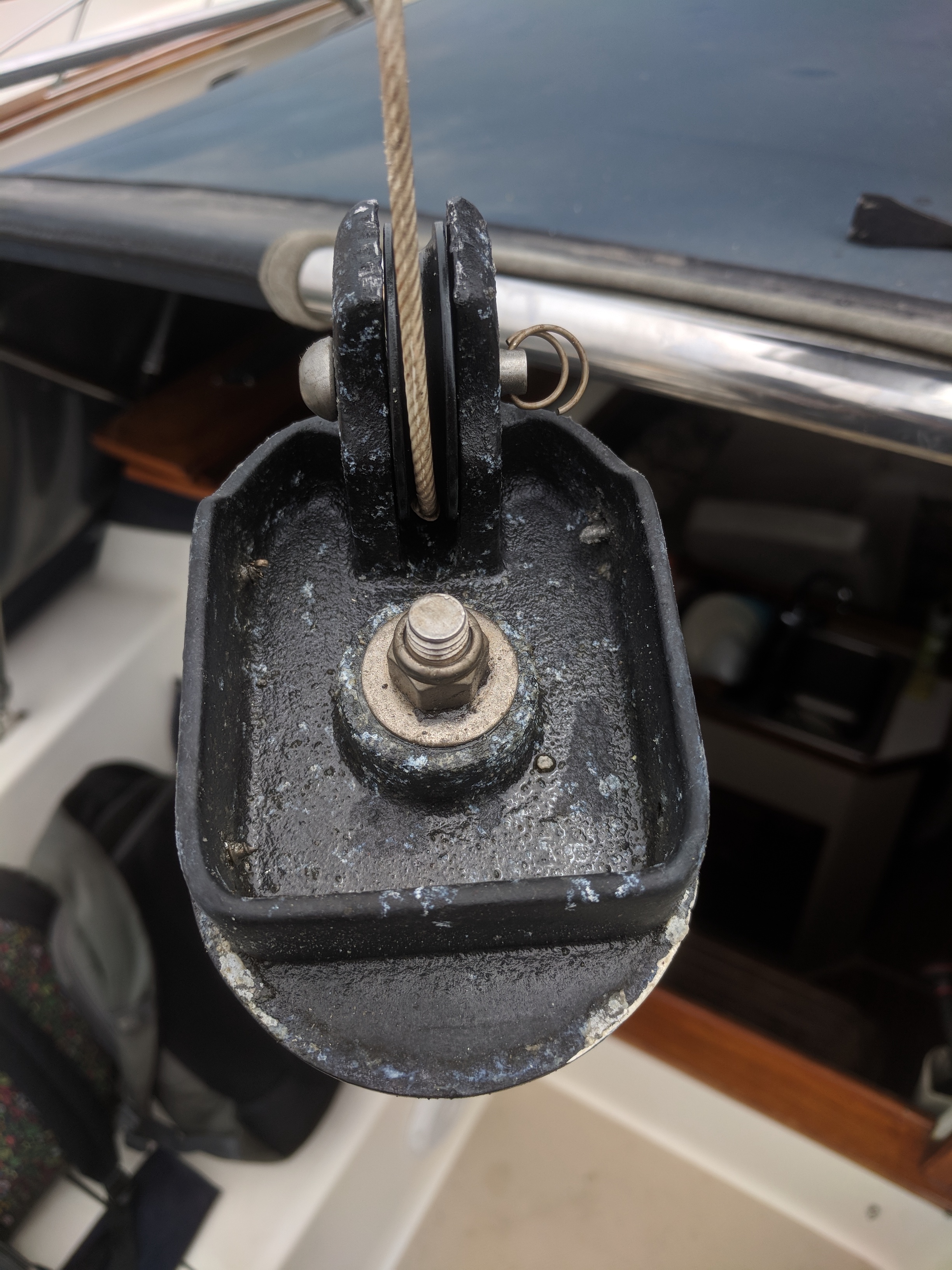

Replaced both sheeves with sheeves bought on Catalina Direct:
Mast sheave:
  • H1883 Masthead Sheave Ball Bearing C-25, C-27, C-28; Outhaul C-28, C-30, C-34, C-36 ($39.95)
  • I think it's overkill and a bit too much money for the job
Aft sheave:
  • Masthead Sheave Wire C-25, C-27; Outhaul C-28 to C-36 ($8.95)

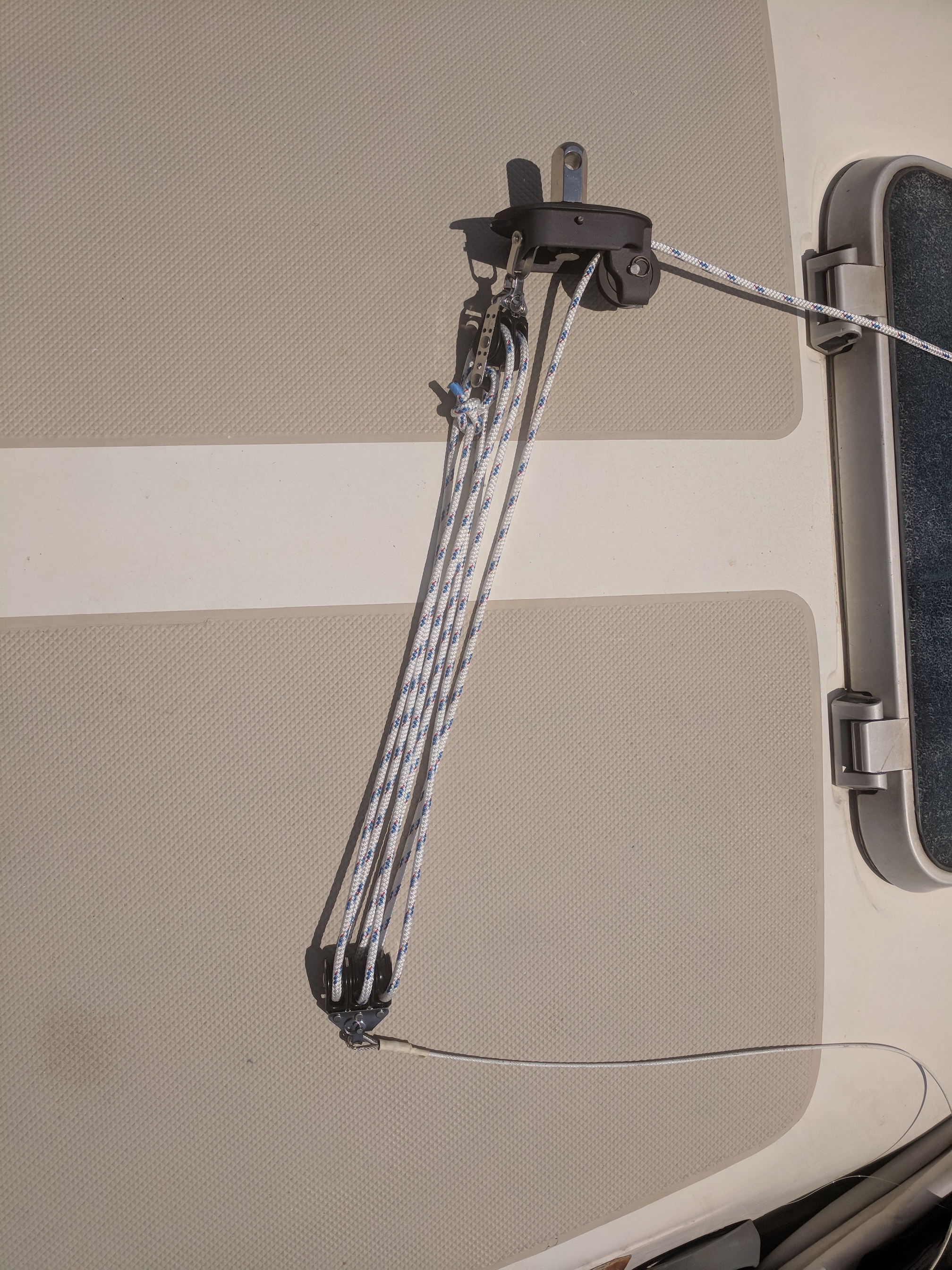

Built the new purchase with:
  • Harken #085 Double Block w/Becket (ebay $25.39)
  • Harken #086 Triple Block (ebay $29.99)
  • 30' x 1/4" Sta-Set New England (west marine $19)
Replaced the self tapping screws with 8 x ¼-20x3/4” SS machine screws, shorter would have been better, but it was I had in my boltdepot kit when I did the work.
Put a lot of Tef-Gel to hopefully have an easier time next time I want to look at it.
Thank you to Tom, Les, and all the materials available here! It helped me a lot to go over this project.
