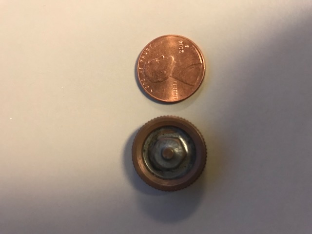

M25XP bleeder valve sheered off with some of the stem/bolt. Not really something I use too much, but would like to replace it. Having a hard time figuring out a part number, I think the knob/stem/bolt are all one piece.

Give the guys at TOADD Marine a call. That's where I got mine. They'll get you the correct /part unit for your engine. The knob, stem and valve are one piece and one part number.
About $35.00.....Bill

Bill beat me to it. I had to replace ours as well. Here is the link to the specific page.
http://www.marinedieseldirect.com/catalogs/catalog_group.php?owner=mdd&p...
Item #33. Bleeder valve assembly. $40.60
Easy to replace. There you go.

I’ll say me too for Toad on that part. Be sure and get new copper washers or anneal those in a 200 oven for a couple hours - then turn off and cool in oven without opening the door ( wait till the wife is out shopping for a few hours.
Edit. I was thinking 200C which is about 400F.  Some folks advocate cherry red, others sanding with 220 on a flat surface till dead flat. Best is new
