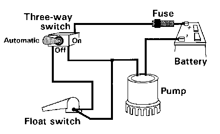

This is the wiring diagram fir the bilge pump.
Use a voltmeter to find the short that causes the breaker to trip.

Hi Haro, I don't see any attachment or link. Thanks.

Oops, I goofed. I uploaded the wiring diagram.

Haro, Thank you! You've given me just enough to start my search, and test out my recently purchased multimeter!
