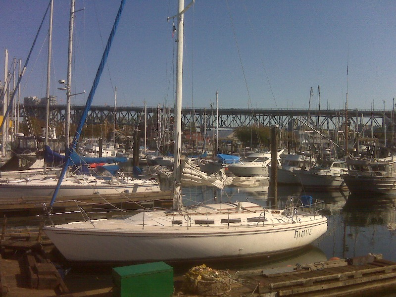

Wondering where other mk 1 boats have their bilge pump outlet. My boat has the standard manual pump out via the transom, but the electric pump (2 actually) had their outlets in the topsides, visible in the attached picture.
I removed and glassed over these holes as I was worried about siphoning water into the boat when under way and heeled, and it turned out that one of the two fittings wasn't even really bedded so it leaked water in all by itself.
Now I am thinking the best bet is to take the auto bilge pump outlet back under the engine, under the aft berth, and Tee it into the manual bilge pump hose at the transom. Any other bright ideas? Some race boats I know have the bilge pump near midships but right up at the sheer line, this doesn't appeal much to me as it will streak the boat and pump out onto my dock most of the time.
