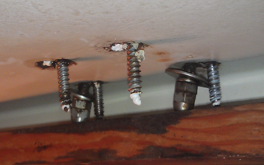

I thought I would share what I discovered today as I removing some woodwork to gain acess to the bolts on the port stantion. I am adding SS backing plates to all stantions and rails and rebedding with butyl tape so there will be no leaks. It took a while to remove the plywood cover that was hiding the bolts to the mid stantion but have a look at what I found. A PO had cut off the bolt heads, move the base 1/2" and then Screwed it down. Screws in a Stantion base :eek:
My plan is to add acess holes in the plywood so I can get at these bolts in the future.

That's ugly. You're doing the right thing. Kudos.
I think Tom Soko (past Commodore) is famous for saying that the main thing to watch out for when buying a used Catalina is what the PO has done wrong (or neglected).

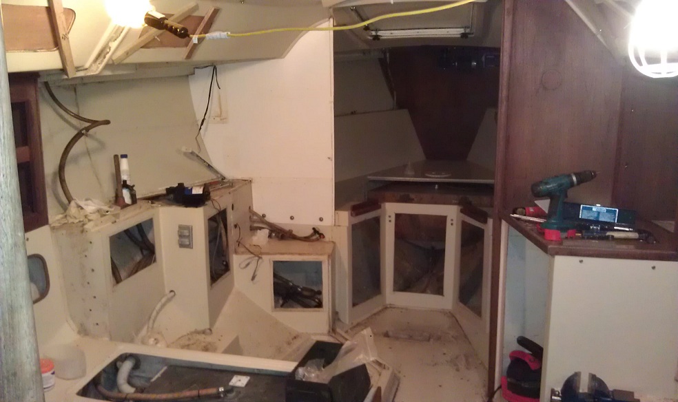

I find that with most boats. However I do buy project boats and expect to see a few interesting solutions to problems.... Not always safe, visually appealing or for that matter even practical but in the eyes of the owner... well some people should hire professionals.
This is a current picture of what Wavelength currently looks like on the inside. :) I have a few projects on the go with her. Hopefully will be in the water by the end of May.

Wow, that's got me scratching my head. Glad you found it and are taking the proper measures to correct.

What was intersting was the screw heads and bolt heads are identical. From the outside you would assume they were bolts.

It looks like there has been some water penetration. Have you checked to see if there is moisture in the deck?

There was lots of water penatration. Windows leaked, all stantions leaked, all chainplates leaked..... Survey said there was moisture but not significant amounts. The good thing about these decks they are cored with plywood and it takes a lot to get them to rot, especially when in the winter they are frozen. ;) Where I checked around the chain plates the ply seem solid. In the next few weeks it will be all resealed with butyl tape, backing plates and larger outside plates on chainplates.
