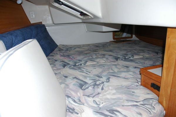

I really haven't spent much time crawling around an a C36. Found one picture on YW showing the aft cabin. Is it possible to access the autopilot through the access door? Or if that is not standard, by adding one.

I can barely get one arm through that hatch, let alone do any sort of work, since it almost always would require 2 hands. I've been curious just how structural that bulkhead is, and if the hatch could be enlarged; or if additional access hatches could be made. But I'd want to be sure it wouldn't compromise the structure.
I've never been in a Mk1, but isn't the aft bulkhead removable? I realize that the stern section of the Mk II is different, and may require the additional support.

There are three tricks to gaining access to the aft lazarette area via the aft cabin access panel. I have a photo of me spending long intervals in that access port, half in and half out of it...see my article on my below-deck autopilot installation in the C36IA Technical - Upgrades library.
My tricks are these:
1. I am only 185 lbs, so there is not too much girth to cram in there.
2. I removed the wooden frame around the access port.
3. I got a short piece of 1" dia PVC tubing at Home Depot, split it lengthwise, and used a heat gun on it to soften it enough to open the tubing up for a slot that would allow it to fit over the sharp bottom edge of the access port. This makes it a lot more comfortable to spend 'quality time' in there.
It also helps that I am small enough in stature to be able to crawl into either the port or starboard lazarettes, wiggle around, and actually accomplish something while I am in there. Always my biggest fear when down in the lazarette (as I state in my article) is working with AC voltage, such as using a heat gun. Most of my tools are battery powered and therefore pose no electrical hazard; but the heat gun! Or the soldering iron! Being surrounded by potential grounds, any current leakage could 'fry' me in place. And who would know??? Therefore, I filed a 'flight plan' with my wife when I used the heat gun for the heat-shrink tubing. I told her that if she didn't hear from me in, say, ten minutes, that she should call for an ambulance. I told her to advise them that I might be electrified, and that they should remove AC power to the vessel before approaching the boat. (I also said that if this event happens, they probably wouldn't need to hurry.)
