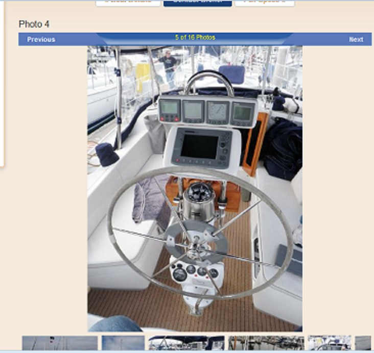

My autopilot wheel drive up and done died.

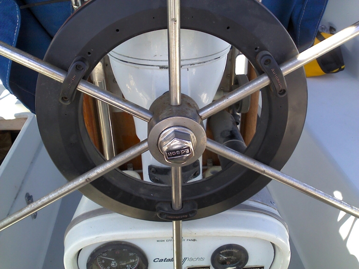

I found out the hard way about the issue many of you already know: there’s an interference issue between the standard Raymarine autopilot wheel drive units and the vertical face of the instrument pod on 90’s vintage Catalina’s.
The PO worked around this issue by installing the now-dead smaller diameter mismatched drive unit. (See attachment 1) This old model wheel drive is no longer available as far as I know and I don’t want a used one. An under-the deck unit is the best solution but its much too expensive.
Please feel free to opine but I think the best option now would be to upgrade the instrument pod with something the likes of which is shown on the second attachment. The slanted face of this newer model pod, I believe, was a deliberate modification to address the interference issue. This particular owner had a 2003 Catalina and a later model Raymarine wheel drive.
I did a quick search of the Internet and found this:
[url]http://store.oceanequipment.com/ProductInfo.aspx?productid=EP162[/url]
It appears to be the same as the 2nd Attachment. At lease one of you has successfully upgraded from an older version to this newer pod style.
My questions:
Has anyone with a mid 90’s 36 and who’s upgraded to this pod also successfully installed a more recent model Raymarine wheel drive?
Might a “dished” wheel alone work?
Any thoughts/insights would be much appreciated.

I did the upgrade a couple years ago. Was no big deal, and I think there's a discussion on it in the jibsheet section? The only issue you'll run into is the tach which has to be rotated a couple degrees in order to fit. No biggie and hardly noticible. I replaced the keyswitch, alarm and blower switches. There is a schematic available on this site but i found the wire colors on my boat to be slightly different, so be careful to note which wires go where so you can put it back together.

My '98 worked fine with the new unit. Just have to cut-off a piece of the engaging lever so it doesn't hit.

I have the newer wheel pilot (ST4000, I believe) and the ring fits fine with no interference on my 1999 model with the same instrument pod you have.
I still know the A/P to be under-sized for the task, but I am not willing to do the below-deck A/P at this time.
