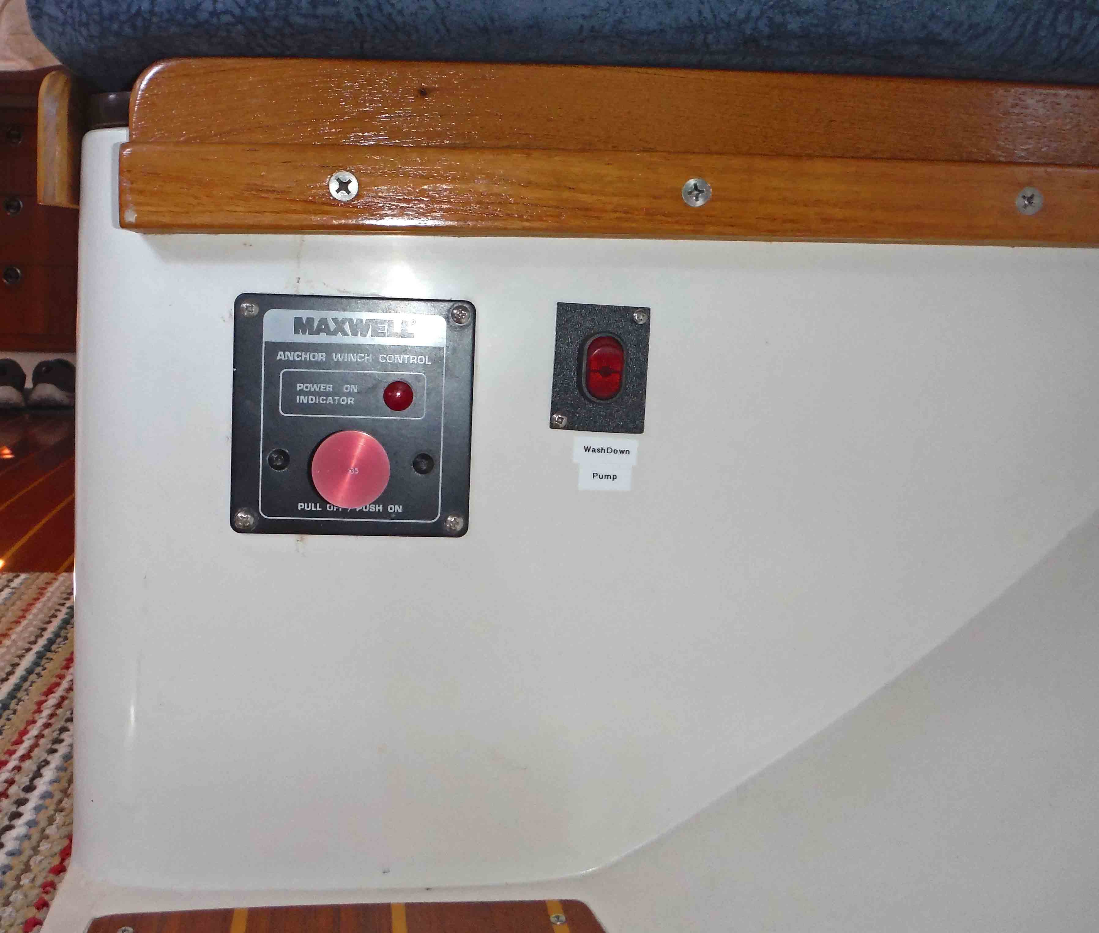

I mounted my pump on the bulkhead behind the toilet raw water intake.  I put the pump switch (w/ indicator light) beside the windlass switch below the game table seat (my thinking is that you need to be there anyway to turn the windlass on/off, so won't forget the washdown pump either...).

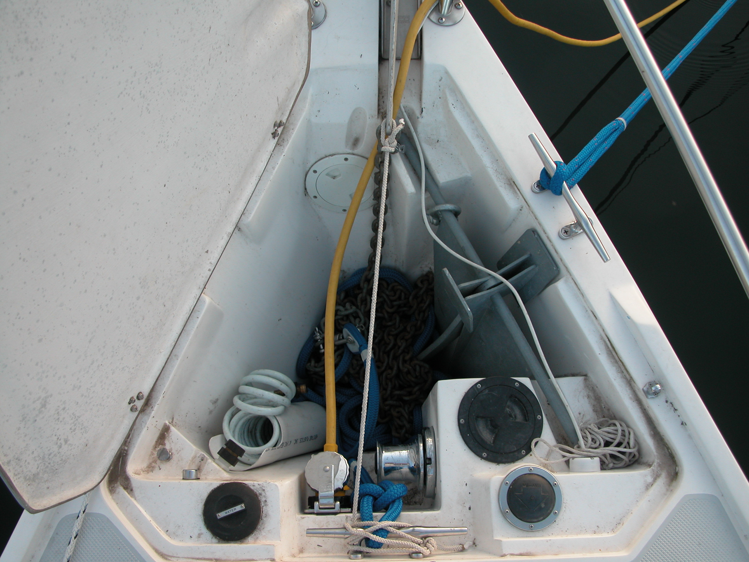

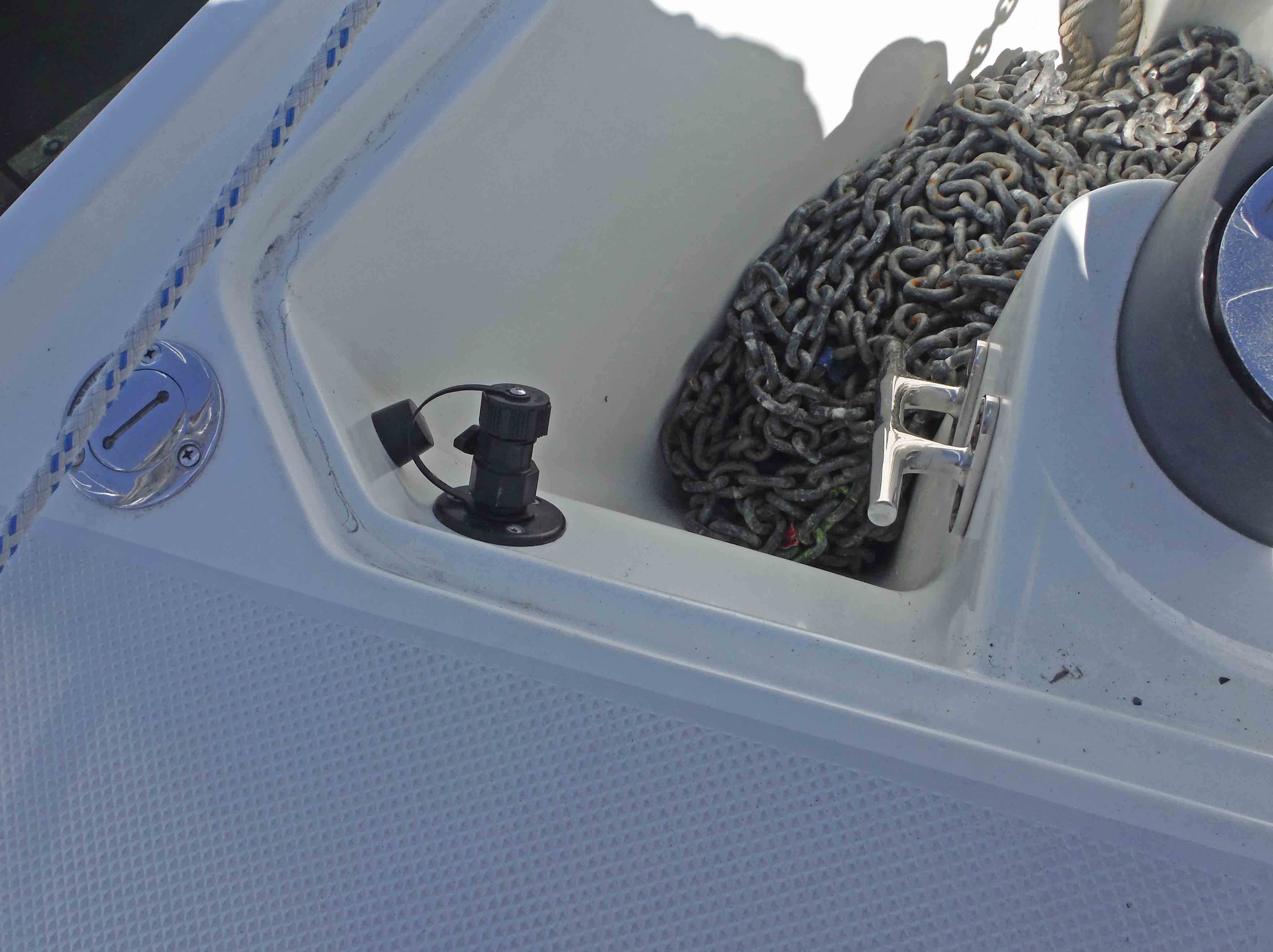

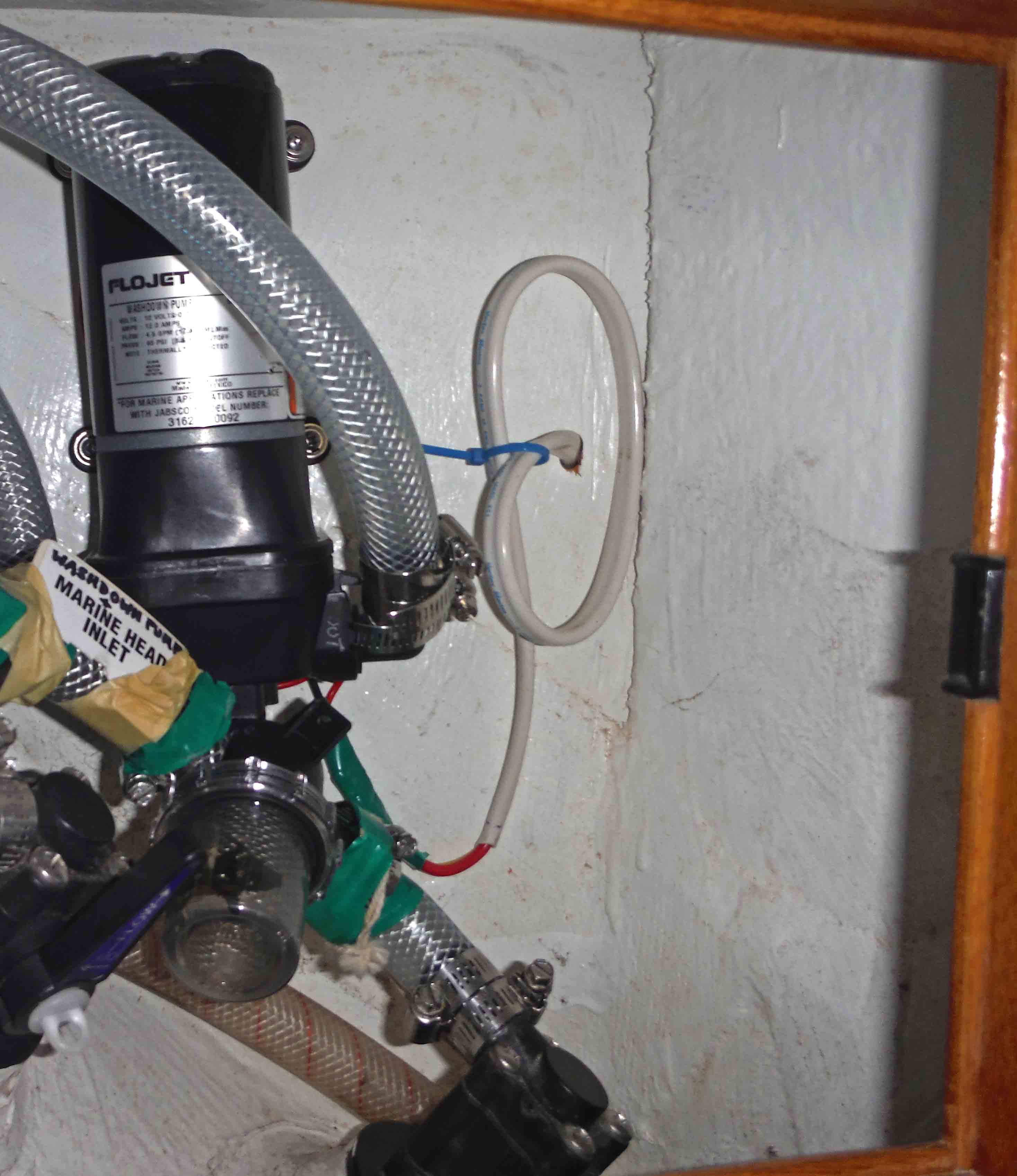

I have posted a few pictures (for what it's worth) to give you a few ideas...
The fixture I used in the anchor locker is a bulkhead mount hose fitting with ball valve shut-off.
The wash down pump is located on the bulkhead between the head and V-berth.  The pump switch is located beside the windlass switch.
