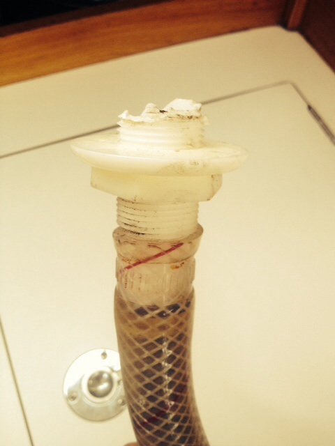

Just for info, problem I founded some weeks ago...
Owner of c36 hull 1122 since new back to 1991...
Since some time I was stating salt water coming onboard. First I thought it was because waves washing the deck and arriving inside... But later I realised that even sailing on calm waters, sea water was coming in.
Finally we discovered   the water came in trough the trough hull at the front of the boat used to empty the anchor well.
When disassembling the fitting, it just broke into pieces! So we are lucky we discover in time the problem.
We have now replace both trough hull fittings, the one inside the anchor well and the hull fitting. The one inside the anchor well was ok. We also replace the hose.
It is my opinion that will be advisable to inform Catalina owners of this problem. The trough hull fitting is exposed to sun light and in my opinion this is what has accelerated the failure of this piece.
As it location has not easy access, especially if you have an additional water tank, in case of problem the solution will be difficult if sailing.
Will recommend to replace the original with a brass or ss trough hull. Best regards!

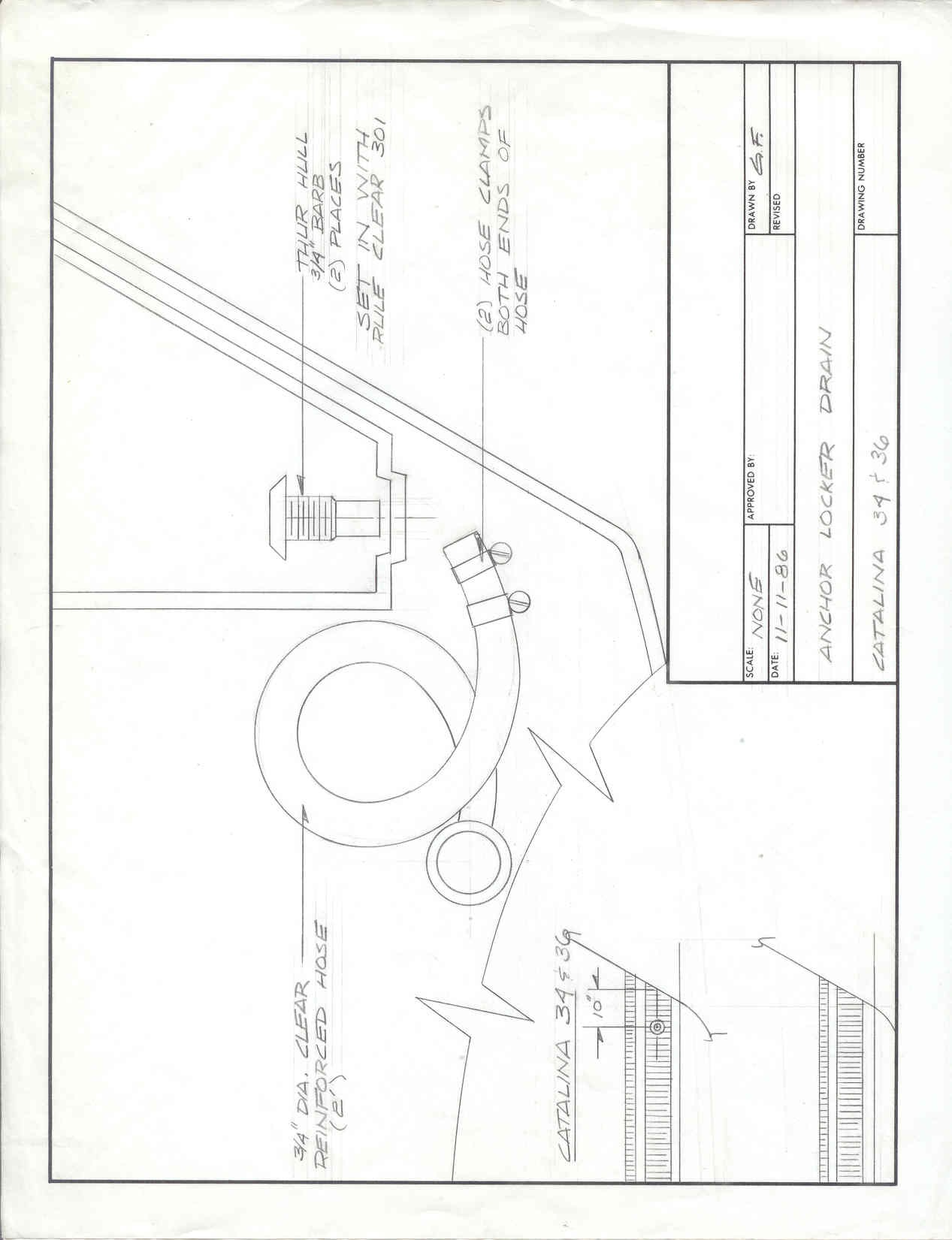

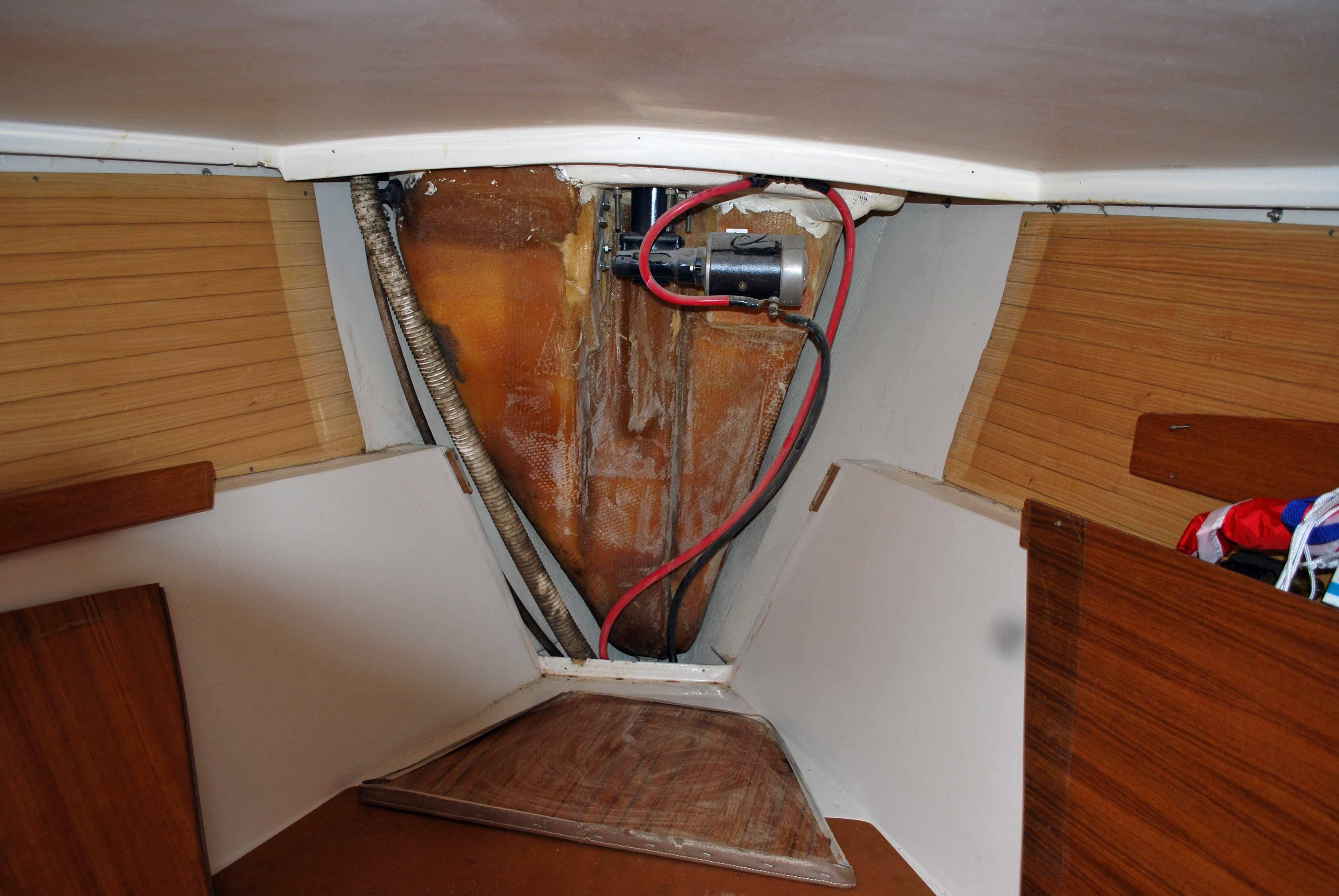

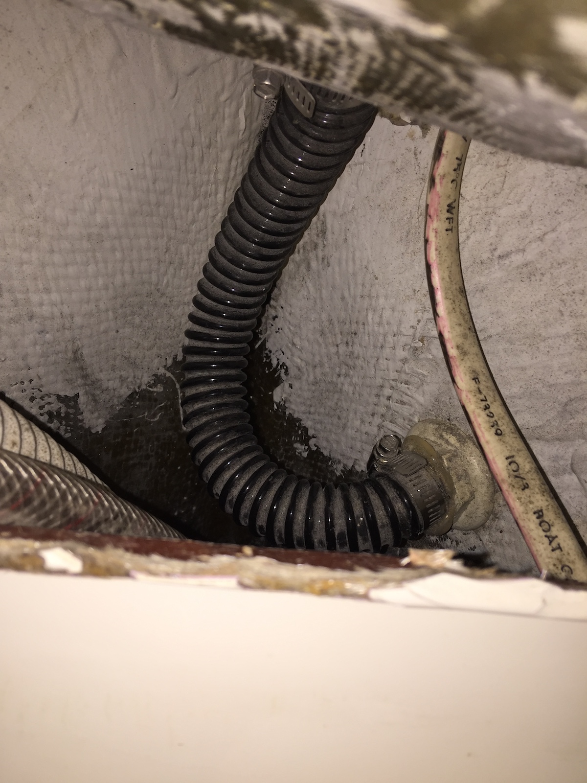

OK... got the answer to the anchor locker drain problem.
1st, to recap, we noticed the bilge pump was running almost continuously on a port tax. Pulled the V berth water tank but that didn't help...could see water running into the bilge from forward while sailing but not at rest. Checked all the obvious thru-hulls but no leaks; plugged the anchor locker drain & that stopped the water flow so that was the problem. Can't get to under the anchor locker thru the shelf the water tank sits in.... trust me on that.
The 2nd problem was getting to the space under the anchor locker. Had to remove almost all the panel & trim since all the pieces interlock (see pic 1). The bulkhead under the forward shelf is the one you need to remove & it fell out when I removed the shelf so you may be able to force it out without removing all the other pieces but I was afraid of destroying that piece by prying at it with a screw driver as I didn't know how it was fastened in at the time.
The schematic someone posted shows a hose with a loop but mine didn't have the loop.. it was a straight piece.... and its very crowed in the space with the anchor windlass in the way. As you can see in pic 2, the hose simply came off the nipple on the bottom of the anchor locker. Both ends of the hose have only one clamp & the nipples are too short for two clamps. The hose is a heavy duty wired hose.
You can't easily check to see if your hose is connected other than having water coming into the bilge as I did so its best to pay attention to that (you can actually see it flowing into the front of the bilge) & the excessive running of the bilge pump . If you do open your system up, have a shop vac handy as its covered with fiberglass dust.
As you'll not from the pic, this is the way you access the winch if you need to work on that.

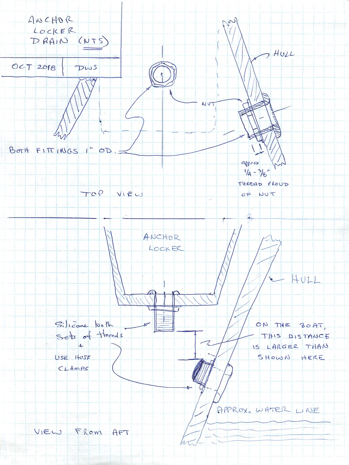

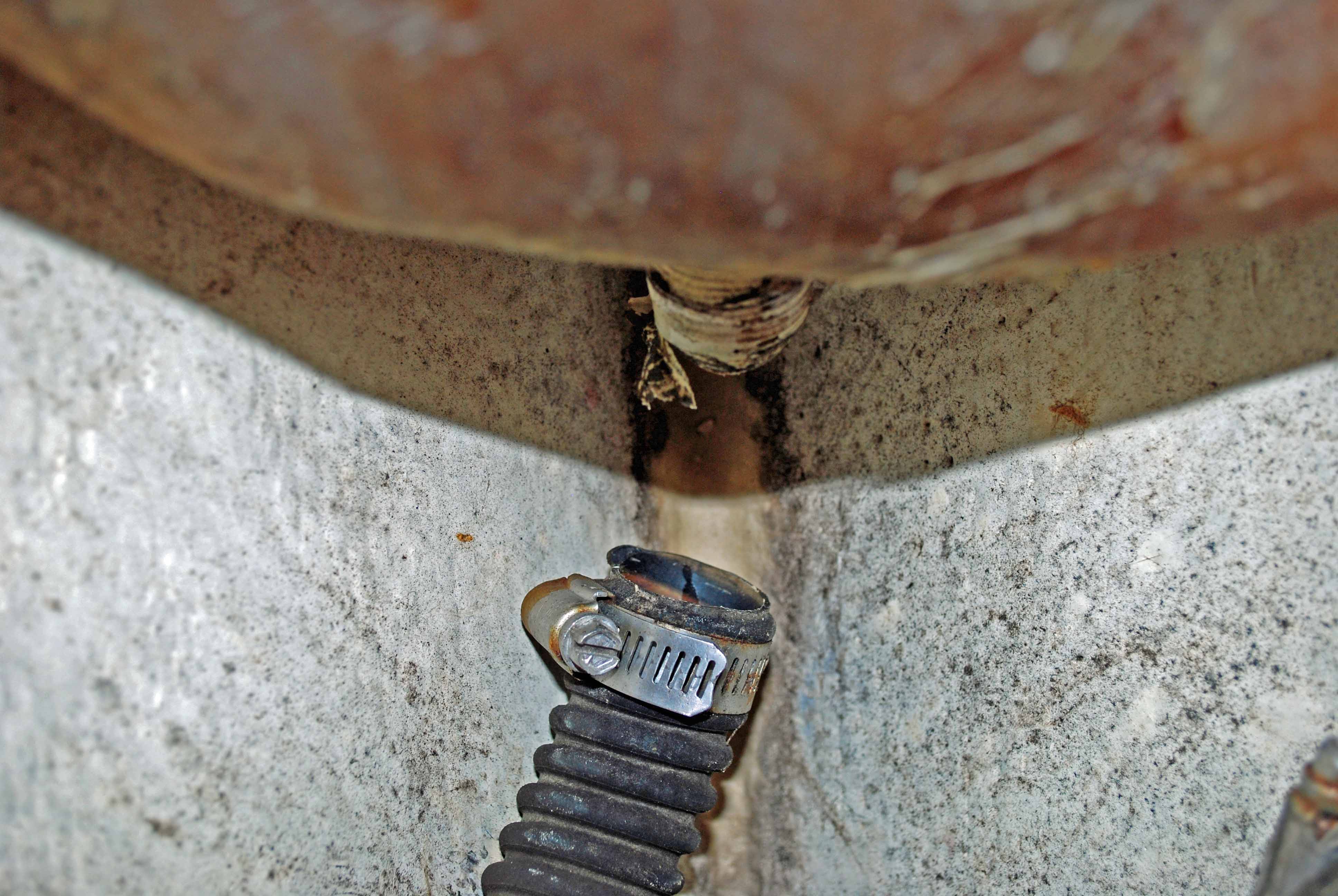

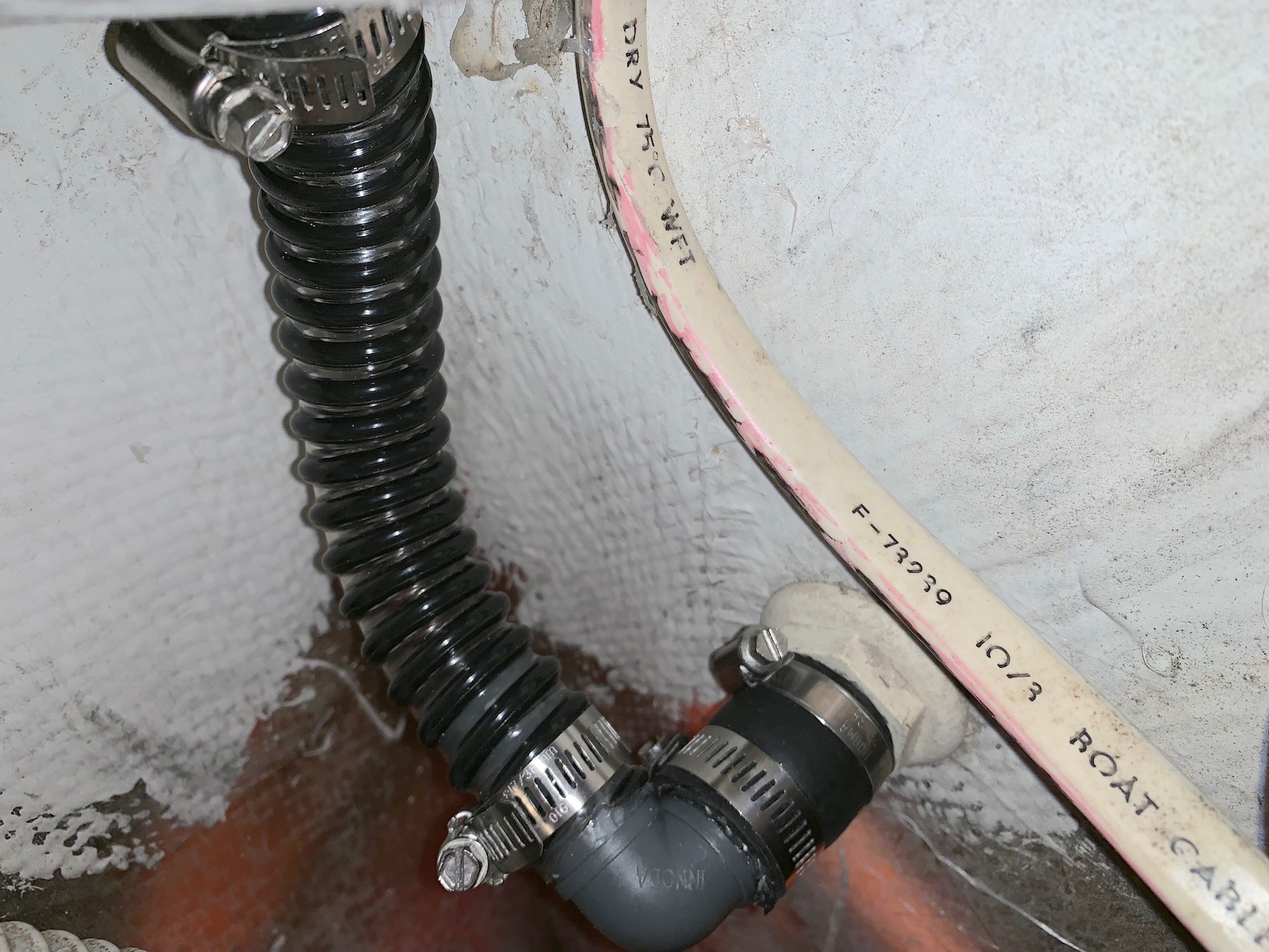

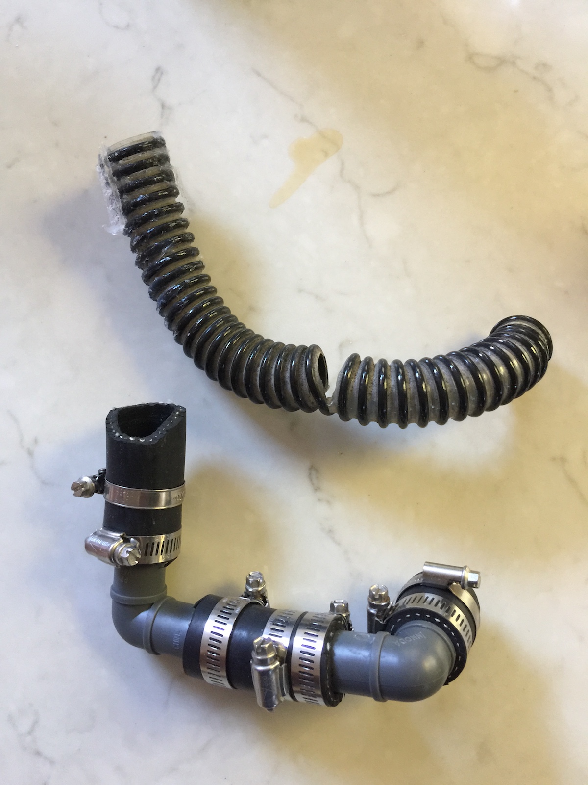

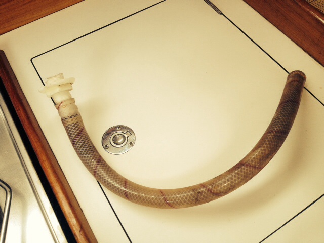

I thought I'd Share my experiences with the dreaded anchor locker drain hose in our '96 Mk II.  We noticed in the spring of 2018 that the forward compartment ahead of the forward water tank was filling with water and in our case I don't believe it drained out from there but instead just accumulated.  The culprit was a crack in the forward side of the anchor locker drain hose that, whenever underway, had water spraying forward into the inside V of the bow then running down into the compartment below.  In the photo the crack is on the far side of the hose.
I wanted to replace the hose with something sturdier as it was thin-walled bilge hose with black reinforcing.  The good news is that with the very thin walls it can have a tight bend radius which is needed for the small space which connects the fitting in the bottom of the anchor locker and the through hull.  The bad news is that it is not at all sturdy for below the waterline applications, and as you will see from the photo below, when I removed it it had become so brittle that it cracked in half.
I tried several hoses of 1" ID to see if I could get a sturdier one with the necessary bend radius to make the two connections work but no luck.  The connection space is too tight, and the angles required to accommodate the fittings were not friendly.  I made a rough sketch to get my head around the angles involved.  It's not accurate but it gives an idea of the problem.    I also tried to frankenstein a hose made of 90 degree elbows but it was too stiff and still couldn't meet the odd angles required to connect to each fitting square-on. Note the old brittle hose.  In the end I resigned myself to a semi-frankenstein arrangement: one 90 degree elbow to take some of the strain off of the hose for one bend, some underwater rated rubber hose for a short run to grab the through hull from the elbow, and a length of new bilge hose of the same type that was there in the first place.  I used sealant on all of the joints before applying the hose clamps as that was how I found the original hose had been connected (and I removed all old sealant from the fittings before applying the new hose).
In another thread (https://www.catalina36.org/forum/technical-discussion/anchor-locker-drai...)  and above, people have mentioned that the through hull appears to be plastic and should be replaced.  I considererd doing this but basically ran out of time.  I did notice, though, that the amount of threads that were visible sticking through the locking nut on the through hull looked like the fitting had been significantly cut down in size in the past, possibly to fit installing it the tight space in the bow.  This was also a reason that I designed the new hose to be able to atach to these threads as securely as possible with minimal strress that would push it from being on-centre.  Maybe in another year I will replace the through hull, but for now after a 10 hour passage the entire arrangement is bone dry.
One final note: when you remove the kick panel in the front of the V berth, the only connection you can see is the one on the anchor locker.  The through hull can be seen with a camera or a mirror but you can't get your head in there.  This makes for a tricky repair needing patience and some luck as you willl be working by feel one-handed.  I also tied thin line to my tools and the hose as there is essentially no way to get at them if they fall into the forward compartment.  It may have been easier if I had cut away some of the fibreglass but I didn't want to go to that bother since it was possible to repair without it.
Good luck!
