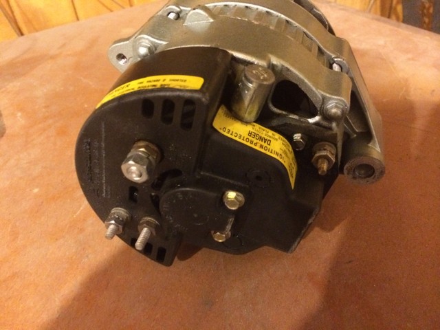

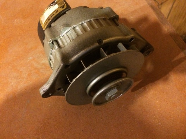

I have an alternator that was original on my 1993 M35A.
I'll send you some pictures.
