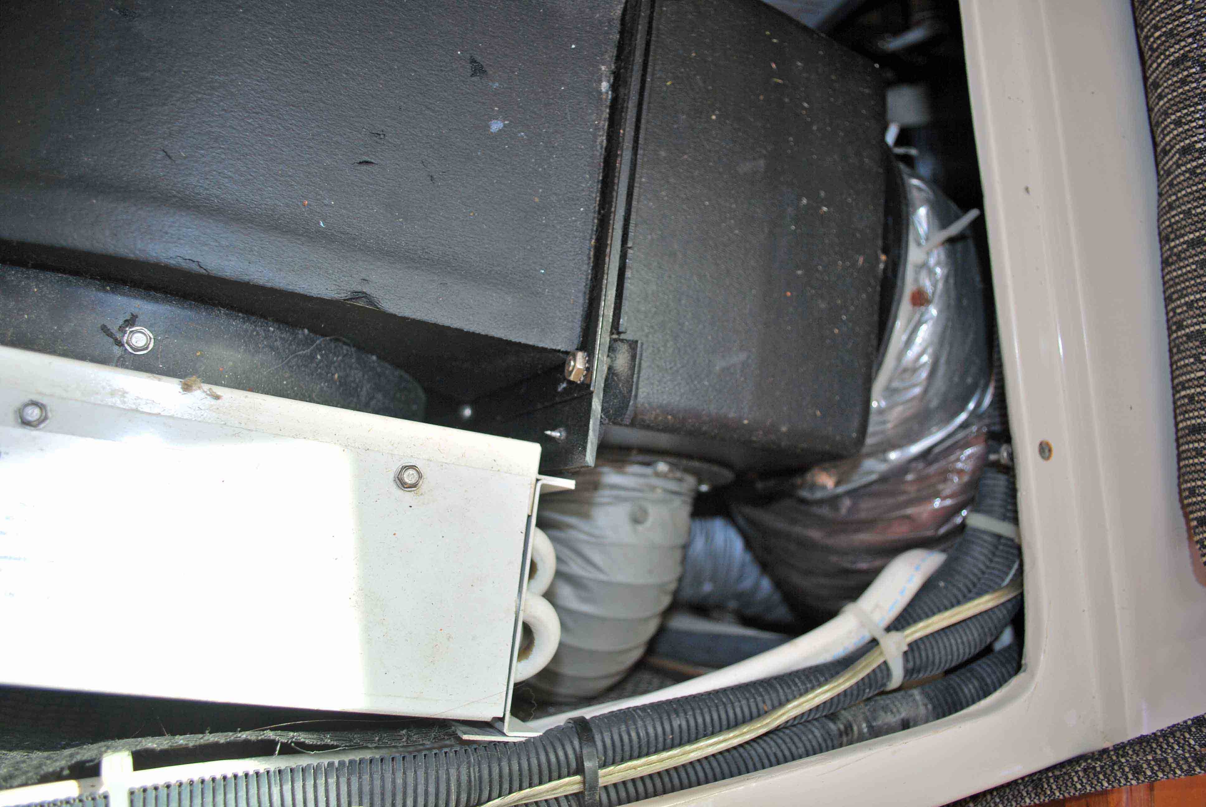

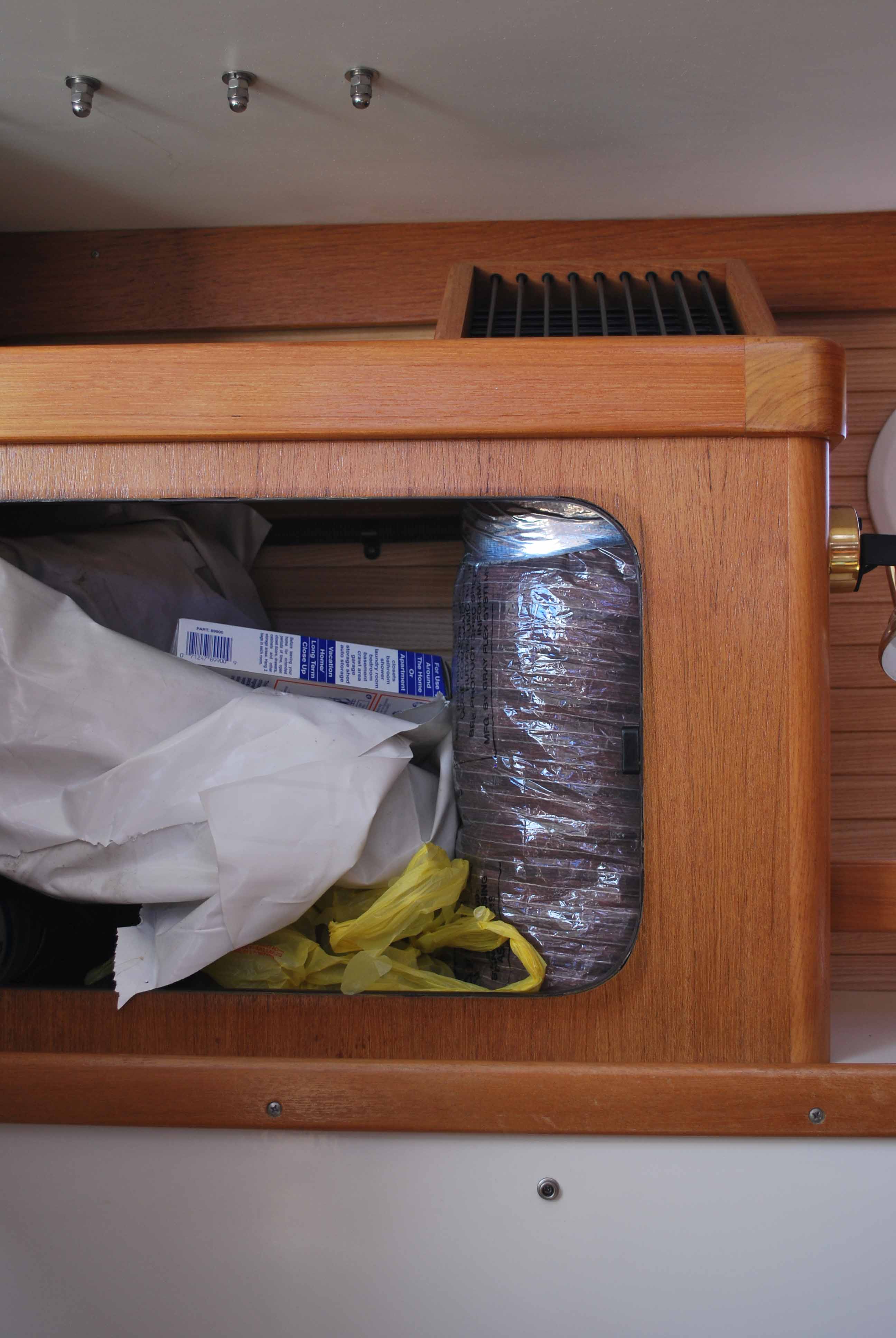

Neil... don't know if you still want pics, but here they are. This [I] for a MK II BTW.
in loading the pics I got them out of order. The 2nd shows the A/C unit looking down and aft at it. You'll notice the large hose coming off the rectangular shaped black box (that's the manifold or distribution box) .
The large hose carries air up to the main cabin air vent just to the right (again looking aft) of the whole unit on the port side of the boat (pic 1).
There are 2 smaller grey hoses (hard to see) coming off the manifold. The easier one to see runs aft for the aft cabin. The other is on the forward side of the manifold and makes a sharp turn to the right (looking aft). It then runs up and thru the storage opening above the holding tank (pic 3) , thru the bulhead into the locker above the toilet, thru the medicine cabinet and thru the bulkhead into the Vee berth (picc 4). There is a vent head in the port bulkhead up high on thre bulkhead (cold air drops so this is sufficient for the berth).
